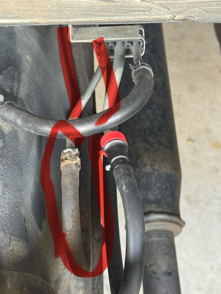

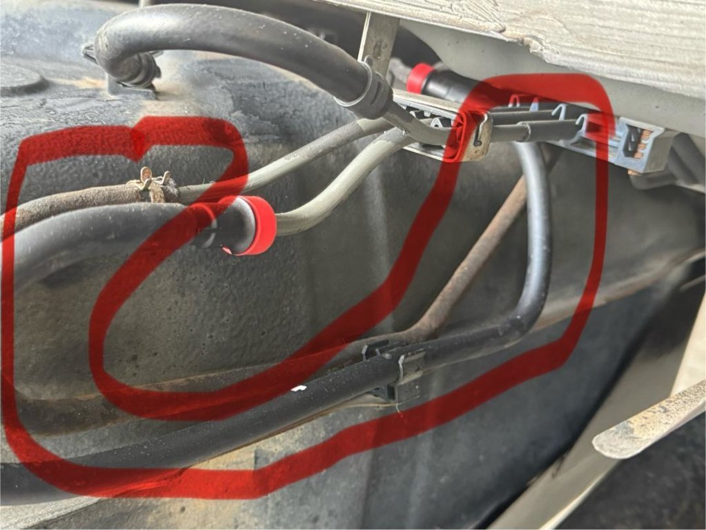

    Here’s some pics of the fuel hose I’m referring to-

    That's fuel return line....
    are you talking about the rubber part connecting to the tank......or the metal tubing going all the way to the front of the truck

    The rubber hose.

    Buy Gates green spool Barricade Fuel Injection Line Hose because it has better resistance against fuel blends and call it good. Don’t use vacuum or non-fuel hose and you’ll be fine.

    Agreed... if you are in CA you definitly need the Fuel injection hose, the addatives in CA spec gas turn regular fuel line to goo in a few years. Give yourself enough length to keep from kinking the hose.
