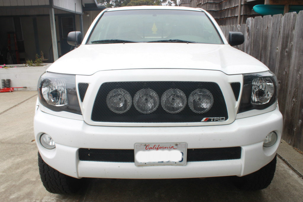

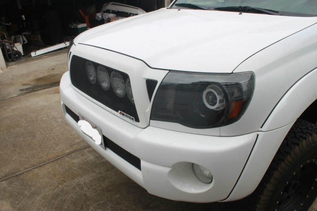

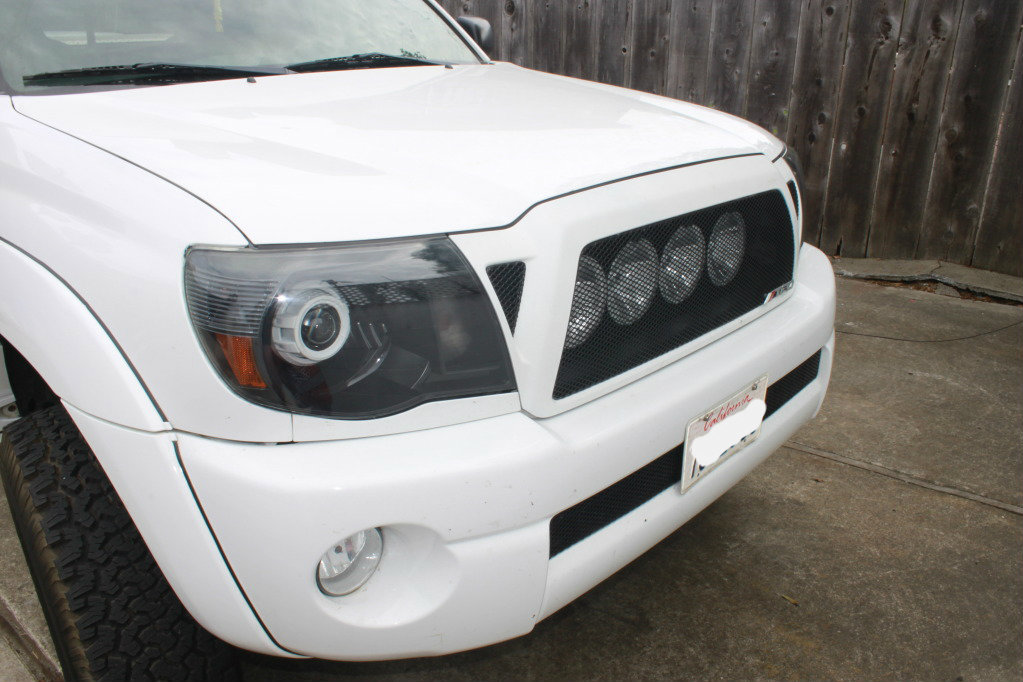

    #16
    CayucosTacoma
    CayucosTacoma Just think outside the Yota
    Mar 9, 2012
    #74580
    5,239
    San Luis Obispo/Santa Barbara CA
    1998 Tacoma, 4x4 5 Speed, V6
    Specs in the Build Thread
  17. Oct 27, 2012 at 10:13 AM
    #17
    Ericc12Taco
    Ericc12Taco [OP] Active Member
    Oct 16, 2012
    #89157
    31
    Eric
    New Hamshire
    2012 Trd Sport
    Dude that looks sick came out good.
  18. Oct 27, 2012 at 10:15 AM
    #18
    CayucosTacoma
    Mar 9, 2012
    #74580
    5,239
    thanks man! thats also the lower grillcraft insert too.
