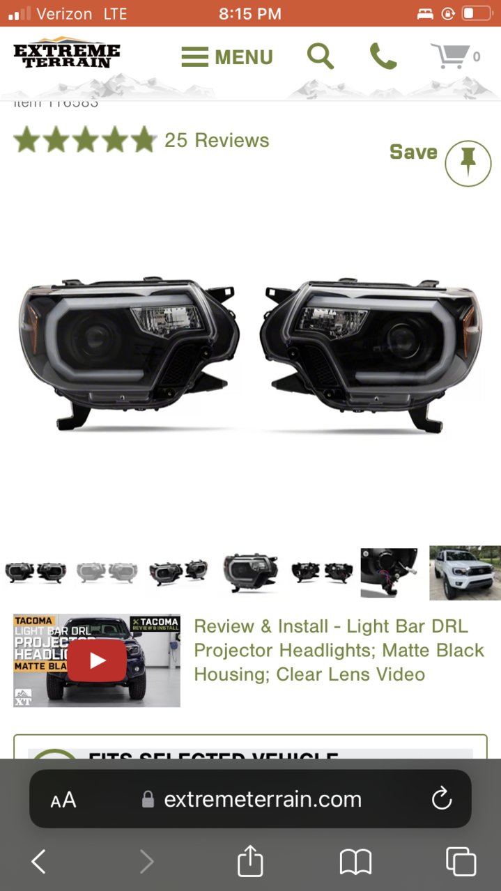

    E0D9EE9B-DBEA-400B-A7A0-E12A76C18D0F.jpg Hey,
    I am planning on buying these headlights for my 2013 Tacoma.
    However these new headlights take h9 halogen bulbs (included in package) but I want to get some high quality leds to drop in.
    My question is do I now look for h9 bulbs instead of my former h4’s? And will any h9 led’s fit?
    I have been considering diode dynamics, Tacomabeast color changers, and lasfit. All seem to call their h9’s “fog lights” and I want to make sure I get proper headlights with high/low beams.
    Any insight appreciated!!!

    I prefer the look of the aftermarket headlights, and have seen lots of setups with projector housings with leds that were substantial upgrades over stock. Thanks for the feedback though.

    LED bulbs don't work in headlights designed for halogen. Light pattern will be bad and dangerously affect oncoming drivers.

    I hate to be that guy, but I owned these exact headlights, for well over a year, and I dropped in LEDs. They sucked. Period. No way around it. If you're going for looks, these are definitely slick headlights, but if you're trying to improve light output, just do the ultimate headlight harness mod.
    Even though this is heavily discouraged, your stock headlights with LED drop in bulbs provide far better light output then these aftermarket ones with LED's in them.
    Also I'm not a lighting expert, and I'm sure some will chime in on this thread. Projector headlights can be an upgrade, but as has been stated on this forum many times is that Spyder (who is the actual maker of those headlights) use very poor quality projectors, leaving a lot to be desired.

    Oh okay, thanks for the feedback. I didn’t know that spyder was poor quality, is there a better brand out there?
    I’ve considered doing leds in stocks but I know that’s frowned upon, that’s why I was looking for a good projector headlight.

    If you're considering aftermarket housings. The only brands I would entertain are Morimoto and Alpharexx. I've heard mixed things about Alpharexx, specifically that their customer service was bad, but I would take that with a grain of salt. Morimoto makes good products also, but can be costly from what I have seen.
    The other option that you could investigate if you're willing to spend the money are retrofits. This is the best route to go for projector housings, as retrofit housings usually contain higher quality projectors which will give good light output. I can't comment on this given that I don't have a set, but there are quite a few members here that do - hopefully one of them may chime in and give better input. I haven't seen anyone unhappy with retrofits, they're usually an improvement over OEM from what I hear, but I personally haven't seen any factual evidence to show that's the case (keep in mind I never really looked for any comparisons of the two.)
    There is a user on here: @crashnburn80 who has made educational writeups on lighting, and if you want factual evidence and to educate yourself on the rabbit hole that is Tacoma lighting, I would investigate the threads he has written on this forum. His threads are what led me to ditch my spyder housings and reinstall OEM with an upgraded harness and high power bulbs, and I couldn't be happier.

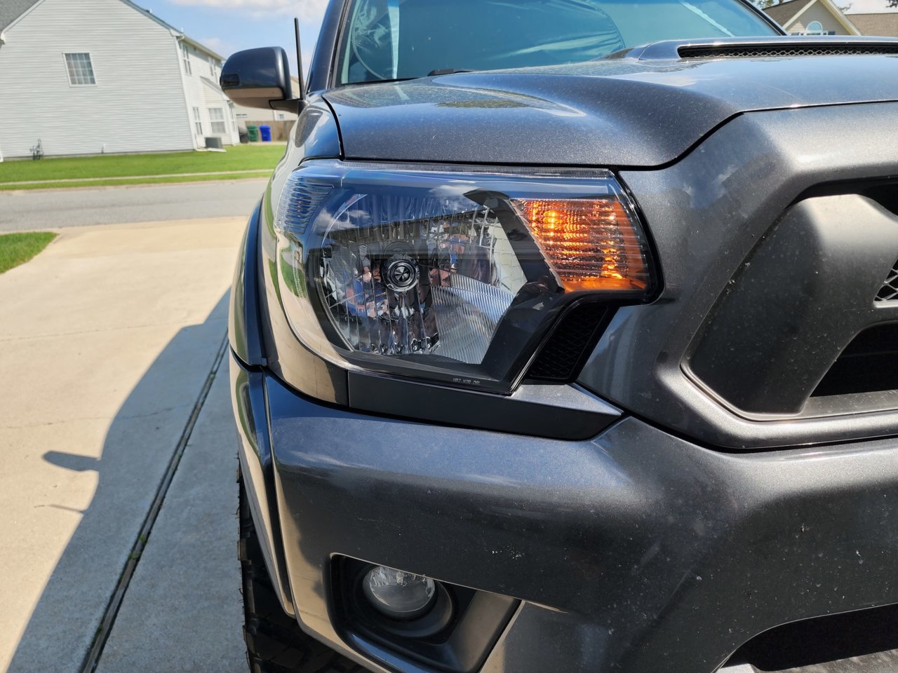

    OME

    Are those headlights just smoked or black OEM style? Thanks for the suggestions!
  12. Jun 28, 2022 at 1:18 PM
    mchabot1987
    mchabot1987 Well-Known Member
    Apr 2, 2021
    #361424
    303
    Elizabeth City, NC
    2017 Super White TRD Sport DCLB
    Yes
    They are black OEM style. Got them for $60 on offerup lol.
