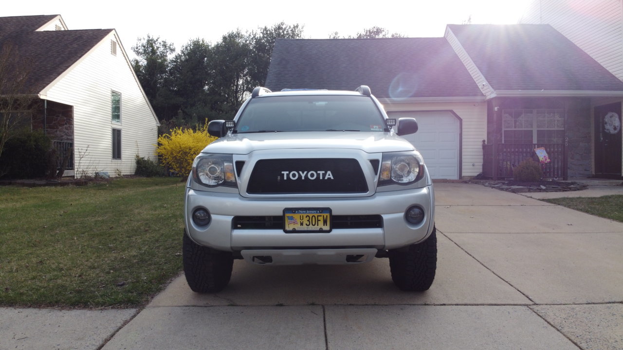

    i bought a cheap set off ebay and retrofitted morimoto mini h1s in them. perfect light!
