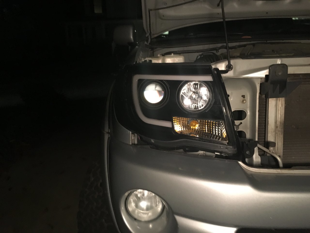

    I see the blinker reflector. I see the led bar. I see the projector. But what’s that reflector bowl in the center for?

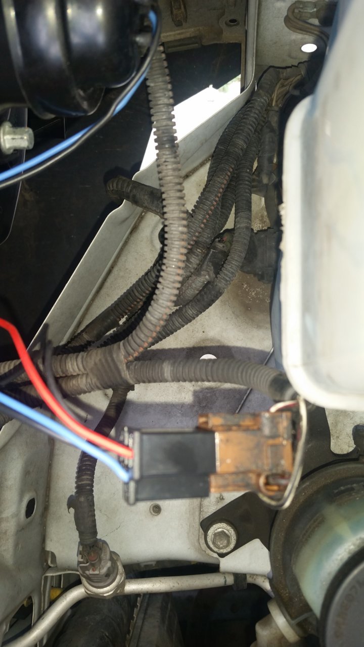

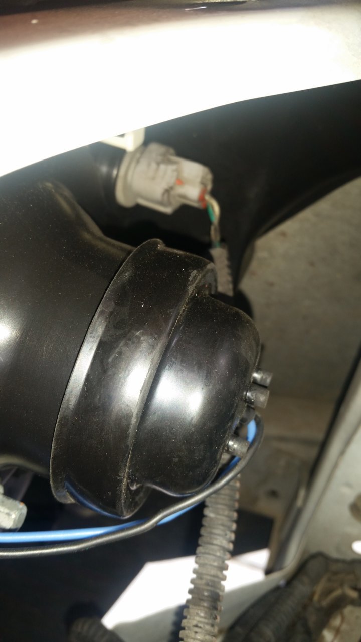

    Yes i did. I removed the bulb but still noting connects up to that dang piece. I feel like i an missing something. Is there any way you can post a picture of your headlight wire? That would be super helpful lol

    Plug for main headlights and DRL
    LED light bulb plugs into this receptacle (top of pic)and wires get pushed in then twist receptacle tight.

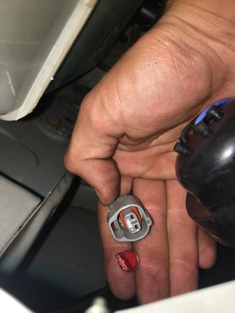

    That is definitely not the right receptacle to plug LED connector into. ...........You don't have a twist on receptacle on housing?

    The gray part that you unpluged that gray harness from needs to come out of your stock housing. Twist it a quarter turn counter-clockwise and then pull out. Plug the gray harness back into it and then pull the little bulb out of the other end. You should be left with a long gray plastic part that will have two contacts that that small red piece plugs into. It's not explained very well and it first when I installed mine I thought I had something wrong too but it works if you do it the way I described. It needs to come with better instructions and possibly diagrams to explain this part since it's not super intuitive.

    Unlike the stock housing these housings use one bulb for low beam and one bulb for high beam. The low beam bulb goes in the projector housing on the left in that photo and the housing on the right with the reflectors is for the high beam. It has dual H11 bulbs and turns the high beam one on or off. The factory housing just uses a single dual filament bulb that turns one of the filaments on or off.

    I still need to check adjustment, this might help you too

    That's what happened to me too. I unplugged that harness and stood looking at both with a stupid look on my face for what seemed like a half hour. Then it dawned on me what they were trying to do so I pulled the little amber bulb part and sure 'nuff... what I was left with plugged right into that red thingy and boom! Worked perfectly. They really do need to include some more detailed instructions about this part specifically though as it's not exactly "plug & play" from the traditional sense of the phrase.
