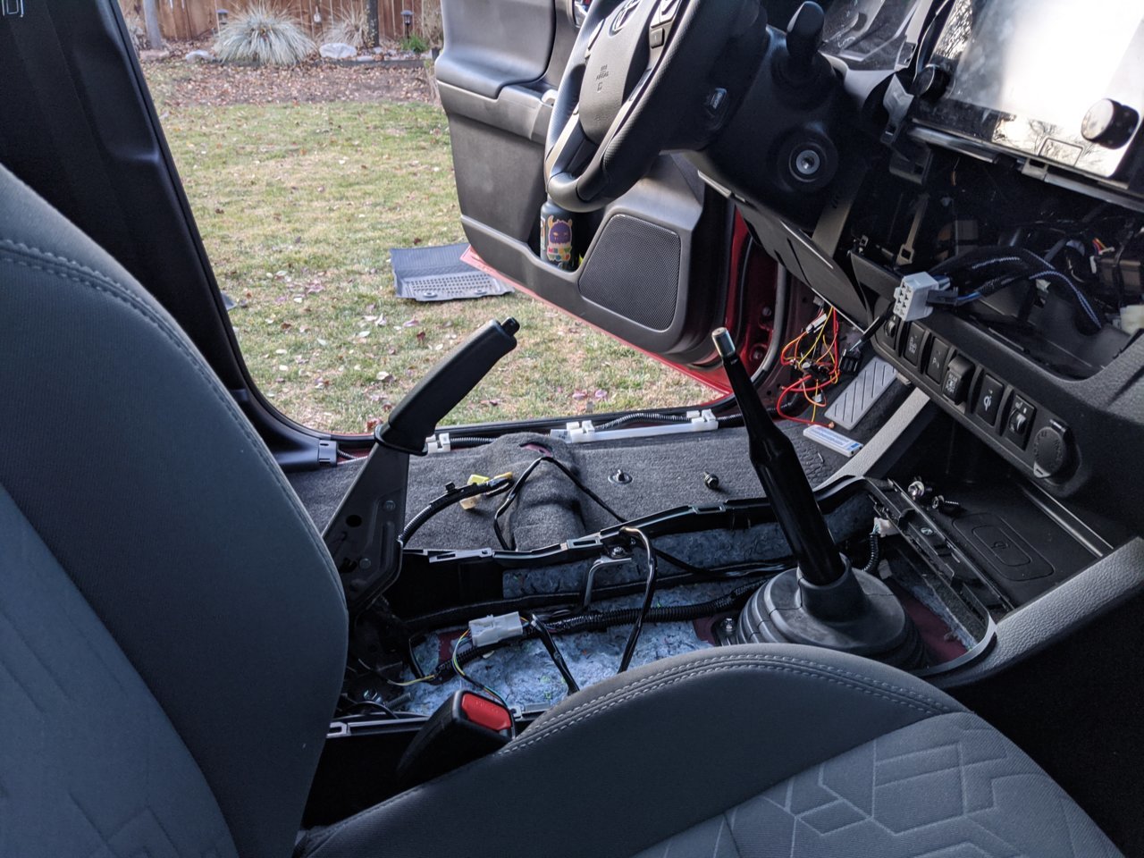

    I am putting in heated seat kit right now with these same switches and knew I ran across this pic several weeks ago. Wanted to make sure it is hollow before drilling and did not want to tear the whole center console apart to find out. Thanks.

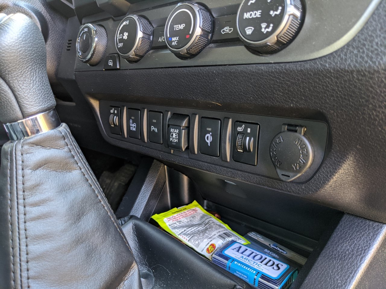

    Bilsteins 5100s on the top setting, 4runner Gray TRD Pro Sema wheels, 285/70/17 Toyo AT3s, Sumo Bump stops, TRD exhaust, ECGS Clamshell bushing, 1/4 shim for the lean and one inch rear block, OEM Pro grill and garnish OEM TRD Skid plate, TRD CAI, Demon Brackets, Rigid Industries Pro fog lights, OEM Trail Rails sidebars, Diode Dynamics LED SL1 high and low beam lights, OEM Roof racks, Clazzio leather heated seats, Remote Start, TRD Pro shift knob, tinted windows, Rockford Fosgate 4 channel amp for the headunit and sub and amp combo, OEM Puddle lights, OEM tailgate lock, OEM bed mat, LED interior lights, OEM blackout kit for letters, JLT catch can, upgraded 27F toyota True Start battery, Vleds led tail light kit with Pro tail lights, OEM Rave4 side mirrors with convex spotters,just to name a few mods.
    Not true my friend, have a look at how I did mine. Move the q charger and put Toyota style switches on each end. Worked out perfect. This pic was taken right after the install, I put a little interior shine spray and gave it a little gloss. IIMG_20190220_104258103.jpg IMG_20190219_215900261.jpg

    I bought the besond kit on Amazon with the "Toyota" style switches, i.e., the 4runner dial type switches. Because I have a 2019 TRDOR MT w/tech, I had one free switch blank in the lower dash panel. I never liked how the USB/AUX was there anyway, I prefer it in the center console or somewhere more hidden like in my past Subies, so I rerouted it to the center console. Bought a USB/aux extender cable on Amazon, drilled a hole in the center console for it, and then I had anoter free switch blank. Super happy with the setup so far, and it was pretty easy installing everything. Heres a pic: IMG_20191109_122259.jpg IMG_20191111_171015.jpg

    Looks excellent. Great job.
