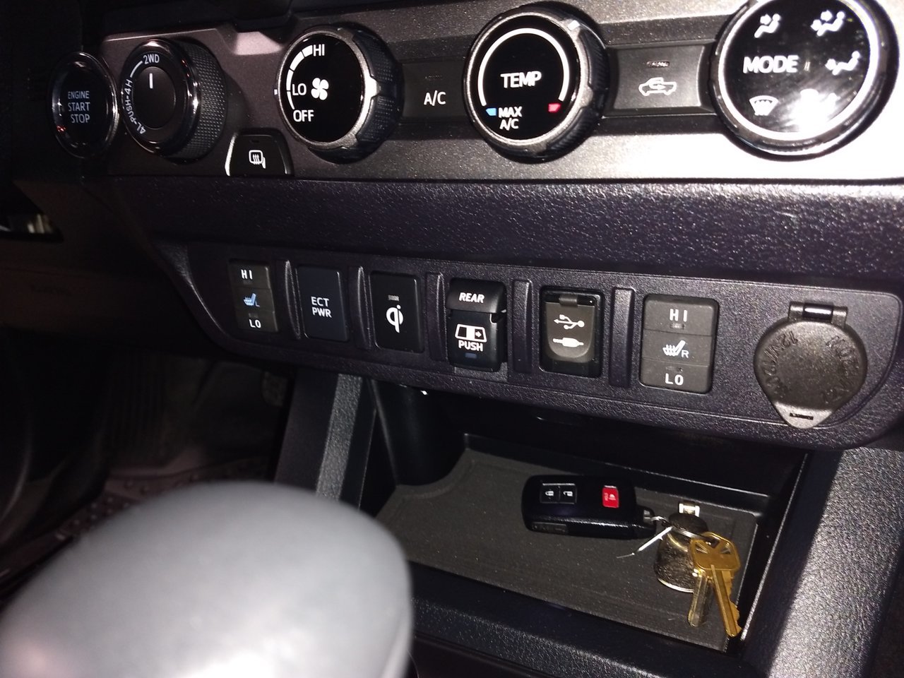

    I'm installing mine in a week. Instead of buying a new Part# 55434-04070-CO Panel, I'm going to eliminate the wireless charging pad button, and use the empty slot next to it for the two slots that I need. The wireless charger sucks and a lot of people have overheating issues with it anyway.

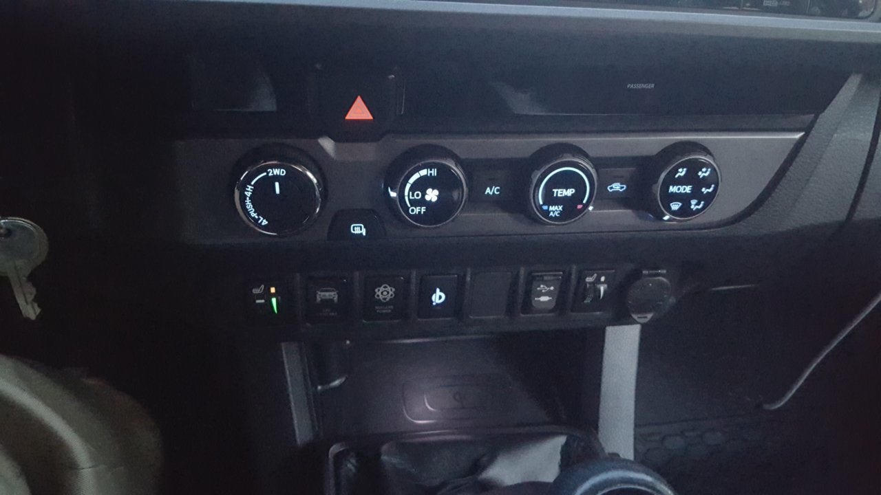

    I have the round switches as shown in several of the responses. Would it be possible to drill a hole in the blanks in the 6-bank panel and feed the switch with short pigtail in from the front without taking the center console out and dash apart? It might not look the greatest having a round switch mounted in the rectangle blank cover, but if I ever needed to I could just purchase new blanks and there would be no permanent holes anywhere.
  4. Nov 26, 2019 at 4:35 PM
    #44
    DOSS
    DOSS Well-Known Member
    Oct 1, 2015
    #165555
    197
    Scott
    Utah
    2016 Black Tacoma TRD Sport DBCB
    Thats where I put mine :)

    From @MESO , now just need the larger fuse box cover to become available

    When I attempted mine I couldn't get the seats unplugged from the factory harness. It felt like I was going to break the plugs

    i have a 2016, with the limited bottom panel. i am looking to do what you did, mind sharing a link on the knobs? also, are they mulitple setting or just on off?

    Did you take apart the dash for this? Or were you able to just drill the slots and feed the wires to it?
  10. Feb 15, 2020 at 2:51 PM
    #50
    Lawfarin
    Lawfarin Who me?
    Oct 25, 2015
    #167659
    7,954
    Beetle Juice
    NY
    2024 GMC Sierra
    I took out the seats, the console and lower parts of the dashboard. You may be able to drill and fish the wiring, I wanted to secure the wiring and do a clean install.

    I really like that set up. I have other switches installed on the front panel (USB for camera & per for radar detector) so those switches in those locations are perfect. Nice job.
