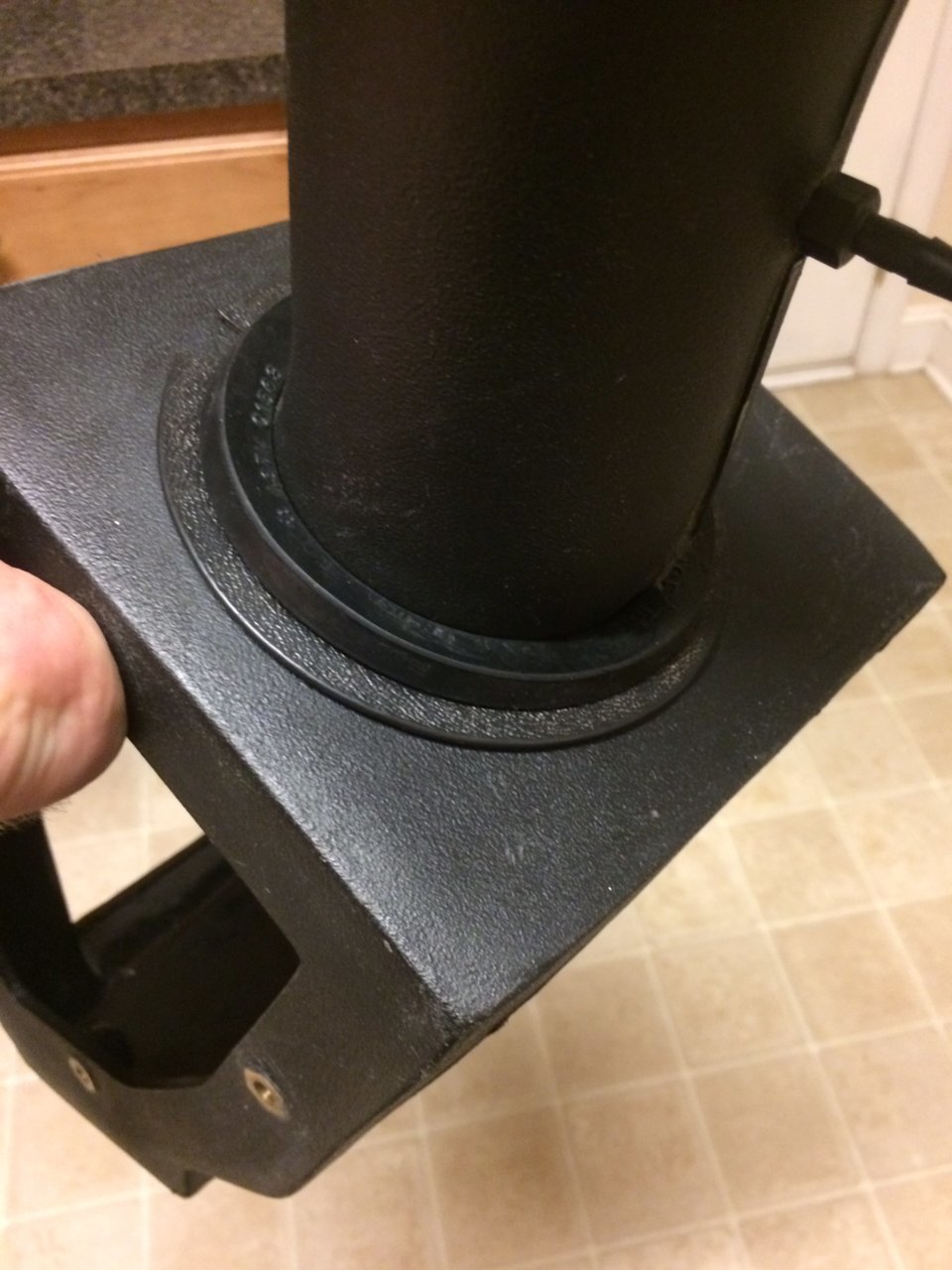

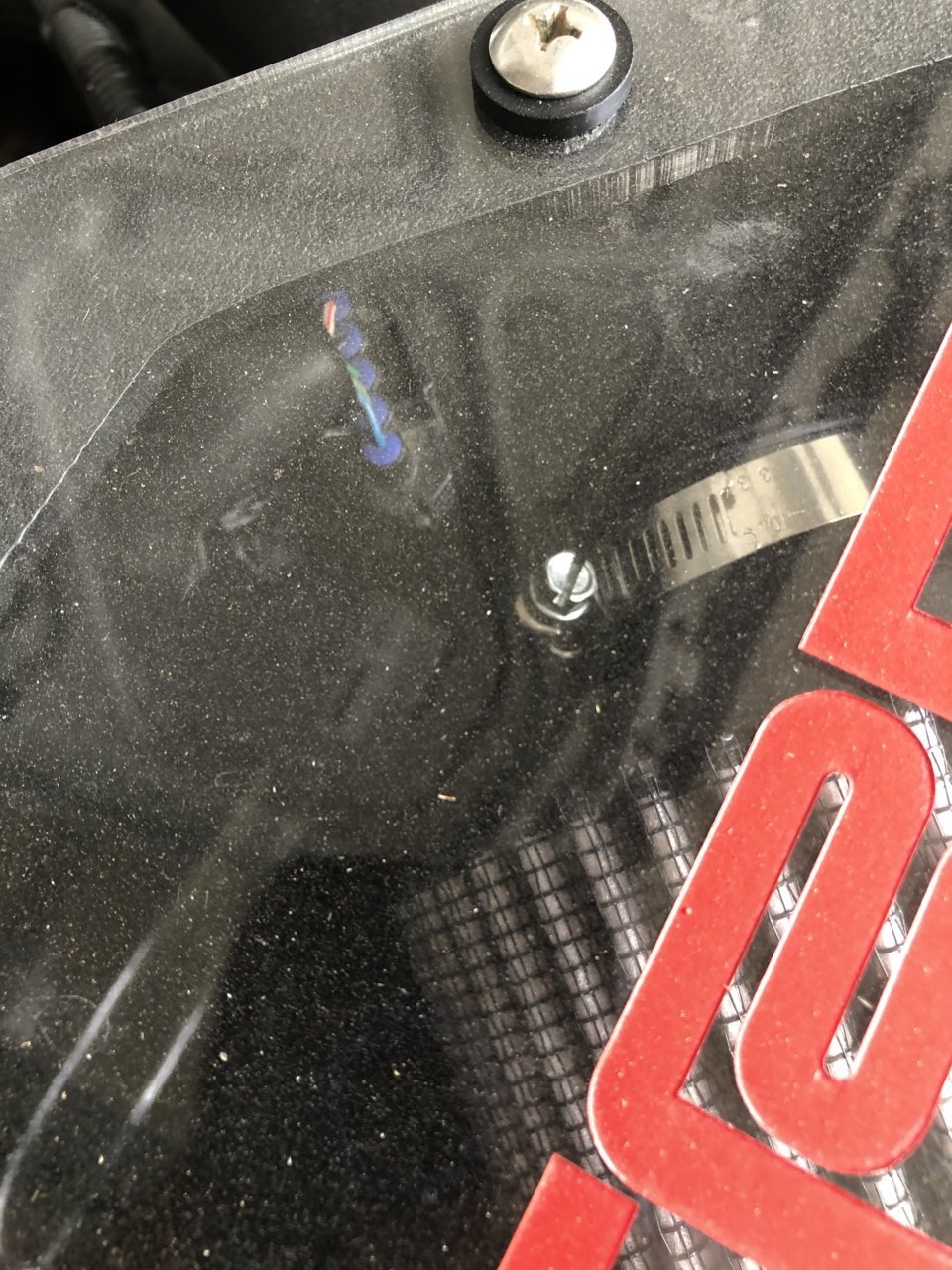

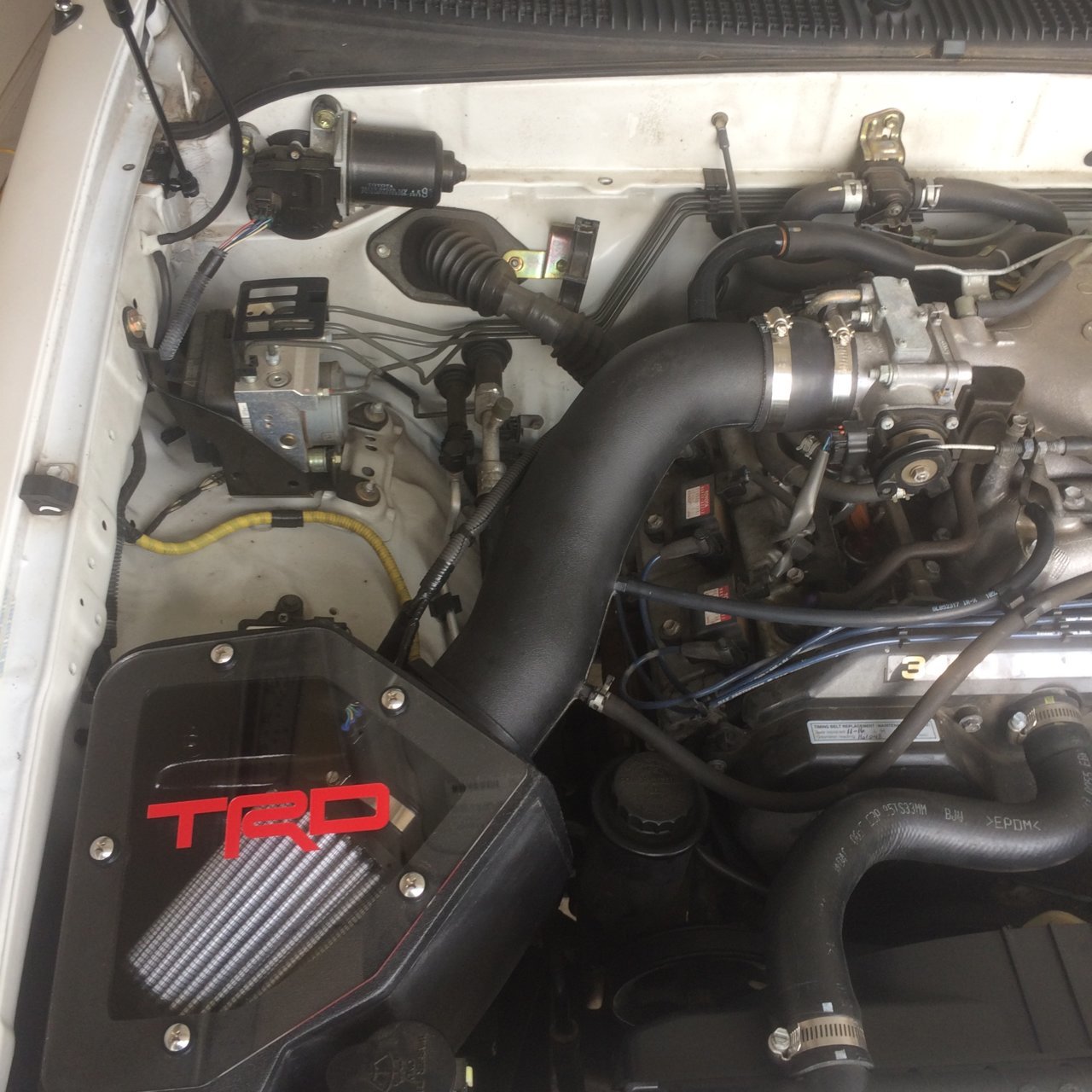

    Does the box come with the air tube to the throttle body?
    I can’t see the MAF, is it in the box. Area?

    Yes, the box came with the air tube to the throttle body. The MAF is just inside the box on the air tube:

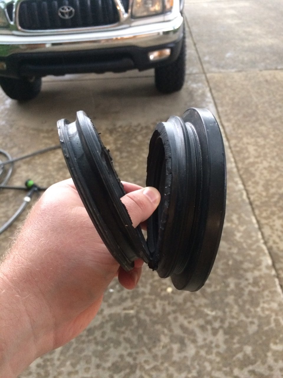

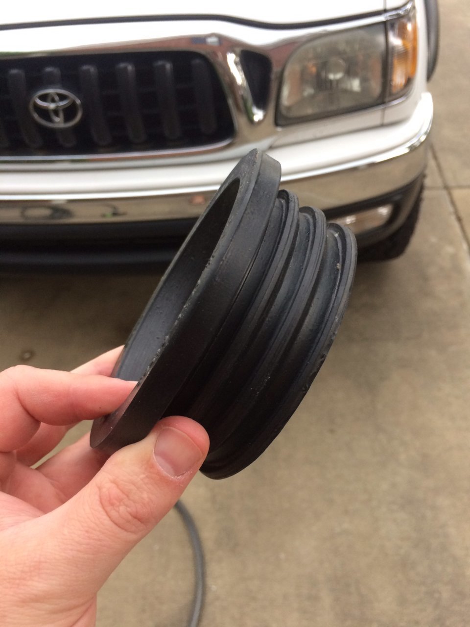

    How well does the box seal to the elbow in the fender? Does it just kinda sit around it or does it legitimately seal?

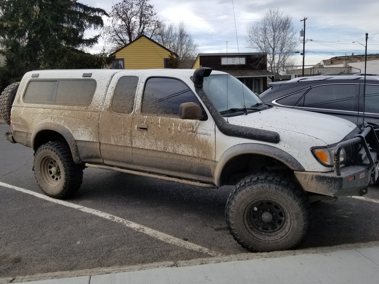

    I kept the stock system except, added a snorkel. Rarely clean my filter anymore AND it's like a forced cold air induction system.
    Never been an issue.

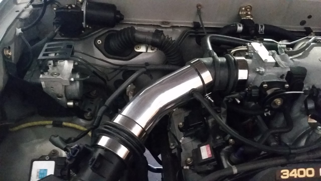

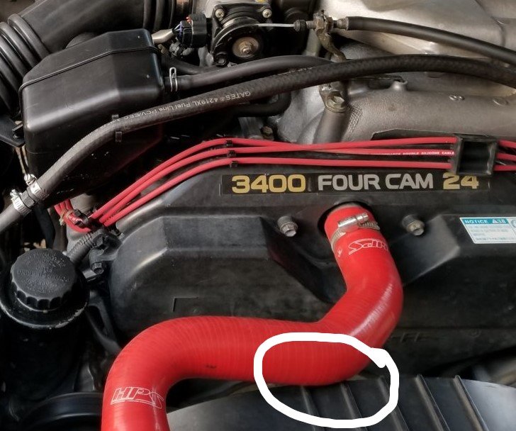

    This hose is on backwards and can develop a leak from rubbing. Not sure if it's yours or not.

    It doesn’t seal, so I bought a piece from a plumbing store and sealed it myself:

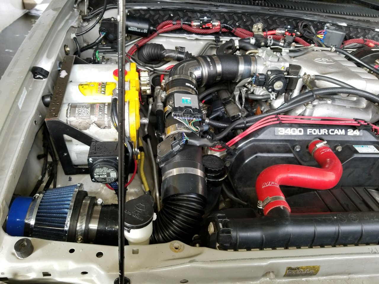

    I have a 3.4 with supercharger. I also installed a shock hoop with needed crossmember where factory air box would route to the front. Any solid advise on a short or possible intake that i could make with a canister filter housing, run to the fender by firewall and still run correctly?

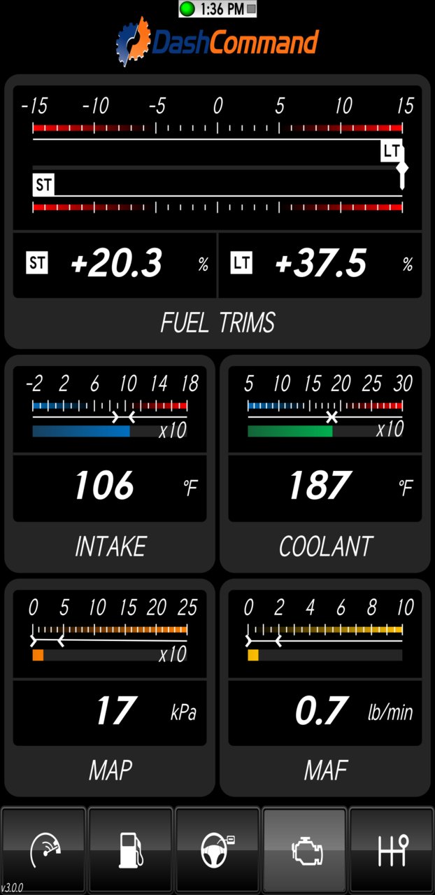

    I have an air raid system with KN filter but my fuel trims are almost identical to your "fixed" trims on the bottom. Are you sure the aftermarket kit was working correctly? That was an extremely lean condition if it's adding 20 and 35% fuel respectively. Two other questions. First, that MAF reading of 4g/second is at idle correct? Second, 68 degrees on the intake temp, what was the ambient temp? Was the first temp of 106 on a hotter day or are we saying that the stock Toyota air box delivers cooler air? I've noticed when my truck is just sitting idling with no airflow my intake temps will get up to like 135-150. Driving 80 down the freeway my intake temp is exactly the ambient temp at that moment. Yesterday that was 115!!!!
