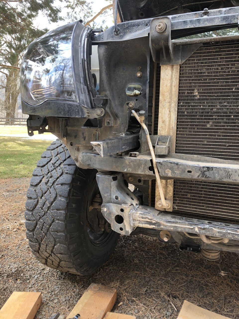

    Yes it is possible but I don’t recommend it unless your stuck in your shop with a whole pack of sawzall blades and a welder because of a world wide pandemic
    Smitty built carbine bumper I got for 200 bucks. Lots of cutting on bumper and frame. Moving of cross members and fabing of brackets.
    front cross chopped and moved up, radiator support notched and opened up for frame attached support mounted in engine bay.
    Bumper support that mounts on frame rail inside engine bay and sticks out through radiator support.
    Shit got complicated pretty quick.

    Just curious why you did not stretch the bumper out wider like a regular Tacoma Bumper?
    Time constraints or lack of material ?/

    It’s not quite done yet. Working on making sure it doesn’t fall off was the most important thing. I will probably extend the sides when I get a chance. Was thinking of using aluminum. It’s gonna take a lot of sitting and staring and thinking
