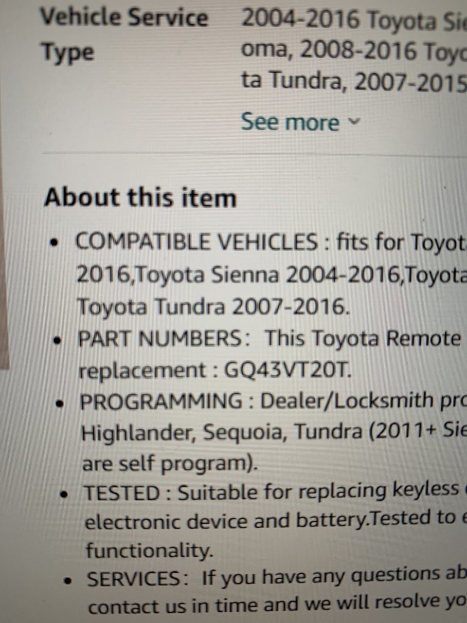

    Did you see the number on the one you bought "GQ43VT20T". This is the FCC ID Number and MUST Match the receiver for your truck.
    FCC ID # on my 2012 Prerunner Access Cab and 2010 Highlander are both GQ43VT20T.

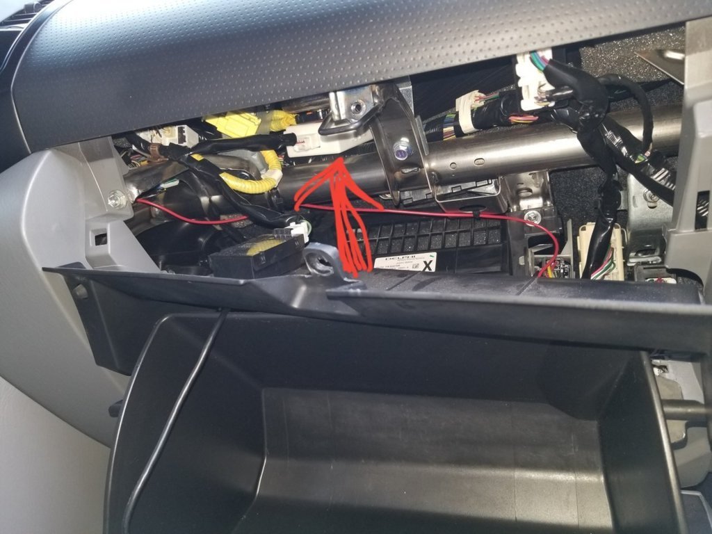

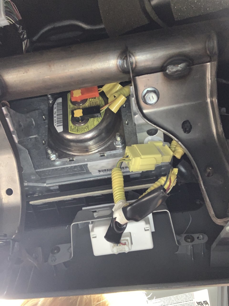

    Look in the thread I posted, the keyless entry module (if equipped) is behind the glovebox.

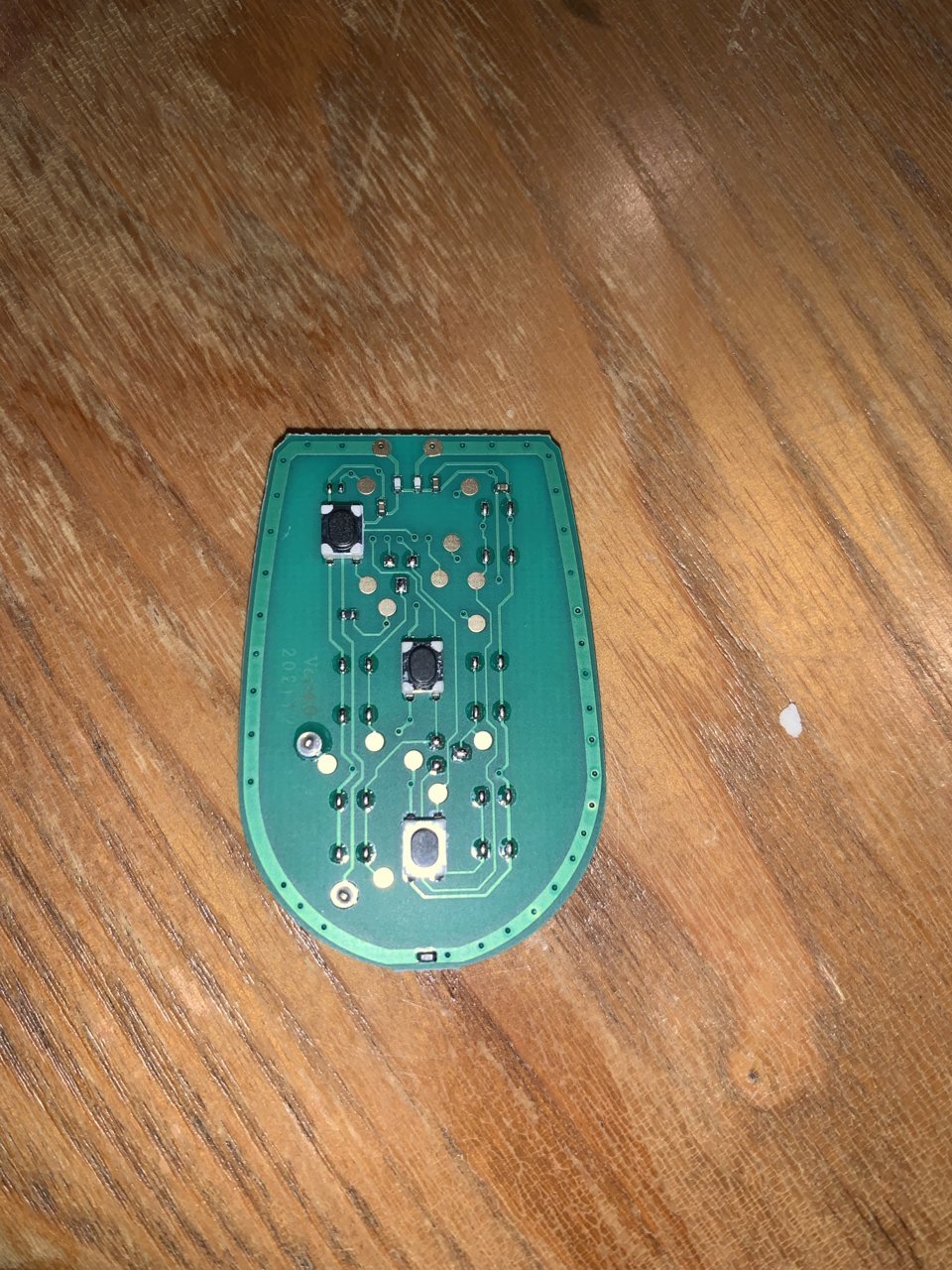

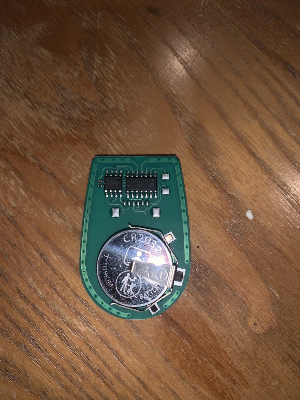

    @Dm93 Oh great thank you so much for the image. I believe I saw the module when I replaced my air filter for the interior blower but I’ll check again and get back to you.

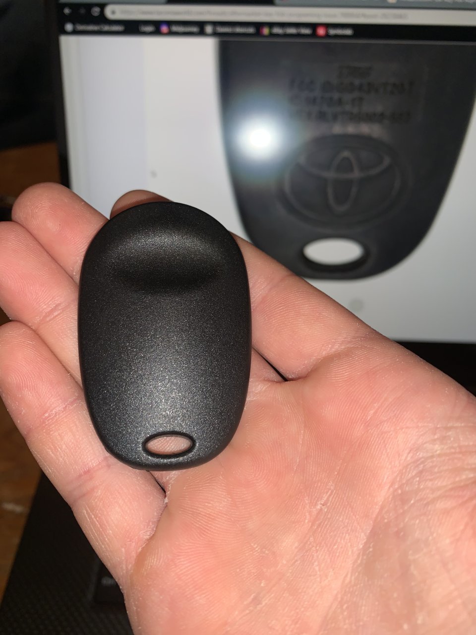

    FCC ID # would be here:
    Budbudbuilds[OP] likes this.

    I just found in on the product description I should’ve checked it more thoroughly first.

    @Dm93 I finally got around to taking my panel off behind my glove box and I was able to find a keyless entry module
