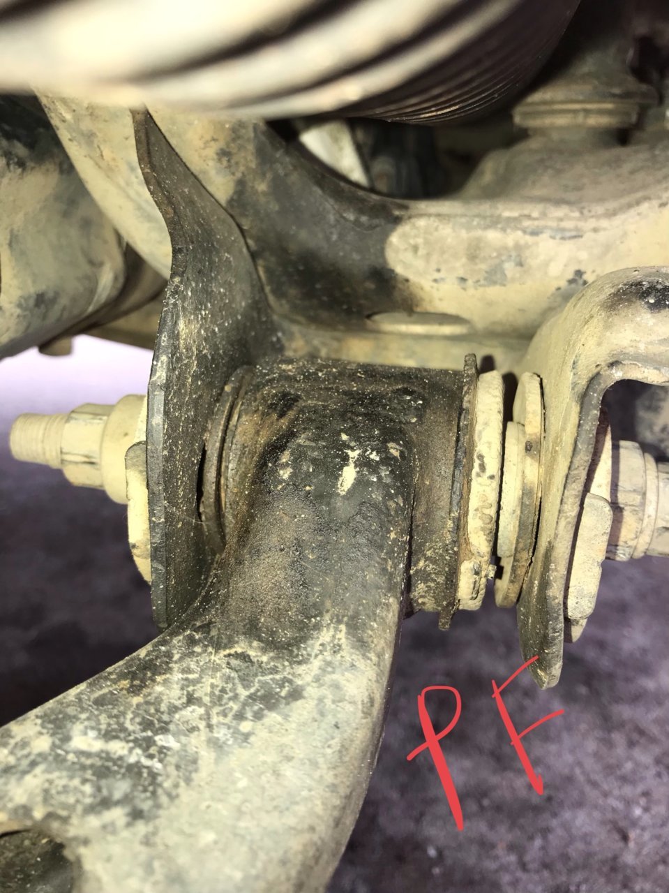

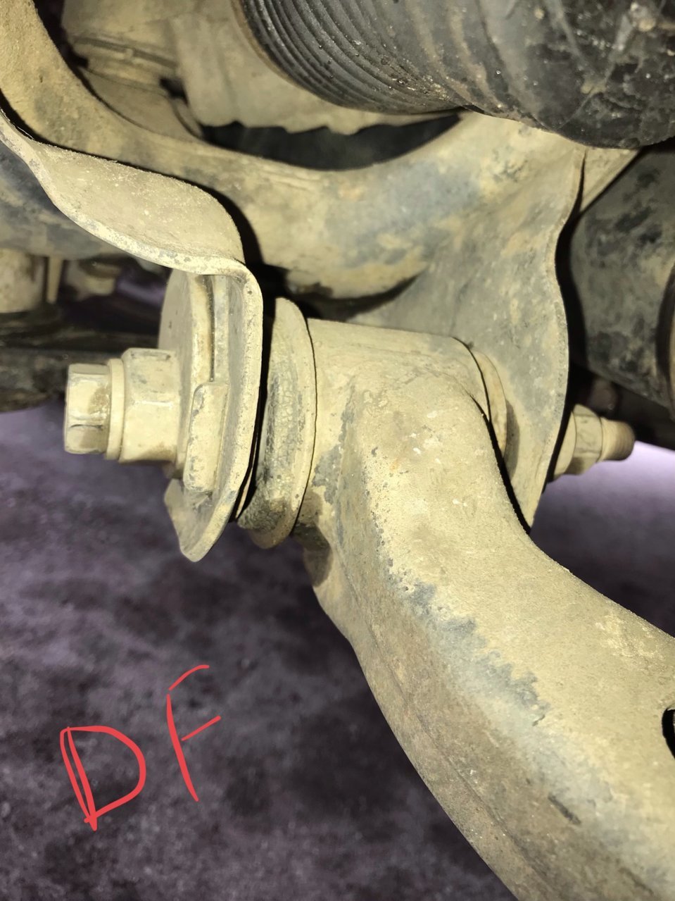

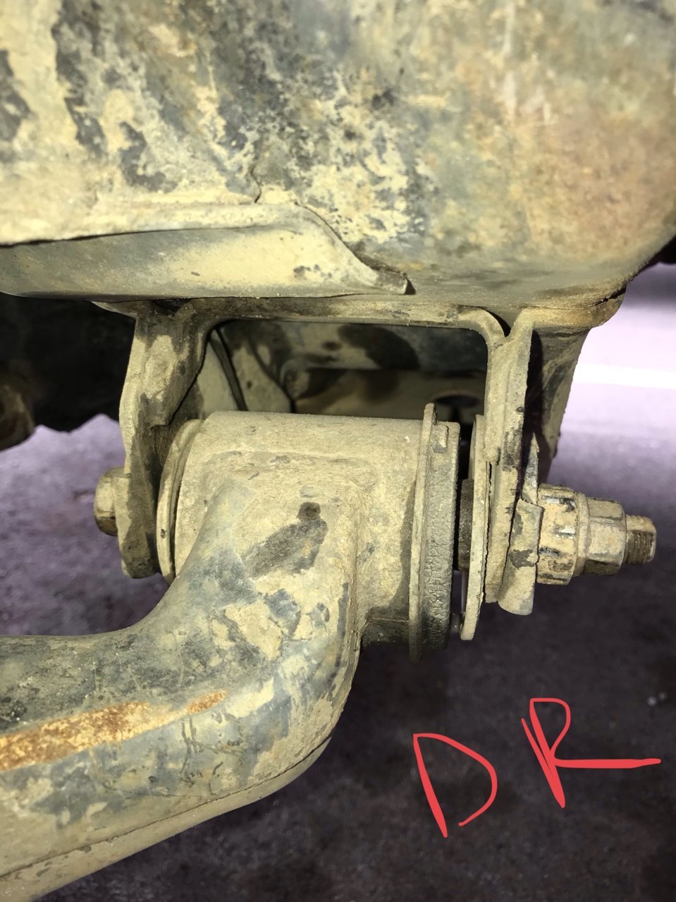

    Below are pictures of my bushings respectively labeled.. Thoughts?

    I can’t tell my looking at them, you should try an put the front on jack stands an try to wiggle the lcas with a prybar is there if a lot of play I would replace them. Insert prybar between the crossmember an lca not to damage the bushing.

    Jam a pry bar in there and try to move them.

    UPDATE: Installed the MOOG LCAs today. Only had 1 seized bolt and a sawzall took care of it. So far, no more clunking or shifting. I plan to go get an alignment tomorrow.
    Thank you guys for the help!
    Oh yeah, I ended up wrapping my phone tripod around my front bumper and recorded the LCA while stopping and going.. the shift in the LCA at the bushing was very clear. ha
