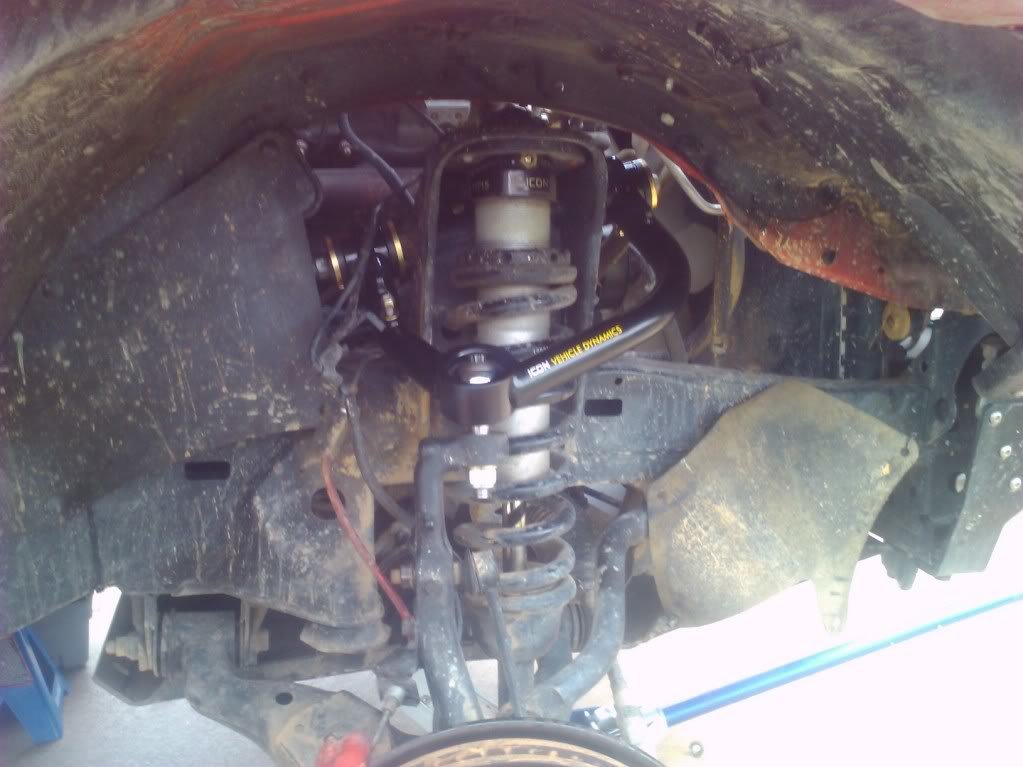

    I would like to go for more travel. Just not sure I can justify $1600 for the TC's..

    Doesn't the TC uniball allow for more articulation? Thats the main thing I'm looking for. I over extended mine and now I need to replace the bj in upper and lowers. I heard that the bj were a problem with a 6in lift.

    Ultimately I'm looking for a setup for max travel with a 6in db with 6-9in radflo coilovers. I didn't wasn't to keep running into bj problems by running a stock lca. But if I can get away with the stock ones that would be great.

    :eek: You're ok with this?! Looks like a mismatched coilover to me.
    What part # Icon coilovers are they?

    Its already lifted. Bought it with the fabtech 6in basic lift with the strut spacer and stocks uca's. Going to replace the uca with the TC and the spacer with 6-9in radflos

    :confused: I can't tell if you are serious, but I'll definitely cross Icon off my list if their extended coilovers allow for too much droop.

    Why would you buy extended coilovers if you didn't want the extended droop?!?! Just buy the standard travel versions and be done with it if it's a concern.

    I would buy extended coilovers with the correct extended length so the UCA wouldn't hit the spring.
    Judging by your picture, the Icons are too long. I can't imagine they want your spring to limit droop... If they did, I personally wouldn't consider them.

    my Icon extended coilovers dont hit the coil at full droop

    you don't have full droop
