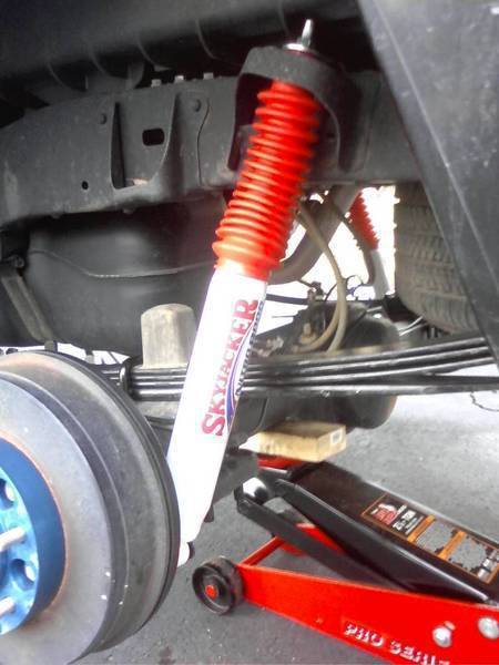

  7. Apr 6, 2010 at 7:00 AM
    Dark Knight
    Dark Knight Well-Known Member
    Jul 18, 2008
    #8006
    9,803
    Jeff
    NC/SC
    4Runner Trail, 88 pickup, Tundra Platinum
    A few bolts are different.
    side view of leaf.
