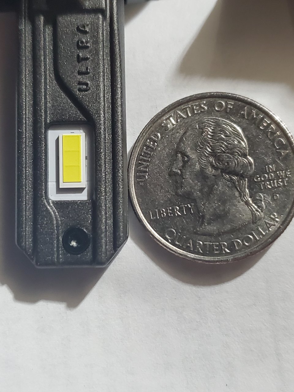

    Have you been able to test the gtr ultra 2 yet or read anything about them?

    Welcome! I have not yet tested the GTR Ultra 2. Headlight Revolution makes a lot of marketing claims that I would call, well, marketing. Promoting things like more adjustability! is actually a bad thing, not a good one. And claiming things like optimizing the position of the LED for perfect alignment doesn't work if the design is adjustable. It is difficult to tell for certain in photos, but the emitters look a bit large, which will result in lack of focus, meaning more foreground light and less distance projection which is not a good thing. Typically that may be done to build a brighter light, but brighter with less distance projection isn't a good thing. You want small emitters for a more focused light, which will have better concentrated intensity and project light further and have a better light pattern distribution. You also want the distance between the emitter faces to be as small as possible for the same focus reasons, the photos make it difficult to determine how far apart they are. It would be interesting to measure with a digital caliper. The best I've tested are the H11 Hikari Ultras.

    Dont know if this helps any

    Would help if the quarters were the same to use markings for reference.
    The GTR emitters look like they are offset from the plate more, which isn’t good for focus, though the critical measurement is distance between the emitter faces.
