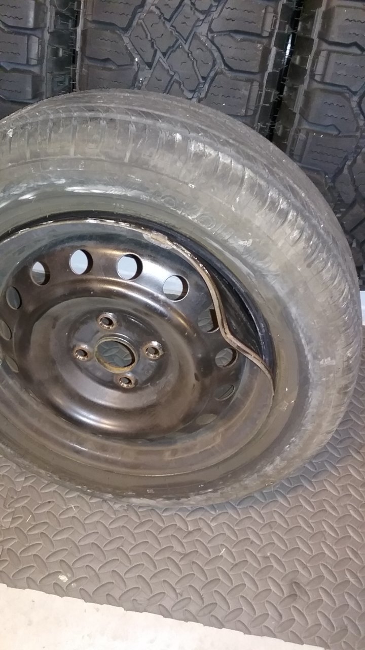

    But curb hopping is exactly why I replaced the LCAs. Figured if I was going to do one...I might as well do both sides as the car was/is rather old with a ton of miles.
    This was the reason for the replacement.

    That poor wheel hahahaha

    She was 17 at the time. Misjudged a curb during a turn and ate a 7" curb.

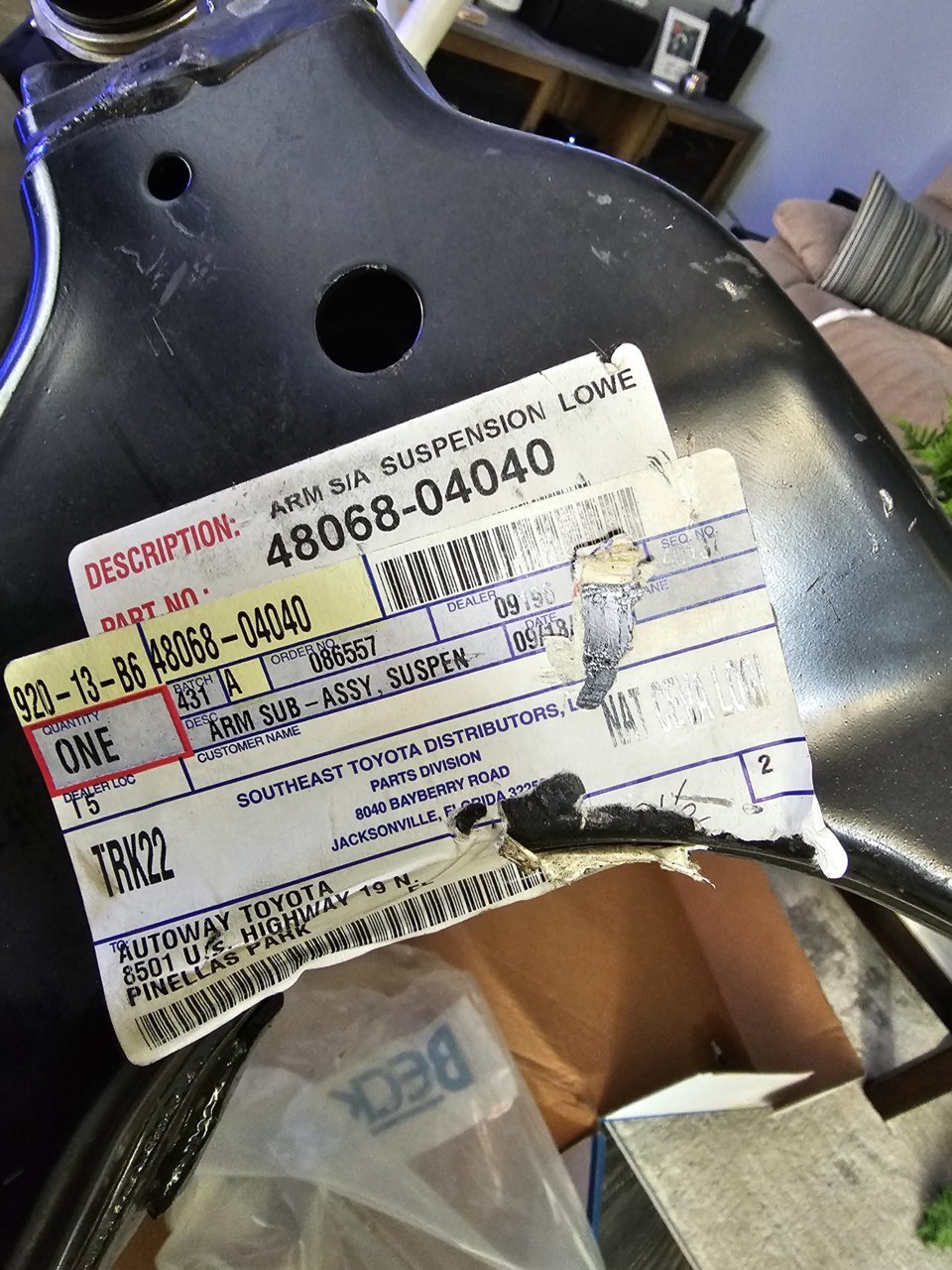

    RF lower control arm bushings are shot. Decided to just replace the arm, and chose Beck Arnley after doing some reading on the forum. Zero complaints here, they sent me a brand new OEM arm. Haha. Can't complain for $150 on Amazon
    banditcamp and lagbc[OP] like this.

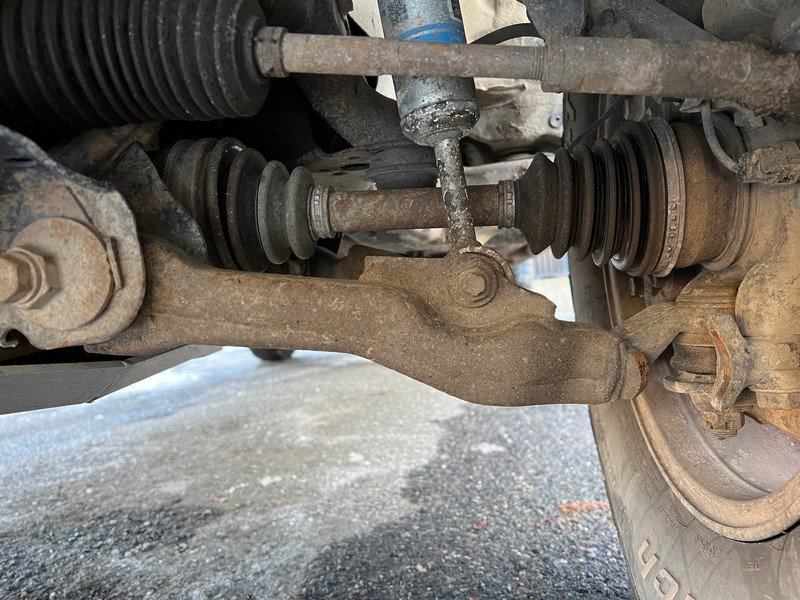

    So far I have 100k km/60k miles on them and they have worked fine. I tend to drive pretty hard on rough terrain and no issues.
    But they aren't perfect, there are few things I noticed from day one and along the way:
    1. Bushing are squeaky. They are not silent. Not in regular driving, but if you hit a bump in the road or speed bumps you can definitely hear it. I just have radio on and don't notice it as much or care about it, but that noise is there. I
    2. Paint chipped away pretty fast. I live in PNW and drive fair bit of Forest Service Roads (gravel).
    This is how they look now:
