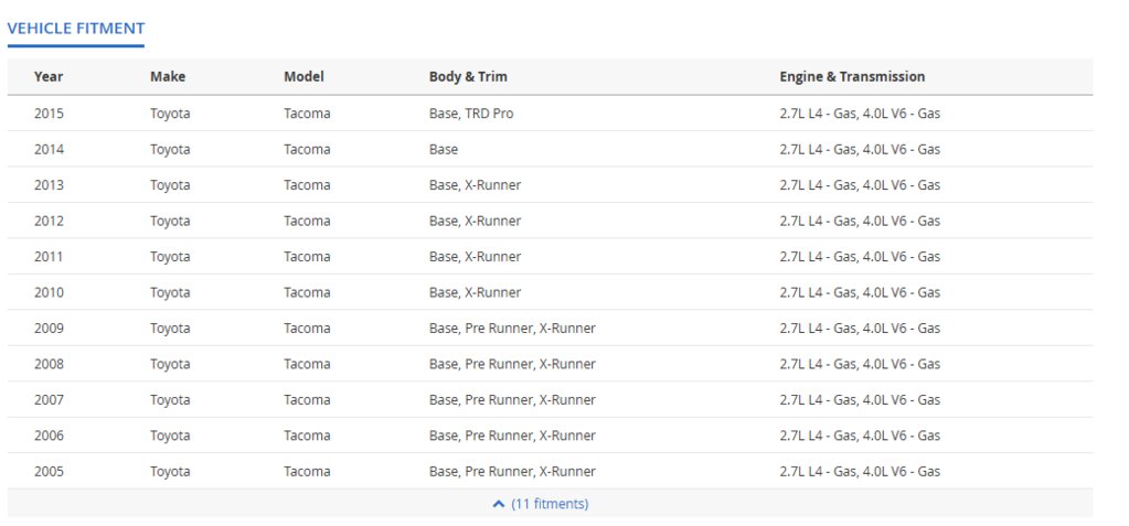

    If I understand it correctly then all 2nd Gen Lower Control Arms are the same, but maybe I am wrong:
    vssman[QUOTED] likes this.
