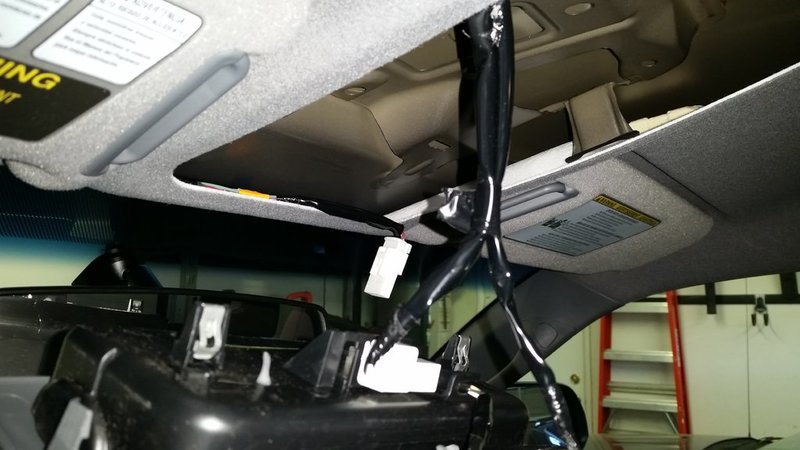

    You have a 2014. I have done the compass/temp/homelink mirror in my 2014 and I can tell you for a fact that your 2014 does NOT have the temperature probe under the hood for a mirror. There is one there, but it's for the car computer and you can't tap in to it for a mirror.
    You do have wiring in your header for a mirror, but it's 12v constant, 12v switched, and ground only.
    Pull your upper console and look:
    It's the wiring plug closest to the windshield.
    If you want a temperature sensor you'll have to get it and install it yourself. It's not that hard, just a bit tedious. You don't need to tear anything up. It's two purple wires you need to run behind your battery and through a big grommet in your firewall into the cab, then up the "A" pillar into your header. No need to pull the headliner.

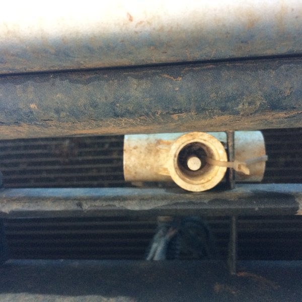

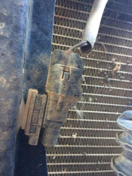

    Going off my memory of when I last searched this part number, and the fact that it's right in front of the radiator where my last cars probe was, I figured this was the probe?

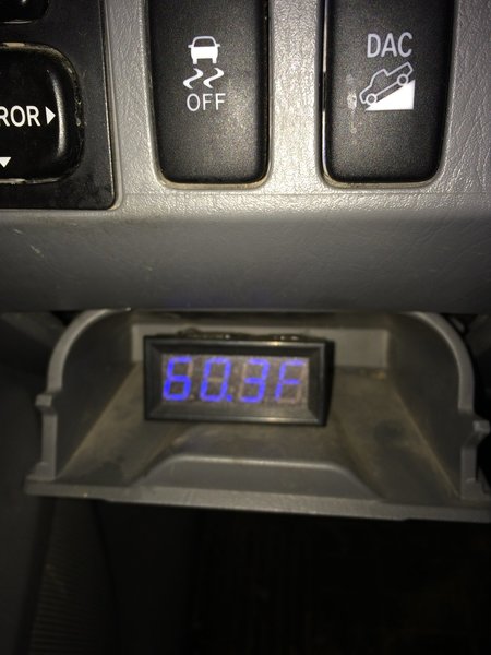

    Is that engine temp? If not I would have no idea where to place the probe. Every location I have tried either picks up too much engine heat or too much direct sun. Here is where I mounted my aftermarket thermometer probe. Yeah it looks tacky, whatever. The pvc seems to help diffuse the engine temp for a bit, but if I idle for a minute or two it's starts climbing fast. It could be the fact that the cycle rate in that thermo is 3x per second, not sure. Or OEM car thermometers are just smart enough to stop reading whenever the car isn't moving. Either way, I've never had inaccurate readings in vehicles with OEM outdoor temp. All may seem very trivial but I should add that an consistently accurate temperature read out is very important for my work and hobbies.

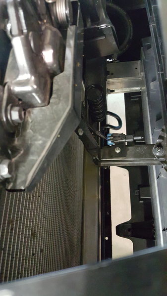

    That's the OEM computer temperature sensor.
    Here's where I mounted mine:
    Heat soak is minimal, but you ARE going to register increased temperatures when idling, that's the nature of the beast.
