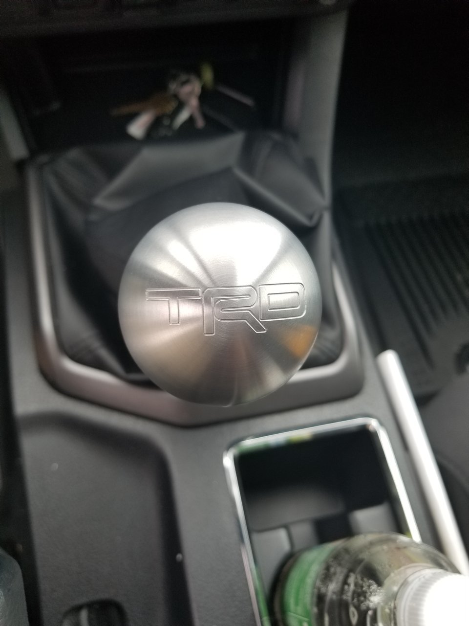

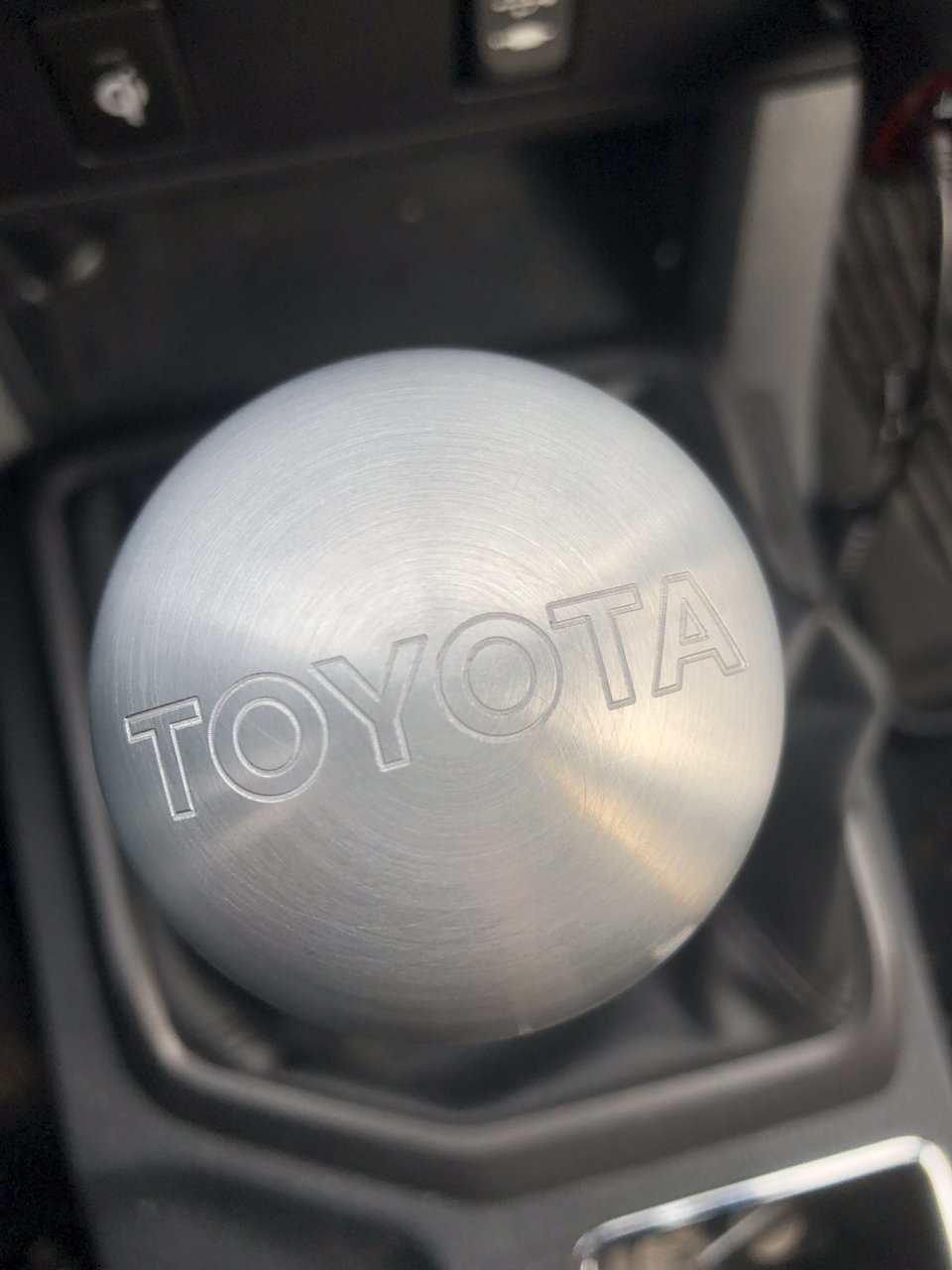

    Arrived today, installed flawlessly. Thanks 7r41lbr34k3r for the fantastic work!

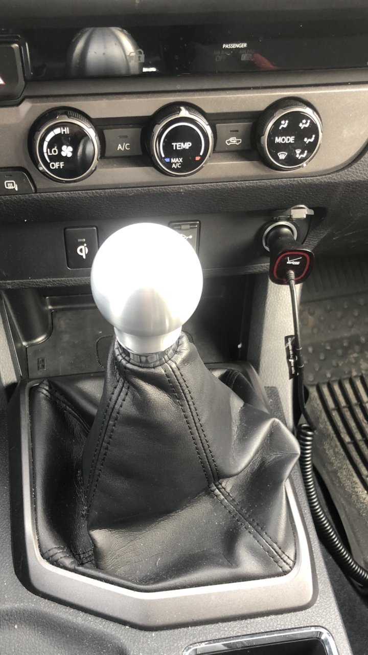

    Looks good. Did you end up using a shim to get it lined up? If so, what did you use?

    I used a chunk of plastic hose scrap from work, just jammed er up there and gave me the compression to tighten to the correct orientation.

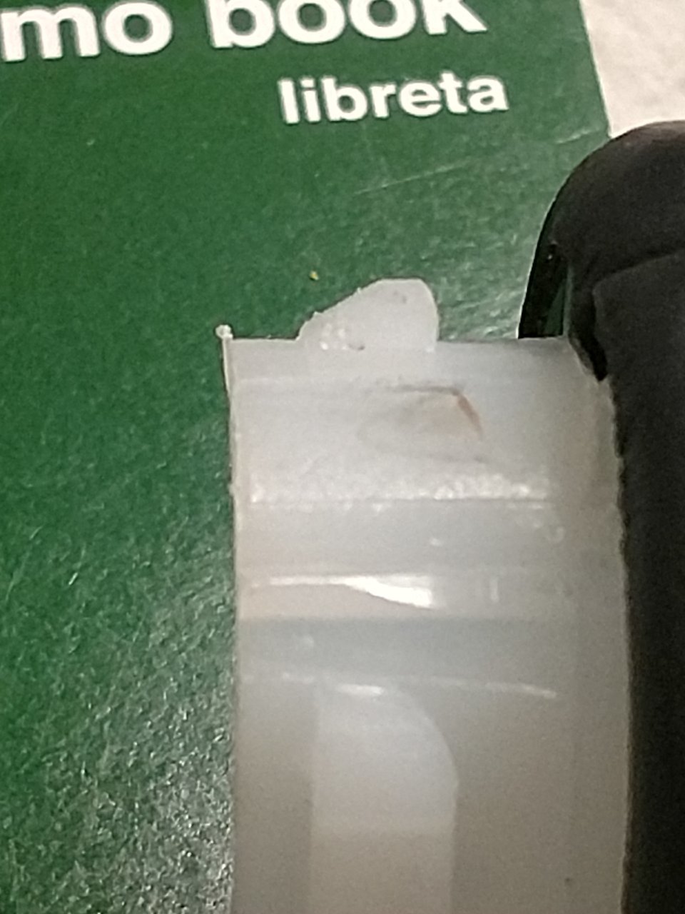

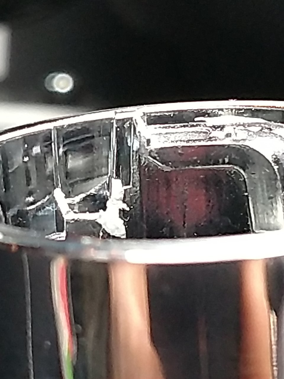

    We've had 2 fitment issues already, driver's side lug.
    If everyone can provide a picture of theirs(stock knob) in this thread, that would be awesome.
    I'm starting to think the chrome collars were poorly trimmed from their mold cards, which would damage the soft plastic on the knob straight from the factory, but I'm not certain of it yet. Need more input!

    Easy fix.. I used a dremmel and shaved down like the factory plastic lug. Wish I would've done that before I tried the boot connector... wondering if the OR models have different lugs

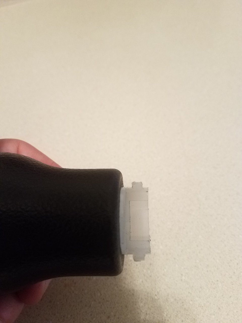

    Both the knob and the boot slot on the driver side appear to have a slight taper. Maybe a difference between OR and SR?

    Another pic of the knob. Definitely seems to be molded that way. Seems easy to overcome by clearing some plastic on the boot ring.

    Are you able to measure the flat area between the top of the slot and the beginning of the taper?
    The lug thickness on my stock knob is .155", or roughly 5/32".
    I had that taper in my boot collar as well, but it's quite worn down at this point.

    I don't have the means to get the precision measurement you're probably looking for, but the flat area on the knob is about a 1/16" before it starts to taper.
    Also, on the ring you can see that there is a slight ramp at the beginning of the slot at the top. IMG_20180210_120324395.jpg

    If your having issues, to fix it I used a dremmel with cylinder shaped sandpaper to take it to a taper to get to close match. Worked out great

    Perfect, I think that is plenty close enough. I can approximate the angle from your pictures as well.
    Future orders, if they have the same tapered lug ... I can just put it back up on the indexer and make a cut before shipping.
