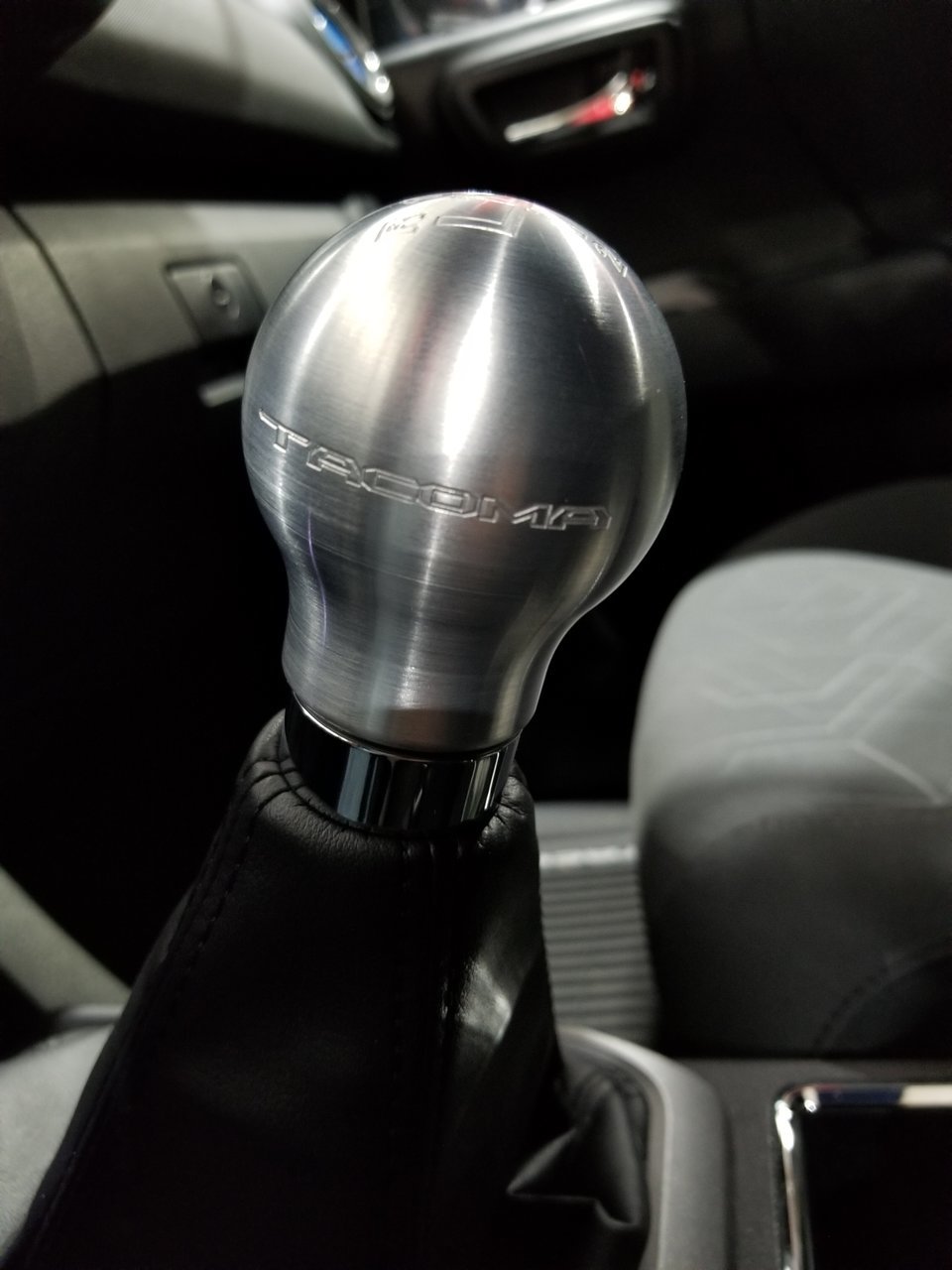

    I didn't bring my laptop home this weekend, but @Axxra took very good pictures. When I get back to work on Monday I can model the collar up and color code the areas that require attention, or just use his pics and circle stuff using mspaint.

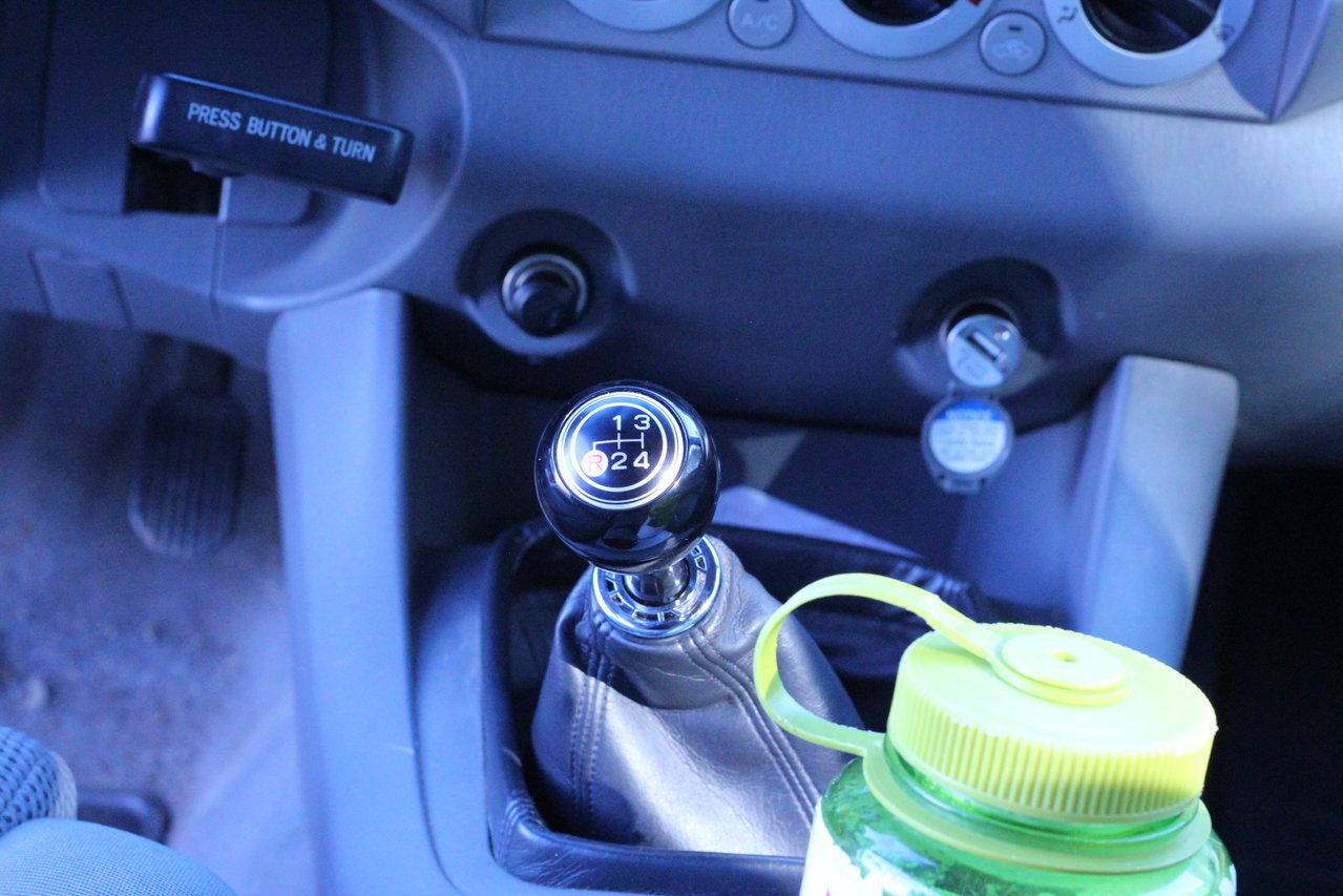

    I run an FJ60 4 speed shift knob with my 6MT. It's not the same pattern but who cares. I never look at it anyways. Gives the truck an old school Toyota feel. love it. And was only $20 at the dealership.

    The craftsmanship of the knob is fantastic though. I love the look, and the weight has helped with my shifting. Props to @7r41lbr34k3r for putting his energy into this project.IMG_20180210_152343246.jpg

    Ok, here is the interfering feature, bottom picture highlights what I am talking about in green. Notice how the finish looks jagged. I'm guessing this is a break line ... looks like that is from a channel in the mold so they can make a bunch at a time that are all connected to each other. Mine was jagged from the factory, not sure if this particular one was modified or not at the time of the picture.
    And here is the modification to the driver side lug to clear that area ...
    I wish I could show more of the aluminum knob shown above, somebody came up with a really good idea to engrave on the side ... looks killer. I'll leave the reveal to the customer though, because it is the right thing to do.

    Installed!! This knob is a beast. Beautiful. The craftsmanship and so detailed. Worth the money. Thanks Rick! @7r41lbr34k3r

    Looks great ! Excellent idea with the engraved sides, I went ahead and updated my own knob after I made yours.
    Yep, this was the first shipped with a chamfered lug.
