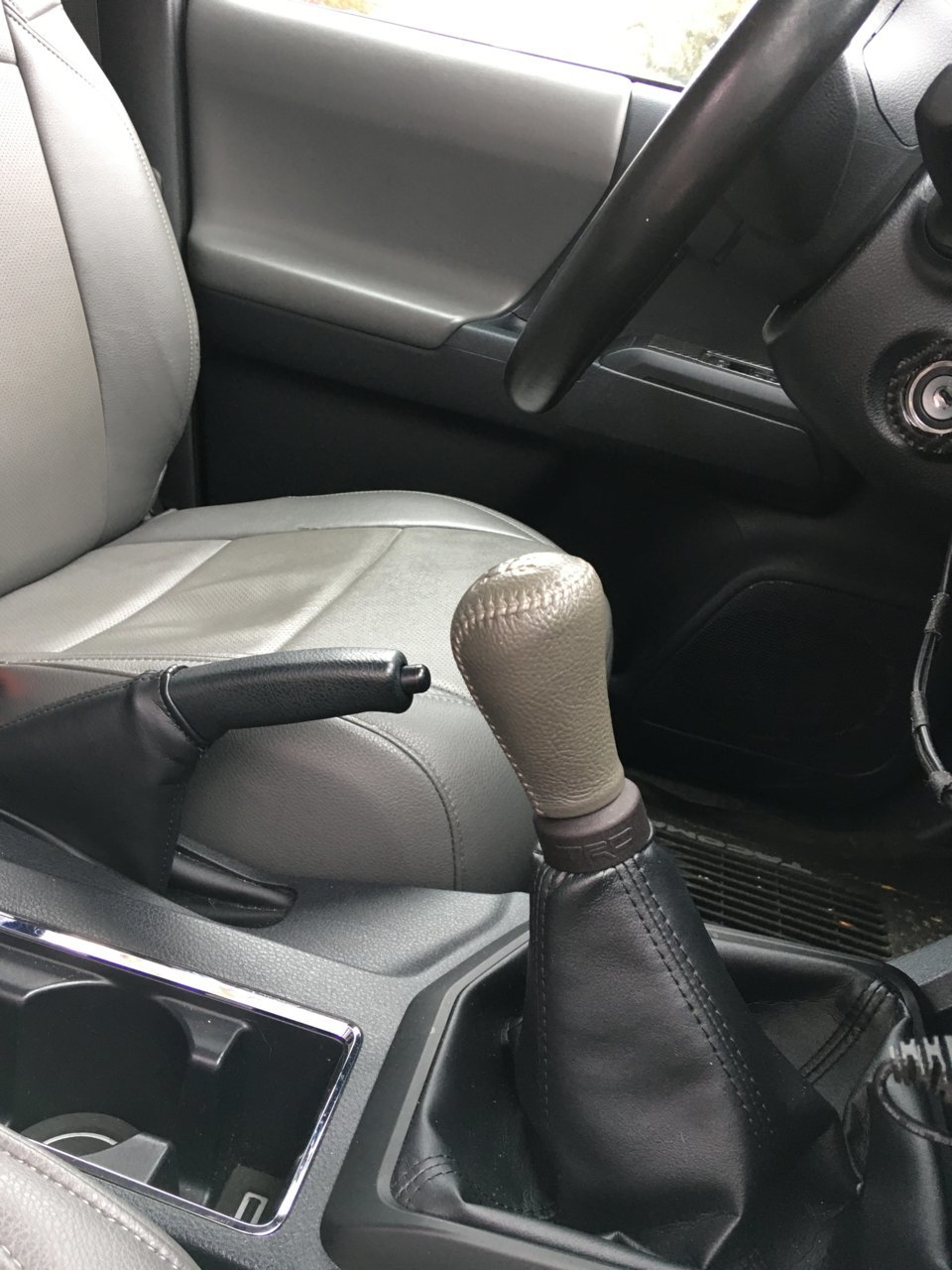

    Redline custom leather shift and e-brake boot. VFTUNE Super Full Otto cycle, octane learning, premium fuel.
    Here is my shift ball, and Redline boot and e-brake. 20200528_211615.jpg 20200528_211420.jpg

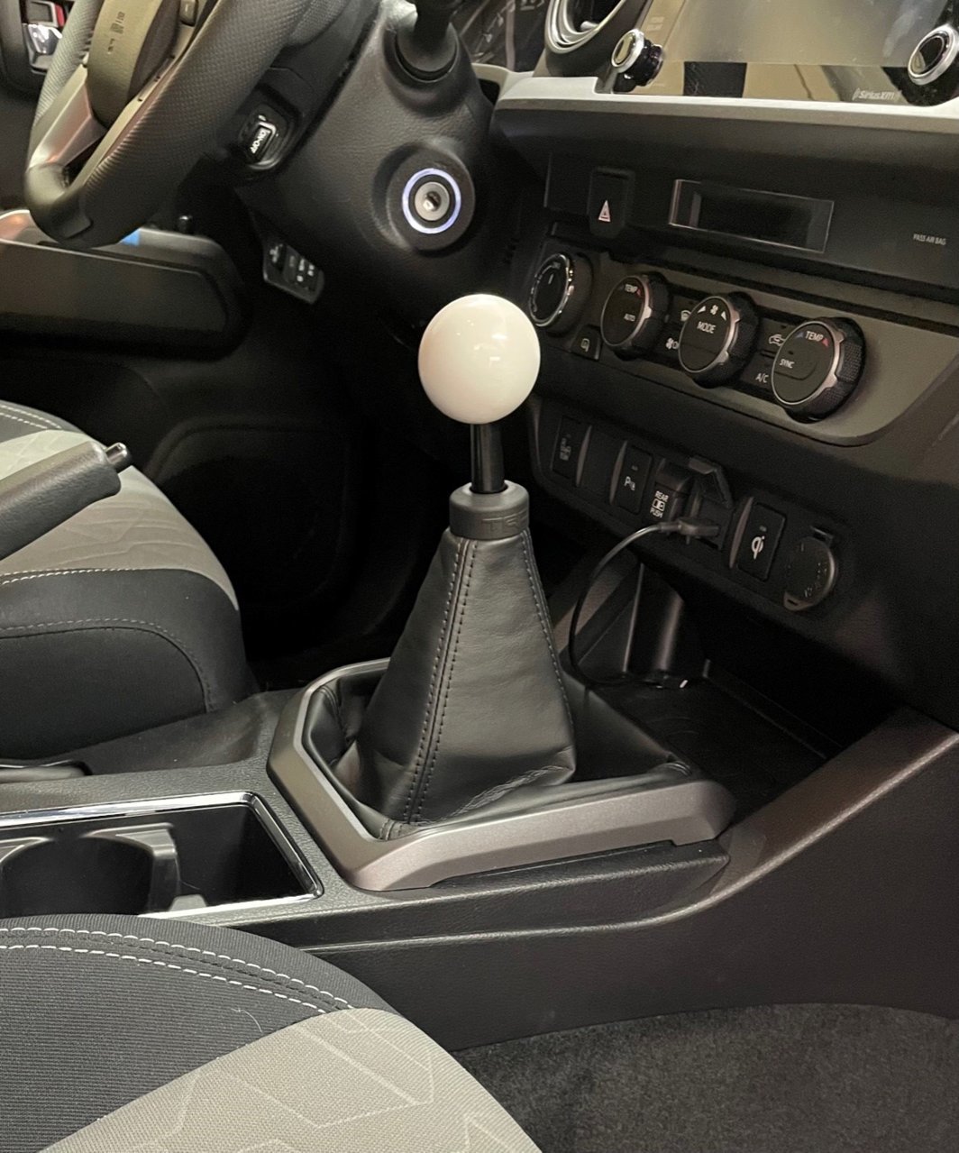

    New to forum, just got a white trd off-road MT, first Tacoma I’ve had since trading a black gen 1 off-road MT 17 years ago. My shift knob is a $8 cue ball from a Amazon. I drilled a 15/32 hole about 1.5 inches deep and ‘tapped’ it with a m12 bolt. I then counter bored the hole with a 9/16 bit about 3/4 deep to clear the taper on shifter. I am waiting on trd shift boot collar, but for now a 9/16 tie-rod dust boot from Napa flipped inside out look almost factory.F14D29C9-B9F0-4D31-8FE1-982C8B63B384.jpg
