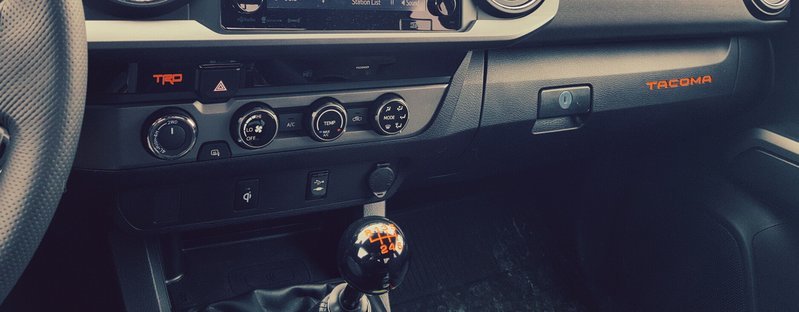

    I'm expecting one of these any day. 733g, rough powder coated so no heat problem, and he's testing a nipple bottom end that may allow the OE boot to use the stock clip.
    from here:
    https://anarchy-motive.com/products/6-speed-goliath

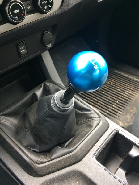

    Actually 3/4" grommet, http://www.homedepot.com/p/Everbilt-3-4-in-Neoprene-Grommet-812048/204275920
    Literally just did this like 15 mins ago, looks pretty good IMO. IMG_0399.jpg

    3/4 Rubber grommet is all you need, that being said, make sure you cut either side of the grommet lip off, essentially so that there is no more groove, and you have one lip showing, this is done so that when you smash the grommet inside the chrome ring it doesn't hit the plastic notches that attach to the original shift knob, if you don't do this part, the grommet will push itself up and the shift boot will become loose again. Hope that helps anyone.
