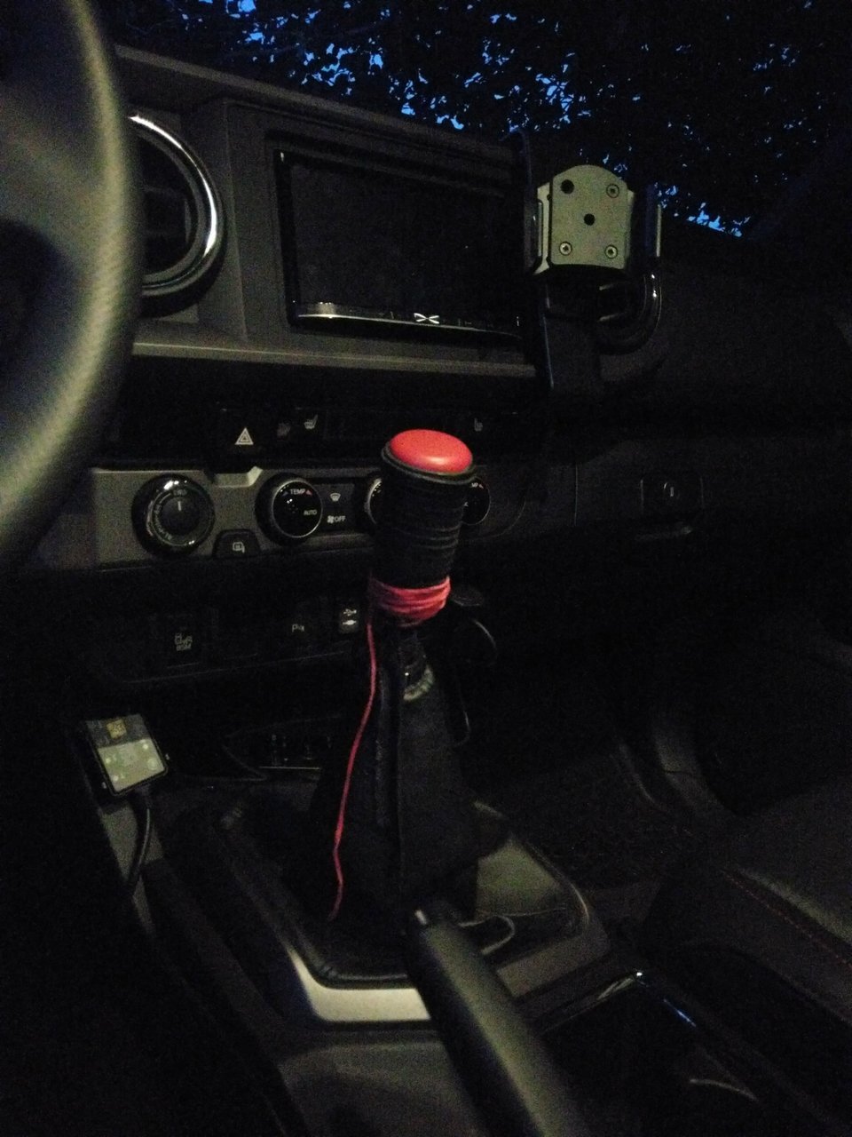

    Got my "Get A Grip" setup recently. Decided to run the "Brooks" leather. I have worked with bikes for awhile and had access to all kinds of grips. These are by far the heaviest, and widest you can buy. It is perfect for a shifter. Even better, the grip can be shortened. This photo is the grip at full length. When I get some time I plan to lop off about 1" from the top. If anyone wants the other grip its just sitting around. PM for info.

    big fan of the tall, heavy, leather-wrapped myself...

    hey btw, what's the approximate weight of that? can't find any mention of weight on the site.

    What all did you have to buy to make it work? The "go get a grip" adapter and the brooks grip? Looks like each grip is around 145g. Any guess on what the adapter may weigh?

    It looks like "go get a grip" list the grip and adapter as 170 grams. So my setup is sitting probably around 300g. There is a little cut out at the top where I put a bar end plug. You could probably fill that with some heavy material to get some more weight.
