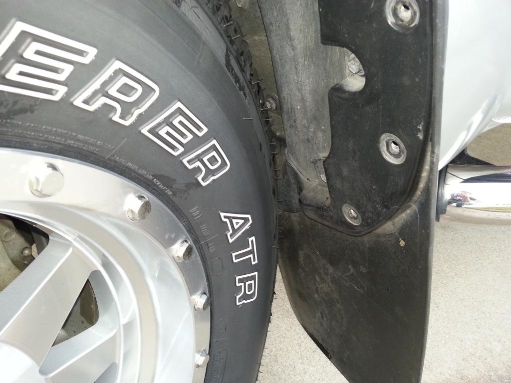

    i knew from researching here that the front mudflaps may have to be removed with 265/70/17 and aftermarkets rims.
    my rims are 17 x 8.5 with 0mm offset. but what i'm asking is that they rub at a "molded" part of the mud flap, it seems to have that bump for no apparent reason.
    are there any aftermarket mudflaps that are shaped differently and will solve this problem?
    i would very much like to have front mudflaps, i can't believe how much crud and ROCKS get thrown up onto the bottom of the side mirrors!
    i did a search, and i don't know if the HUSKY ones will solve this problem. and they seem a little short.

    yes i knew some people would say to take them off, but i want them on, as i mentioned i can't believe how much schmootz gets thrown up on the side mirrors.
    i thought of removing the bump with a dremmel, but if i don't take enough away, the tread can 'catch' on the cut edge and make it worse.
    i wonder if i can take a blow torch, heat it up a bit, and smoosh down the bump. i have nothing to lose.
    lots of photos of HUSKY mudflaps here, but they never seem to show the wheel well side.

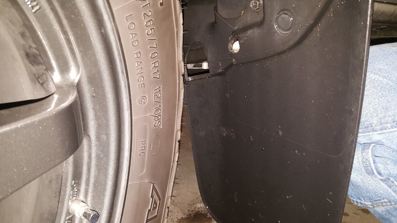

    has anyone had success doing this? Just took off mine but now I want them back on lol

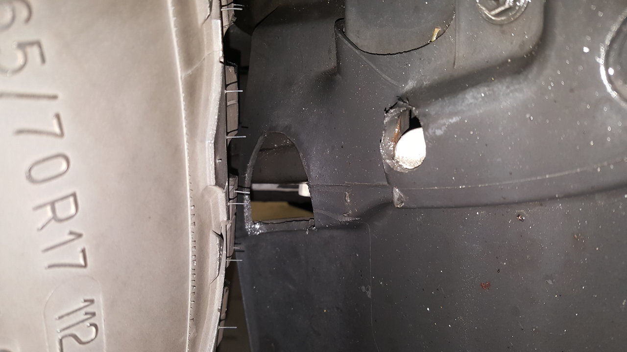

    That's what I did, and now I only rub at extreme steering wheel angles. 265/70/17, 17x8 0 offset.

    There is some fender behind that bump. It's there for a reason. But it will buy you an extra half inch of clearance, if memory serves. I've had no major issues since.

    Here's a couple pictures of my handiwork. 20180117_230710.jpg 20180117_230746.jpg
