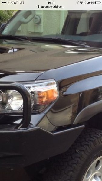

    Did you say cutting? They look fine after a little trimming.

    Is this a 3rd gen bumper? Did they cut and glue it back together or what?

    It's a 5th gen 4Runner bumper. To install the ARB I had to cut the front valance. You can see it back on the 4Runner before I put the ARB bar on.

    Yes bump were the bumper meets the fender is a straight horizontal line. 3rd gen it's not

    Look under the headlight in my picture, it's not a straight line either. With frame flex and the distance between the mounting point on the frame and where the ARB sits you need to leave a 3/4" gap or else the ARB will contact the fender when the frame flexes. There's little snaps that will hold the section in if its cut right.

    ok but there is still a part that is straight. the 3rd gen bumper meets the fender like this \. yours is more like this \_. Im just saying is its not going to look like the plate bumpers we are all used too. It wont have a staright flat top unless cutting is involved and the ends will be cut like this \
