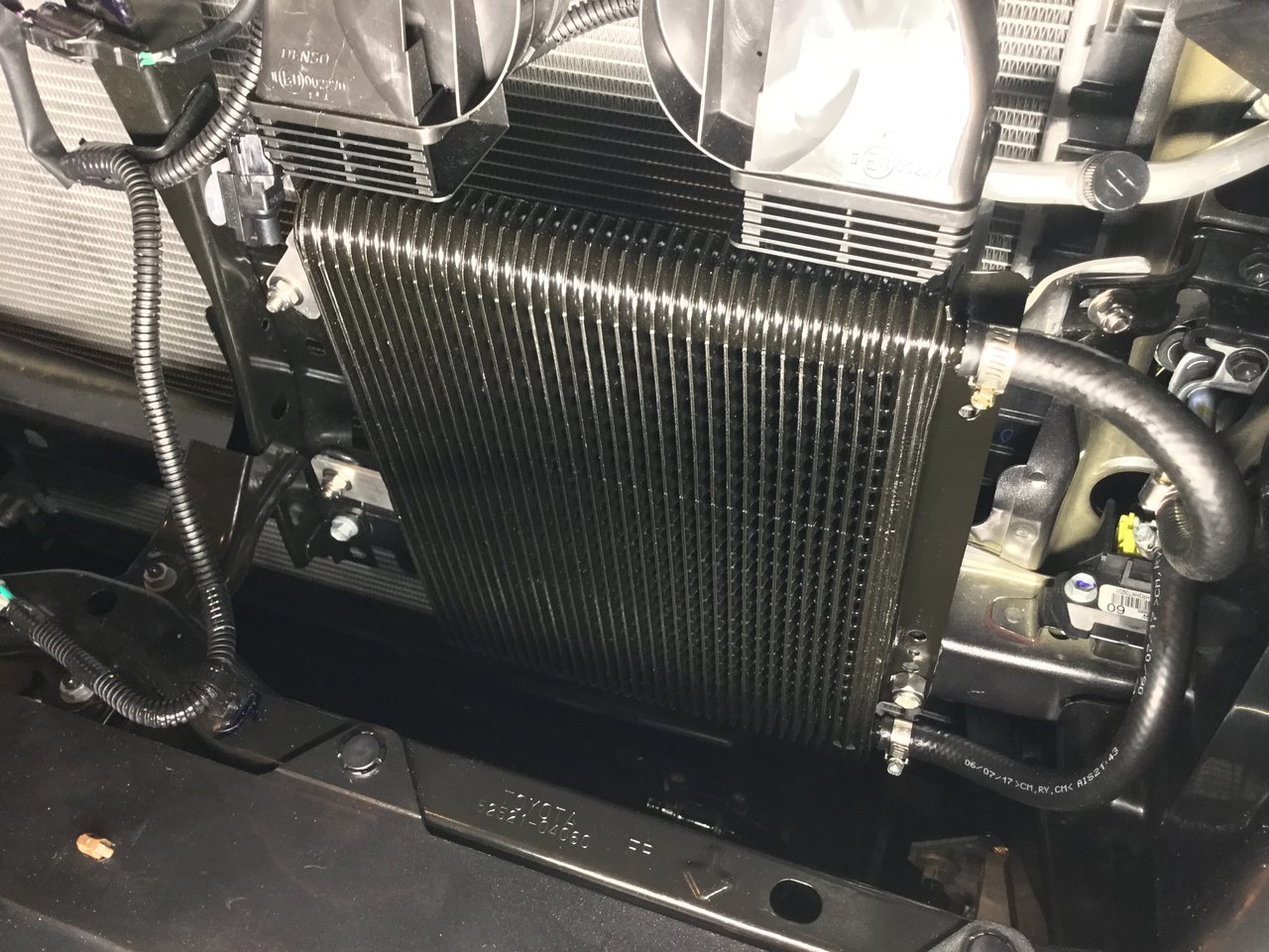

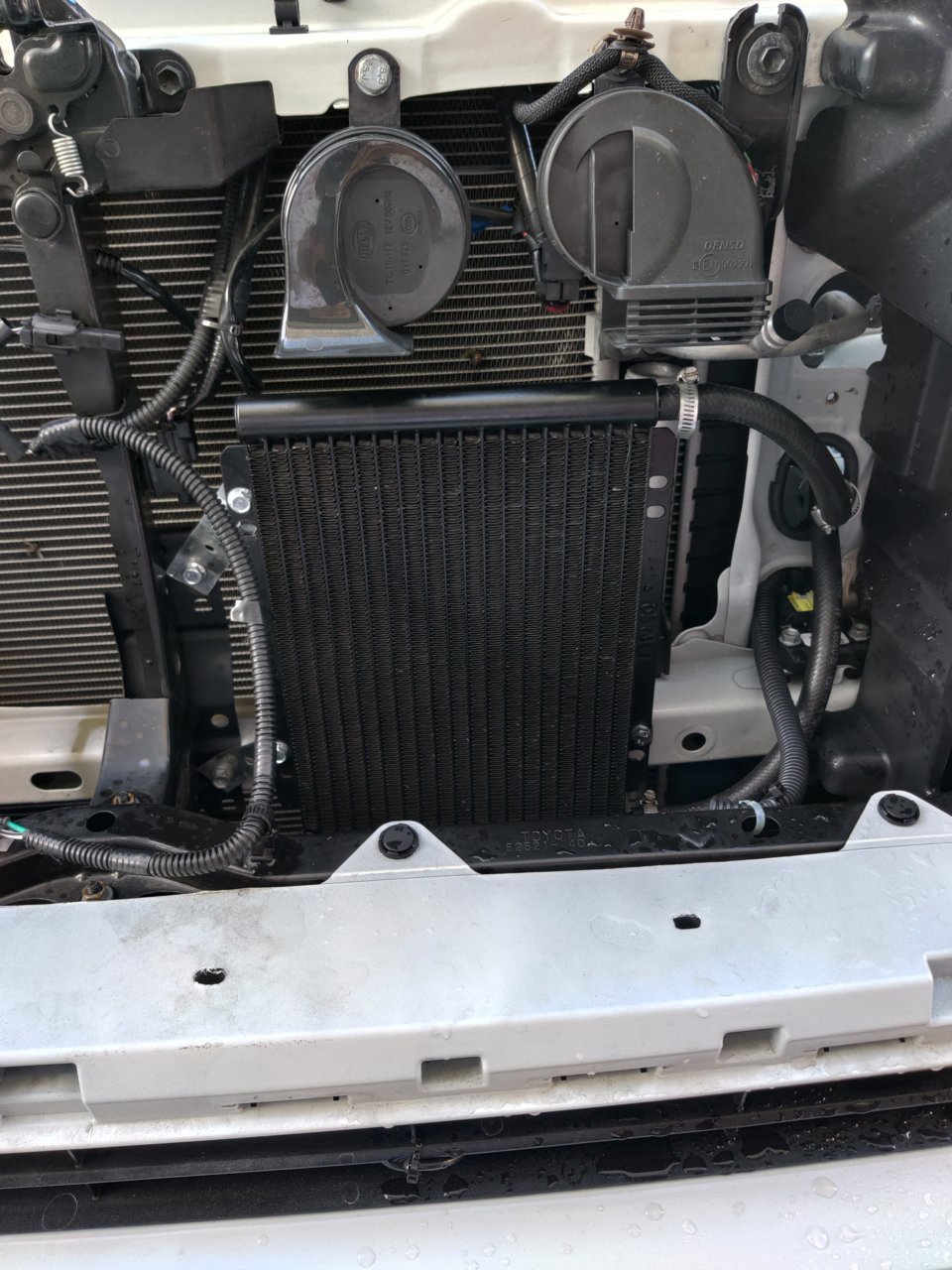

    Just wanted to show my install on a 2018 SR.
    This is the Derale cooler. Note that where the rubber hoses go through the radiator support I fabricated a rubber gasket to prevent chafing and abrasion.
    Hope this is helpful.

    Did you get satisfactory results from your expectations with this setup? It looks good on the install.
    Did you use the radiator as part of the system flow or use the stand-alone setup (no radiator involved)?

    Cooler was installed just prior to ATF drain and fill.
    Level was adjusted as part of service.
    Aftermarket cooler was installed in series with radiator cooler.

    This was installed just prior to ATF drain and fill so fluid level is now ok. At first I did the IR thermometer adjustment but found out my scan tool reads ATF temperature so I repeated the level check. Not too much discrepancy.
