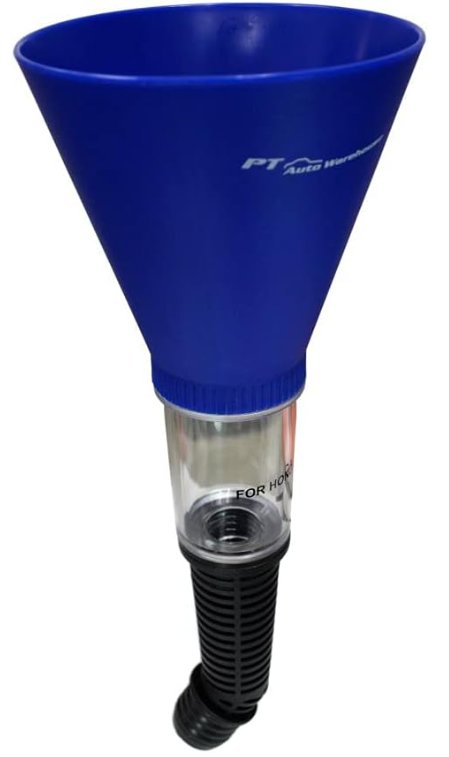

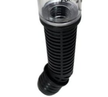

    I Love the MotiveX filter wrench and the filter drainy thing is cool but the first time I tried to use the funnel that came in the kit I wanted to throw it away. The way it sits when screwed in to the tacoma's oil filler is not vertical, it's closer to 45*. When I poured the oil out of my 5qt jug at a speed one would think is fine with such a big funnel I spilt oil down on the engine. Because the angle the oil doesn't pool in the funnel like if it was truly vertical and go down into the engine oil filler tube, instead so can easily run out over what should be the rim that's sort of facing somewhat downward toward the front of the truck. After cleaning that up I went back to my Harbor Freight Funnel.
    If MotivX would have included the extra bit like the one @zonzin posted a pic of to make it sit right I'd be able to take back saying the motivX funnel was garbage.

    You don't need the angled tip. It likely constricts the flow, so I don't see how it would be better than the straight screw-in funnels.

    With that being said that other one the guy posted that one that says it's only for Hondas. It has the smaller screw in opening and several people commented that you have to hold it in place which kinda defeats the purpose. That expensive Lisle kit does it right. A short piece you attach to the oil opening, then the 45* then attach the cone. I think the perfect setup would be one piece that short enough to not get caught on anything while you screw it on, then screw on the cone. Of course the screw on piece has to be threaded correctly so it's final resting place would be straight up. Sounds like an easy thing to make for a 3D printer.
