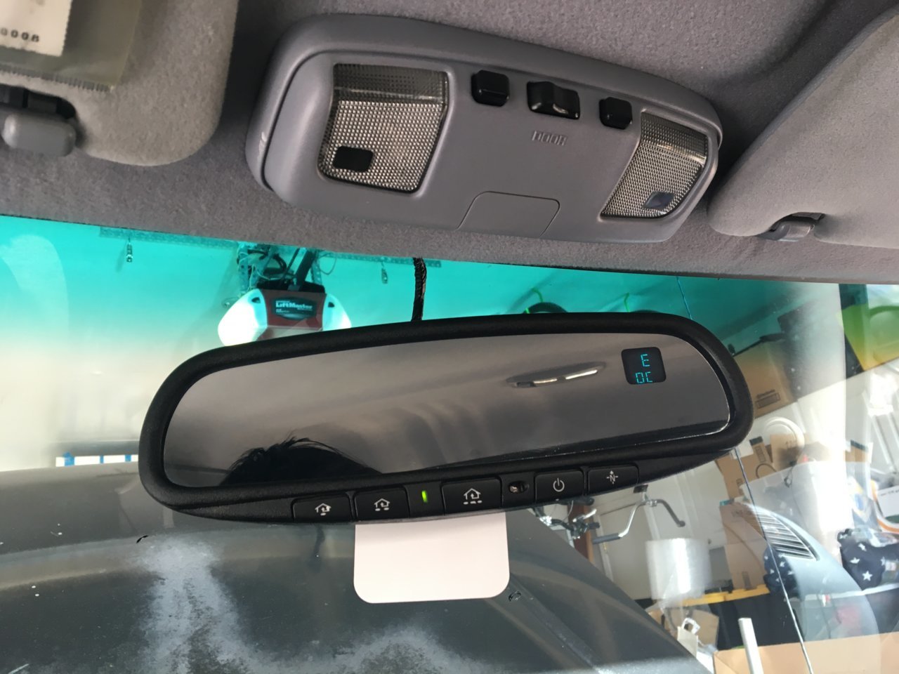

    I have an ambient temperature display in my Gentex 313 rearview mirror. I put the sensor dead center on the central radiator support, as it is supposed to be stock on most cars.
