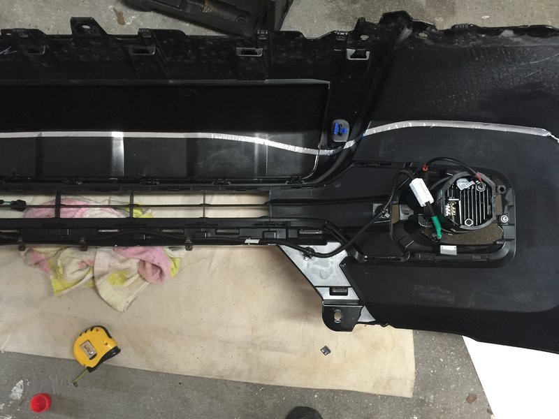

    Not best sensors as they measure proximity and density of the object in front of the truck, so empty trash can or metal bumper will give you different beep distance. But you don't have to drill holes, just stick antenna from inside of the bumper and you done, doesn't get cleaner then this.
