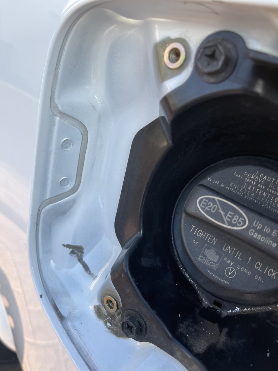

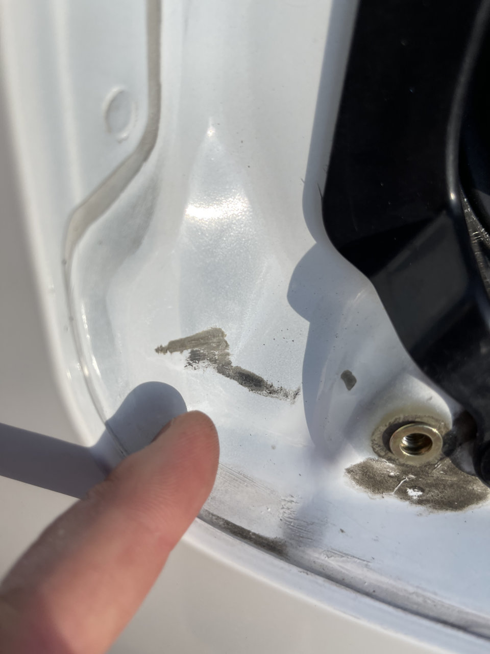

    Lubricate this?
    Oh well I probably opened it too wide at one point which misaligned the door and caused contact on the bottom left portion of the door.
    I drilled out the rivets and installed m5 rivnuts. Just waiting to get a new fuel door.
