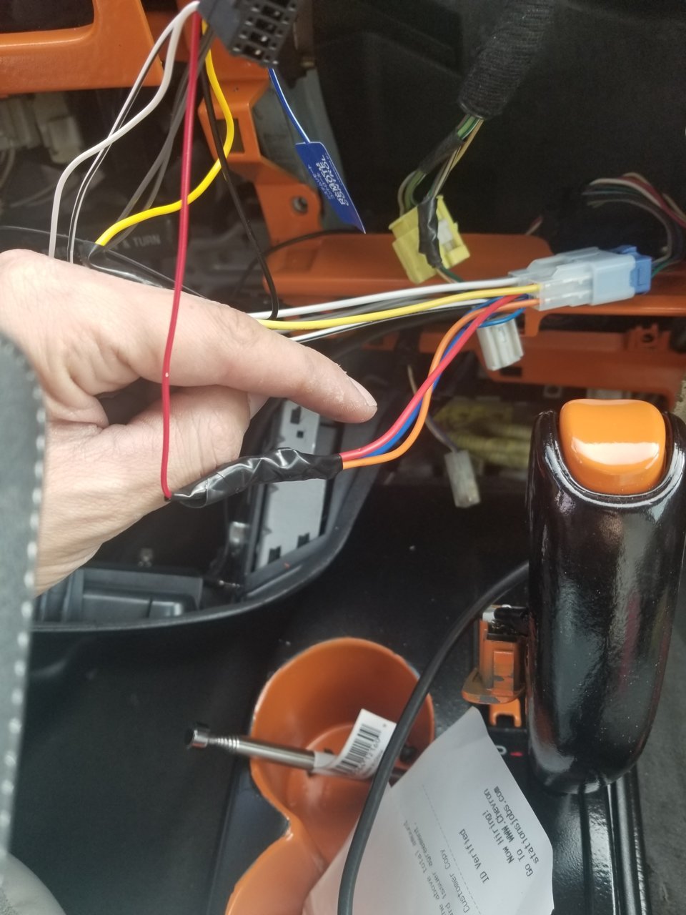

    It came with 2 harness and just match up the colors. I was left with blue and orange. Based on some threads and youtube they said to plug to red wire which i did.

    Cut that orange and blue away from the red. The red is switched power I’m actually very surprised you didnt blow a fuse or cause a fire. The orange is illumination. If your radio harness don’t have an orange wire on the actual harness than you can’t make the radio dim with headlights. Judging by your picture that looks an awful lot like a pioneer harness. If it’s not at least a deh-4200bt it won’t have illumination wire. I think you have blown the switched wire fuse which is why it only comes on with the headlights. It’s reading power from the headlight switch. Take a look in the fuse panel towards your left knee. There should be a 10 or 15 amp fuse that controls that.

    Correct its a pioneer. I had seen on youtube to have blue go with red, but ill remove since i dont have a stereo system. It says its for antenna, but car already has antenna cable.

    No orange/black. Just orange on adapter harness. Shoot so i cant even do the headlight plug? I'll see if car radio harness has an orange wire.

    You have the schematic for your truck ?
    You have the schematic for the new radio??
    You got the adapter that plugs into the truck radio harness ??
    You wired the adapter to the harness that came with the radio?
    Some where you have the wire from the light circuit connected to switched power so the radio powers up when the light switch is closed

    If you have no power antenna or amp the blue is not connected to any thing. It will be powered with the radio on so protect it with a bit of tape.

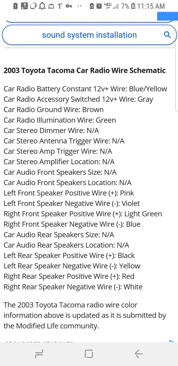

    Ah so factory raduo harness does have for illumination. See diagram. Says its green. How do i plug my orange to the factort harness? From behind harness?
