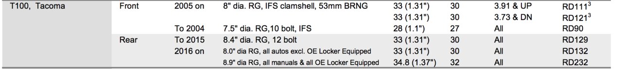

    I'm still curious is this really just for snow?
    Seriously if it is I'd save the money dude. You do not need a locker for snow lol. Unless you live in Yukon or something...
    I'm in southern ontario and go up north to central/northern ontario all winter (as far north as thunder bay) I do not feel the slightest need to ever touch my locker.
    And if you're really wheeling hard, why would you want a long bed? fuck I have the short bed and still want it shorter for the tight trails.
    Is yours a manual or automatic?
    if its auto you have the same diff as the 2nd gen with an 8" ring gear. if manual you should have the 8.75" ring gear.
    ARB will have it all on their site.
    eon_blue likes this.
  16. Oct 7, 2017 at 11:27 AM
    #16
    Joe23
    Joe23 Canuckistikian
    Oct 5, 2015
    #165909
    11,300
    The Great White North
    2017 TRD Off-road DCSB
    from ARBUSA

  18. Oct 7, 2017 at 11:36 AM
    #18
    RoverDover
    RoverDover [OP] Active Member
    Sep 26, 2017
    #231142
    34
    Nick
    2017 DCLB TRD SPORT
    so the Toyota electric wont fit my auto... ARB it is then.
