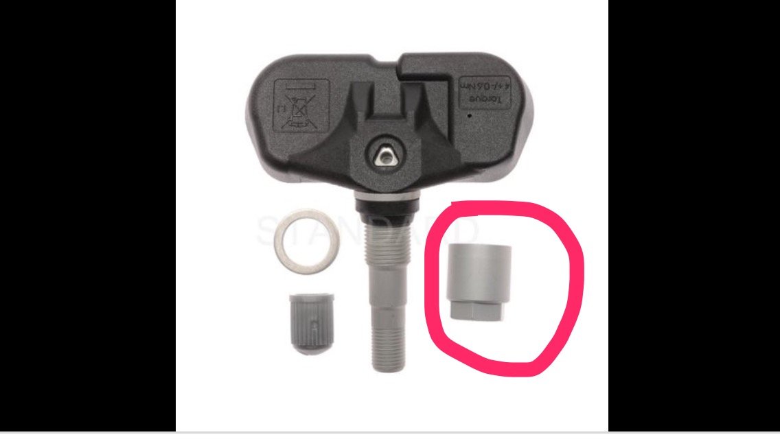

    1st thing, check to see if there's even TPMS sensors in the wheels. Look and see if you see a nut on the valve stem that looks like this. It's grey and has that round pipe look to it. If it has rubber valve stems, or chrome stems with a regular looking chrome nut, there's no TPMS sensors.
    There are aftermarket TPMS sensors with rubber stems, but I doubt you have those.

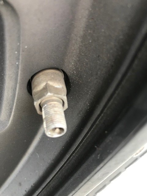

    I'm old school like I said. From what I understand this is a government want, nothing any reasonable vehicle or person needs. I'm 70 and have never owned a vehicle with this and I have IMG_2812 (1).jpg IMG_2812 (1).jpg never needed it. Any dumbas can figure out if they have a flat tire or not. I just want to help him get rid of the blinking light on the dash. This a photo of the stem in the rim. Does it look like a TPS to anybody?

    Yes thats a tpms stem
    If those are the original sensors from 2006 then im sure all the batteries are dead. Either replace them (all 4) and program them up or live with the blinking light
