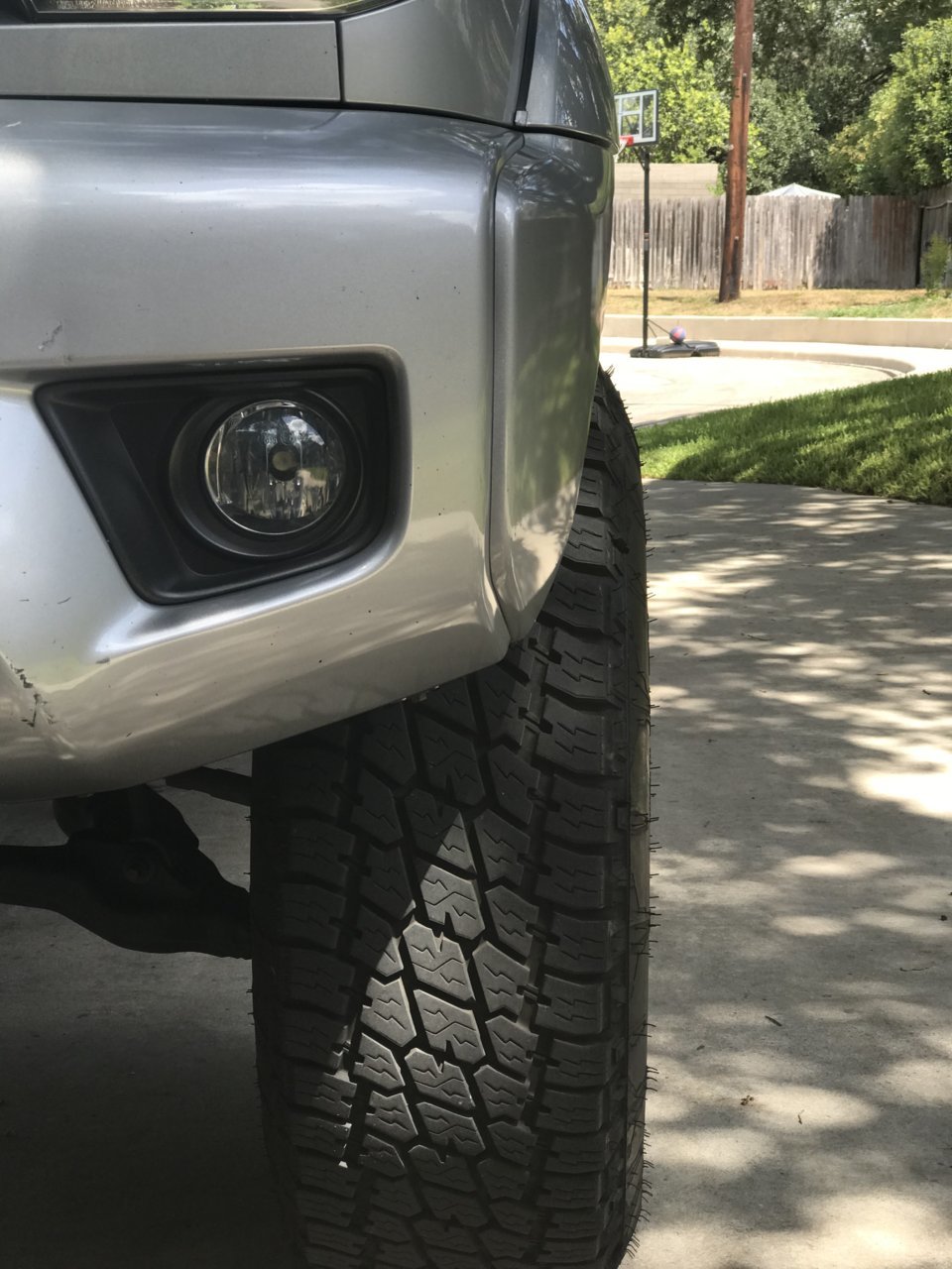

    I have 3” lift, running 285/70/17 on 17x8.5 -10 offset 81B00284-8DDD-4961-8492-82A67B80D4CD.jpg

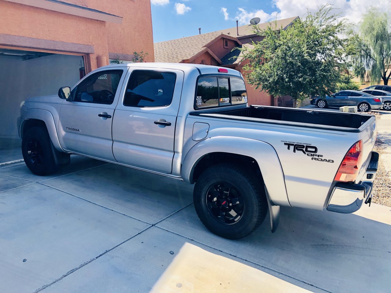

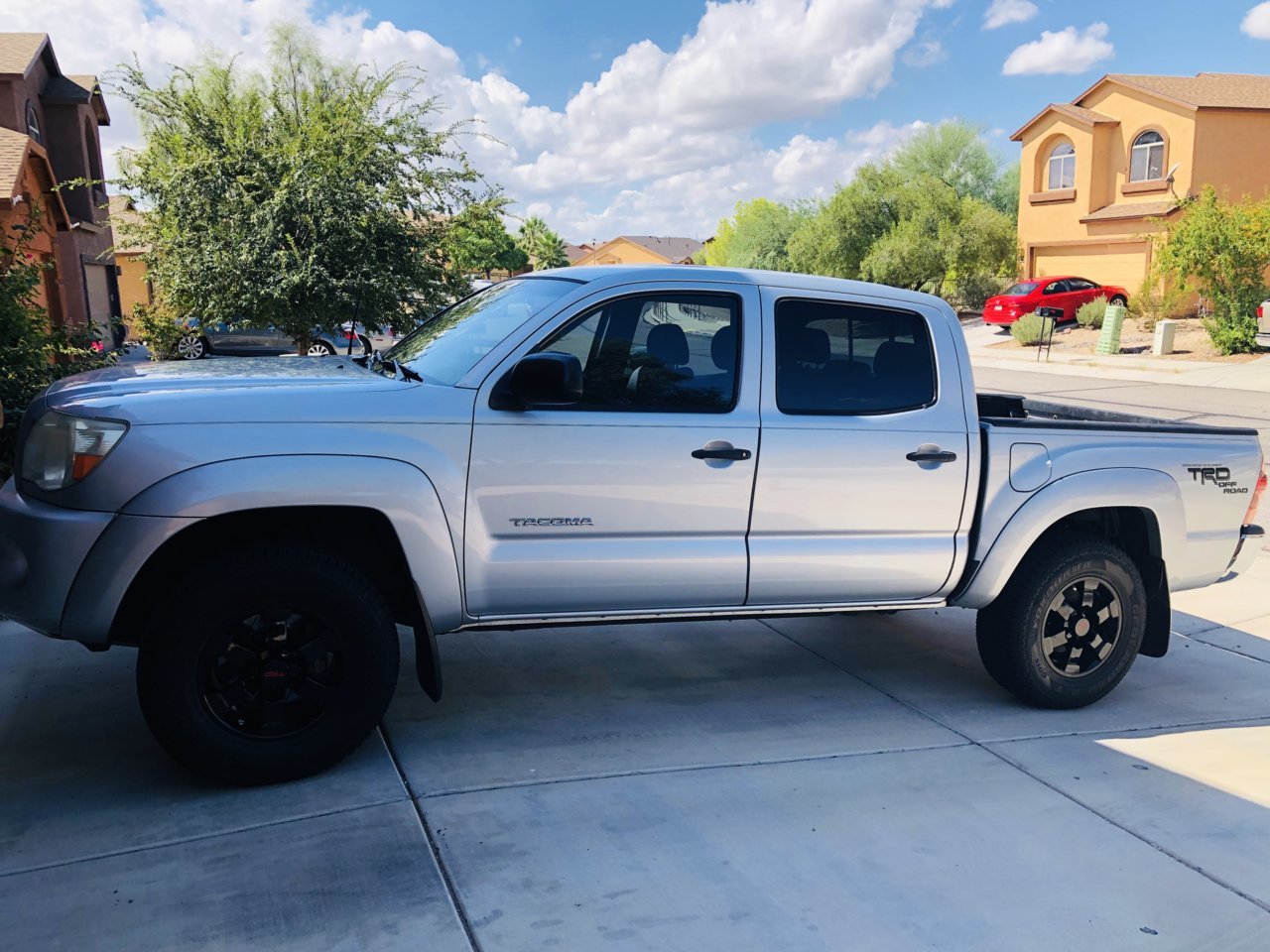

    265/70 with 16x8 FJ wheels and stock suspension. Poked the tires out about an inch with no rubbing. Should be able to run 265/75 whenever I get new rubber.
    Edit: not technically aftermarket but hopefully it helps.
    91DEAF5F-CEB4-4352-B23D-CBB9FCBCE9FB.jpg 9D3C944D-02C5-458F-8A13-017EC57D898C.jpg

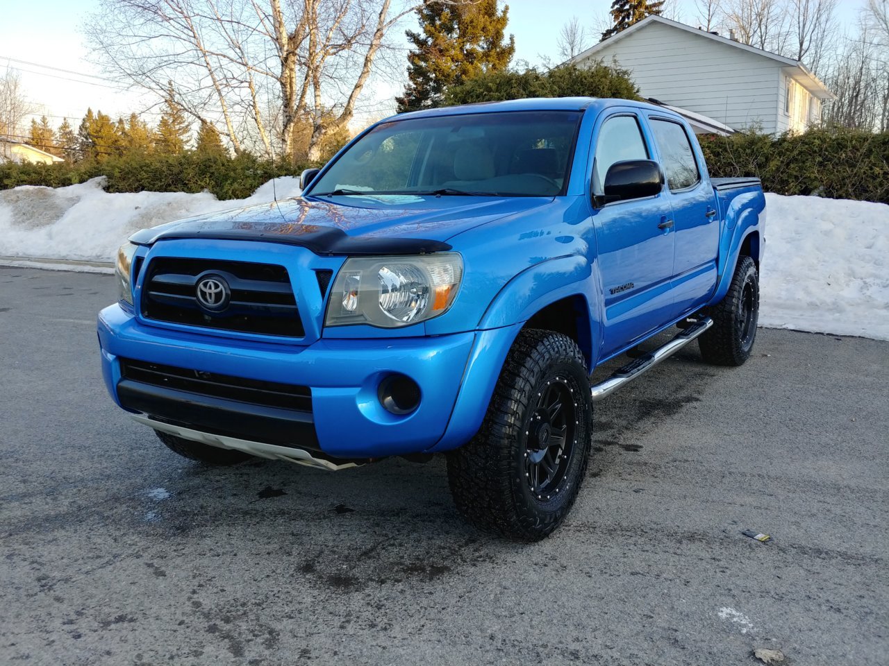

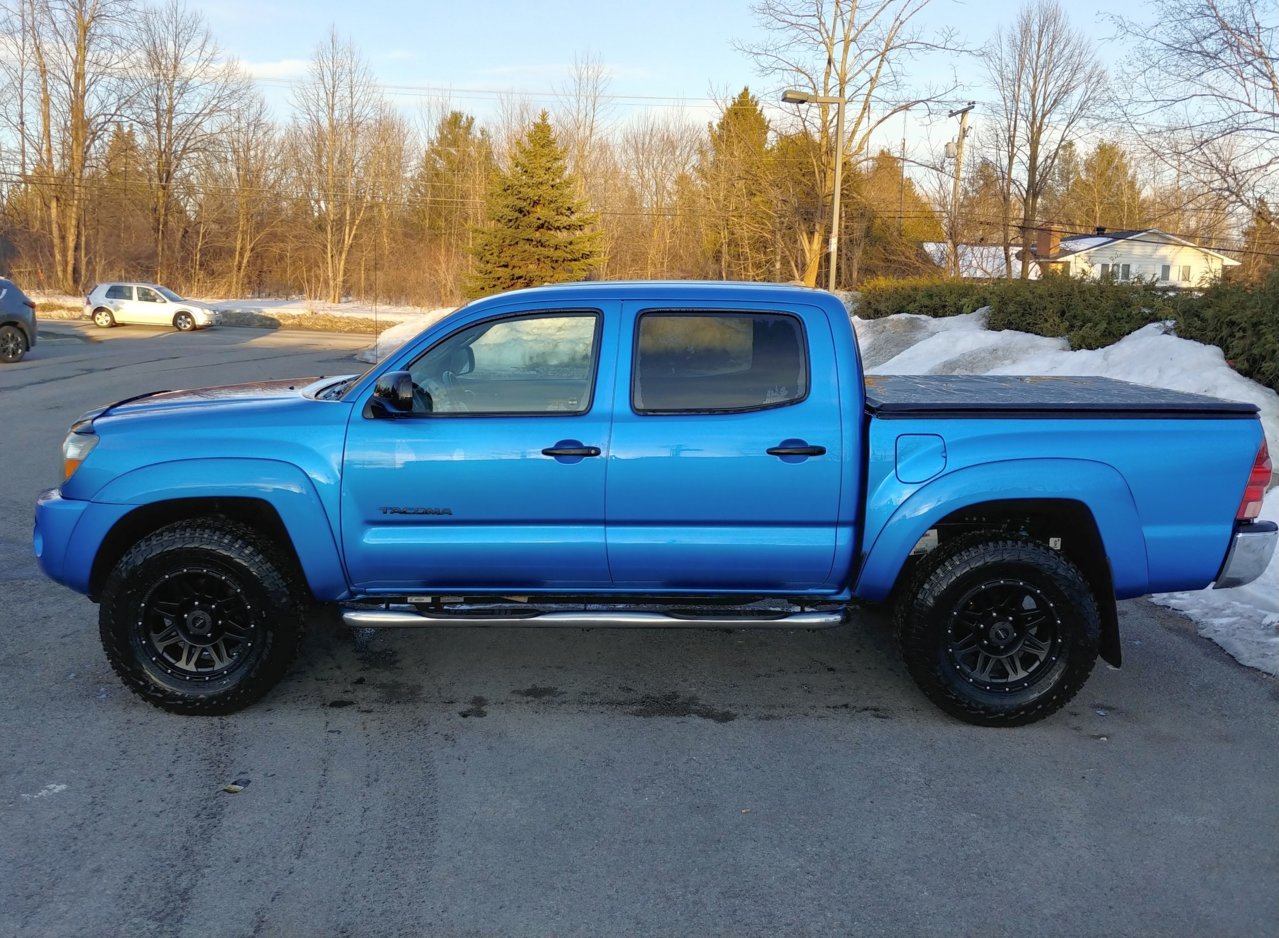

    I'm running 17x8 / 0 offset wheels with 265/70R17 Wildpeaks which are a 32" tire.
    This picture is with stock suspension and all I had to do was slightly trim the mudflaps, but now I have a 1.5" lift.

    That's the look I'm going for.....what brand wheels, DLillest?
  11. Sep 23, 2019 at 10:46 AM
    DLillest
    DLillest Well-Known Member
    Jul 3, 2018
    #258200
    756
    Quebec, Canada
    2007 SBM DCSB 6MT 4x4
    Wheels: Pro Comp 7005 17x8 / 0mm offset
    Tires: Falken Wildpeaks 265/70R17 C Rated (Lighter than an E Rated tire so better MPG but with an aggressive tread)
    I purchased them from Discount Tire and they are really great to deal with. They price matched and beat the price for the wheels from 4WD (30% off). Plus they also price matched the Falken Wildpeaks at the same time from Tire Buyer (15% off).
