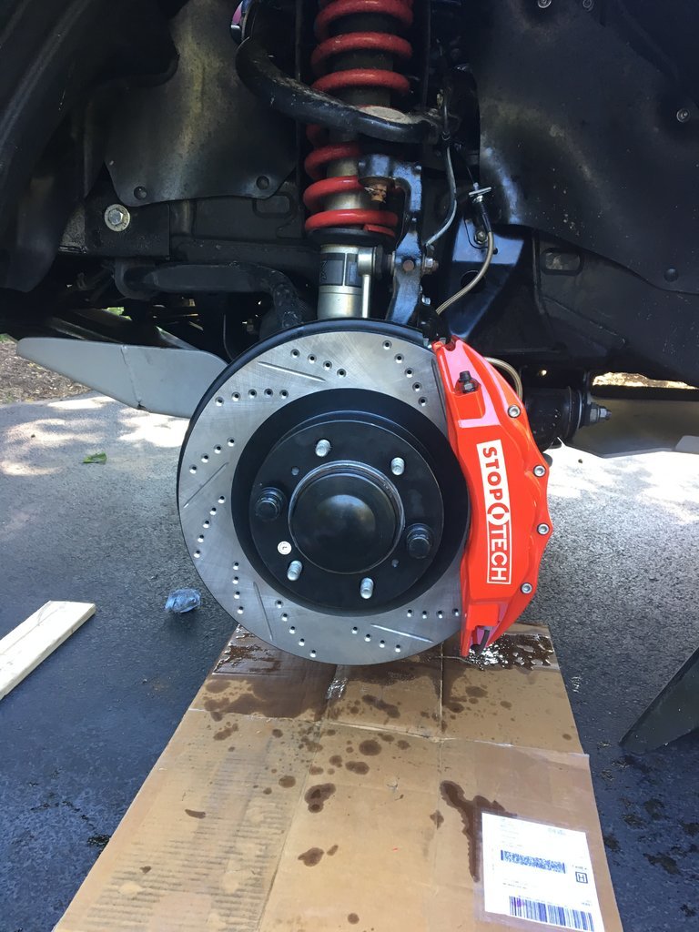

    Rotors are drilled, slotted, or both primarily to increase cooling. It is completely unnecessary for street use however. Most people just have them because they look cool and they are not that expensive.
    Most guys I know that use their vehicles for auto cross or drag racing use solid rotors because they are a lot stronger and aren't as hard on pads. Drilled and slotted rotors will wear out pads much faster.

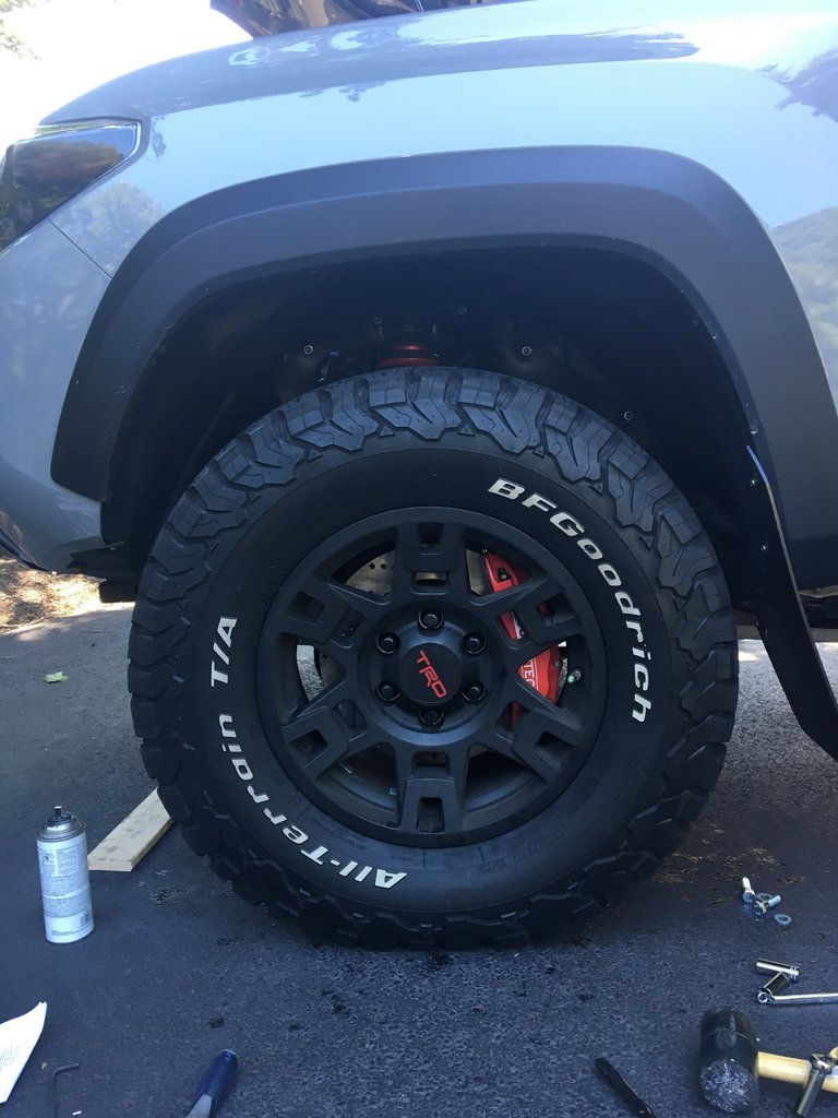

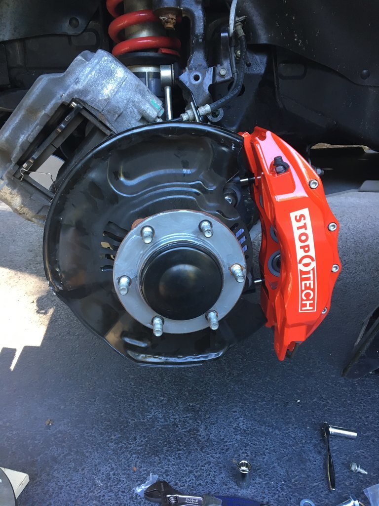

    rotors are from the TRD kit but the calipers are better than stock.

    Do you know if these work with the 17s on a sport 3rd gen?

    Autocross events are generally short and same with braking in the 1/4. I've never had brake fade when autocrossing. Generally tires get greasy first more than anything else. But yeah, no real reason to get cross drilled or slotted unless you're putting yourself into situations where you would experience brake fade normally with stock ones.

    You are definitely correct, however I would imagine that while those events aren't terribly hard on brakes, they will be harder on brakes than the average driver would be driving home from work everyday. Unless you are driving down mountains on a regular basis you just don't need rotors that dissipate heat better than solid rotors.
