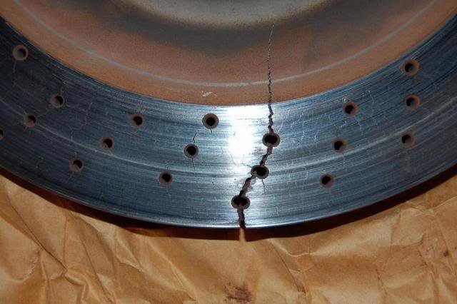

    48155896d1501528106-drilled-rotors-vs-sl_eef3335e0075fd310d8ba13cb6cbf2ab86f96759.jpg
    if you think that's ok then be my guest and run drilled

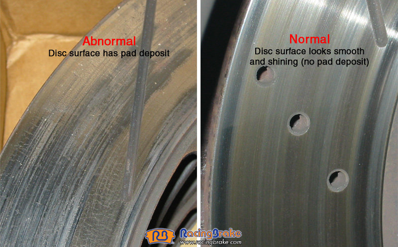

    but if you look at the solid slotted rotors on the left closely in the pair of pictures below , the heat buildup/pad deposit is causing the rotor to crack circumferentially on the rotor. the right picture shows a good pad matched to slotted drilled rotor.
    Photo credit www.racingbrake.com
    What I'm saying is buy good pads, good rotors, and keep and eye and ear out for problems. If you see cracks in the rotors, its a sign to think about replacement. I've got 3200 miles on my Tacoma DCSB 4x2 TRD Sport and it already has issues in the front brakes.

    I pulled a picture to prove a point. doesn't matter if its from 2010 or 2017 drilled rotors are prone to cracking. its going to happen no matter what.

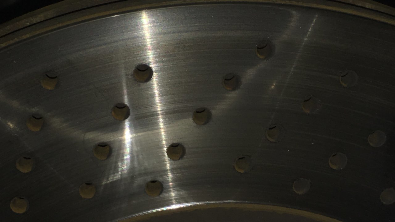

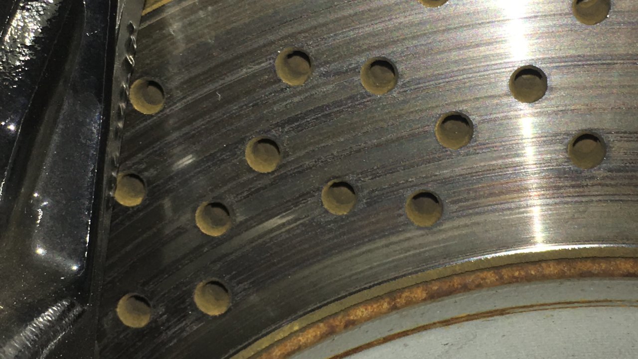

    No matter what? interesting statement.
    Here's pic's from my own car after 5 track sessions, 3 at Mid Ohio, 1 at the Glen, 1 at Putnam Park. 15 days, 3-4 sessions each day. using 2 sets of Hawk Pads.
    Anybody can tell you 2 of those tracks are probably some of the most demanding tracks to drive. Putnam has one of the longer straights that I drive into turn one which is a medium speed ,120 degree right hand turn that you better be at 60 mph from 130+.
    If you would have read the site postings that you got that pic from, that guy cooked that rotor which would cause that thermal fracture.
    Like I've said, if the brake system can't get rid of the heat, that is the result.
    Front Driver Side
    Front Driver Side
    Rear Driver Side
    No cracks, some pad residual on rear
    in my experience with Porsche rotors, never had an issue with cracks or failures. With my Gen 2 Tacoma, and PowerStop Drilled/Slotted rotors & EBC pads same experience no issues, no failures. I just traded it in last month w 175K miles. Stock Rotors were good for 30K.
