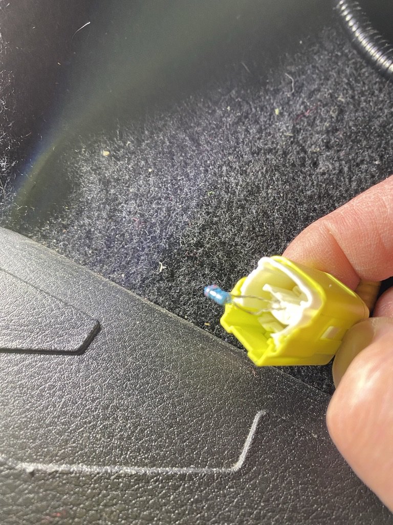

    So what's plan B if the 2 Ohm resistor doesn't work to turn off the airbag dash light? No luck with the resistor here, no idea where to turn next.

    Can you show a picture of how you hooked up the resistor? I failed in my first attempt. I read elsewhere that a 2-4 ohm resistor should work, so if you're certain you hooked it up correctly, then perhaps try other resistor values between 2 and 4.

    I tried using 2 - 2Ohm resistors, and still no luck.
    Weird, because it sounds like most people are able to get the light to turn off.

    how long have you had the seat out, did you turn the car on without it in there? sometimes it takes a bit for the ECU to reset the light. on my 2nd gen I cut and soldered to the wire then heat shrink over.
