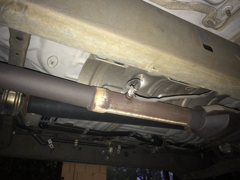

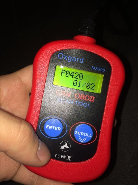

    My CEL light came on so I bought a scanner and got the P0420 code. Searched a ton of threads on here, figured out what the code meant, then took a look under the truck to visually inspect the sensors. It was after work, dark, and all I had was the light on my phone.
    What I found was the downstream sensor wiring harness completely mangled and almost torn all the way through (see picture attached).
    My question is, this sensor doesn't look like the Denso 234-4189 I need (no flange/bolt set up), so what are my options? It looks like the previous owner(s) had a shop weld a new piece of pipe in place of the old, and either screwed or welded a new sensor in (again, it was dark, and I didn't get a really good look so I'm not 100% sure). Looking at the harness, it looks like they secured the wiring and THEN screwed the sensor in, mangling and eventually compromising the harness--right?

    1st thing "I" would do is fix the wires if feasible and unhook the battery for 15 min to see if the code goes away.

    Omg, that undercarriage.... Drool.... Yeah that is definitely not the original sensor. They cut out the original sensor mount, the bung, and replaced with that deal. Bummer. You can have a shop redo it with a Toyota style bung and replace with a true oem Denso sensor. That'll be your best bet I imagine with the ECM throwing an MIL.

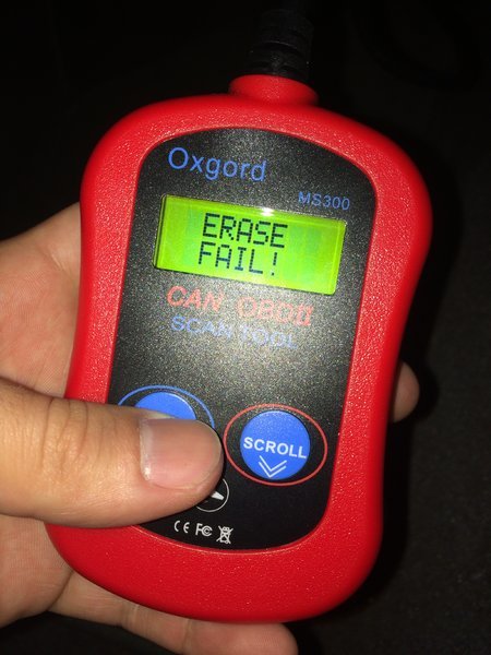

    I did try to clear the code on the reader before visually inspecting the sensor. It "failed" to clear the code (which lead me to look under the truck).

    The wires "may" be the culprit tho........

    If they are exposed and frayed, the best thing I would do is cut, solder and shrink wrap each. then wrap it all to hell with electrical tape.

    Took a quick look this morning and the wires didn't look frayed. I might just have to unplug and take it out to look closer.
    If the wires look OK, how would I go about finding a replacement sensor that fits this sensor mount? Would Denso have one, or am I stuck with something else?

    Disconnect it then Unscrew it if possible and take it to a parts store and see if they can match it. Usually they come with the wires, you may have to rig it to work.

    The wires looked OK. In the process of removing the sensor, I noticed the washer between the sensor and the bung had some play in it. I was able to resecure it, but not before pulling the sensor out to have a look.

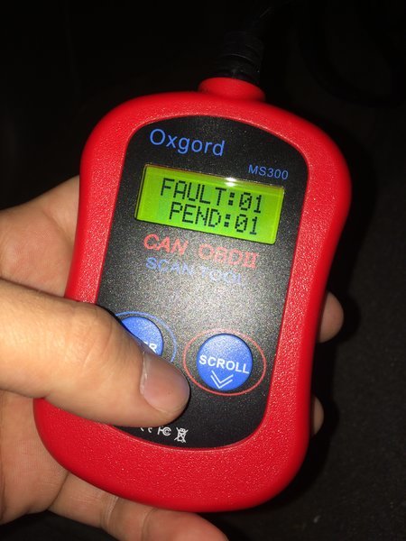

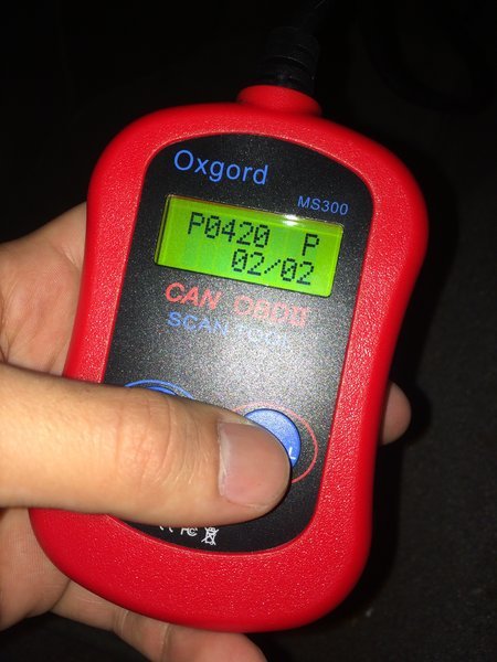

    Honestly, I'm not sure if it's bad. My scan tool still wasn't able to clear the code. And on top of that, it's giving me "P0420" and "P0420 P"
    I searched the second code but all I found was the normal P0420. I finally unplugged my battery, waited, and rehooked everything back up; sensor connector, sensor, and finally the battery.
    The code is gone. Anyone know wth p0420 p is? I took some photos and a vid of what the sensor looks like.

    P0420 is a cat code and its probably whats at fault, people have done those style sensor because its easier to remove. You can test the sensor with an ohm meter.

    P0420 is an emissions code. Can be a lot of things, such as bad rear o2, bad cat. Your Cat and o2 sensor are aftermarket. The factory cat bolts in, that is welded. These trucks are very sensitive emissions wise, and do not like aftermarket cats. Add an aftermarket o2 sensor into the mix, and that's probably why your CEL is on.

    P0420 is cat effiency below threshold, the ecm is seeing erratic voltage when its supposed to fairly steady voltage in the rear and erratic in the front. If its erratic in the rear the cat is not doing its job properly and the only way to fix that is replace the cat.

    Looks like a Bosch sensor. I had the same sensor up front, but oem sensor in back. So they must've changed the front at some point. I replaced the front with a Bosch As well as a denso rear and it's held up just fine so far no issues. This was after complete custom exhaust too with only 1 high flow cat vs original oem duals. I wouldn't stress replacing the whole thing to make it accept a denso tho. If it comes to that.
