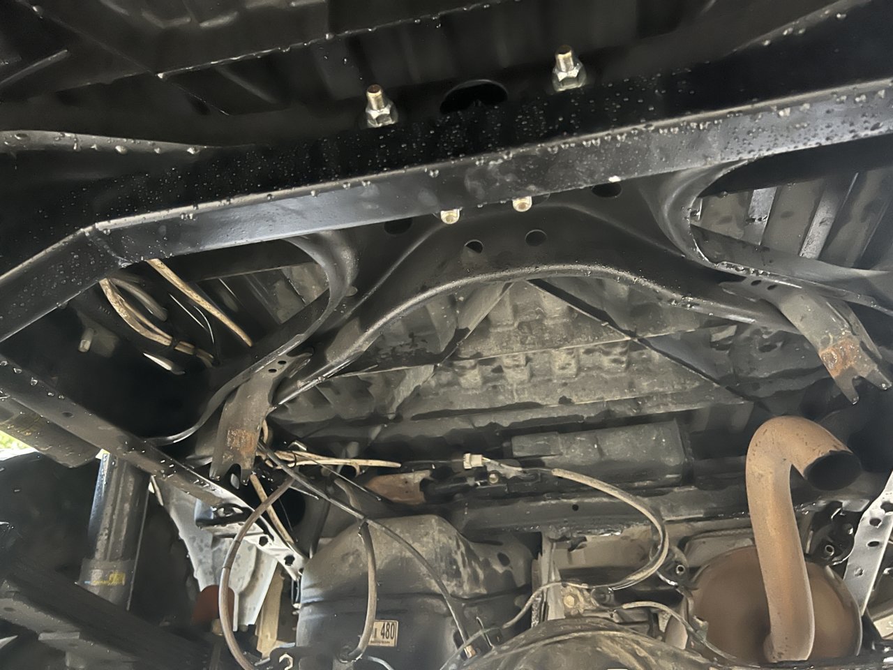

    So I’ve been working on this since 5am and I still have a side not finished. It’s been very frustrating and more than I wanted lol. I hope they improve alot bc I’ve been cussing myself for doing this. A lift would be huge. Just no room for an old man to really work and eye protection is a must. Will report back hopefully soon lol

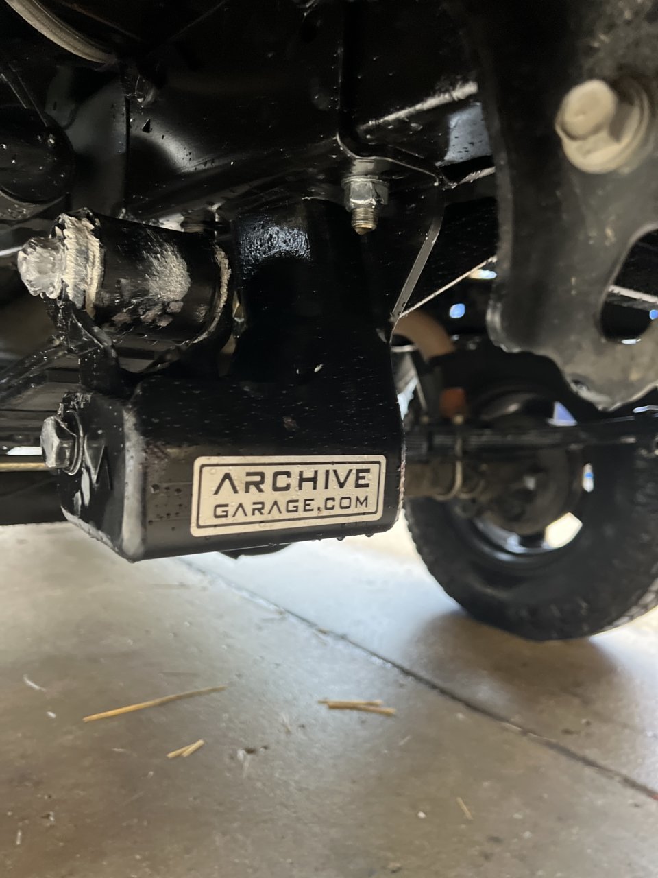

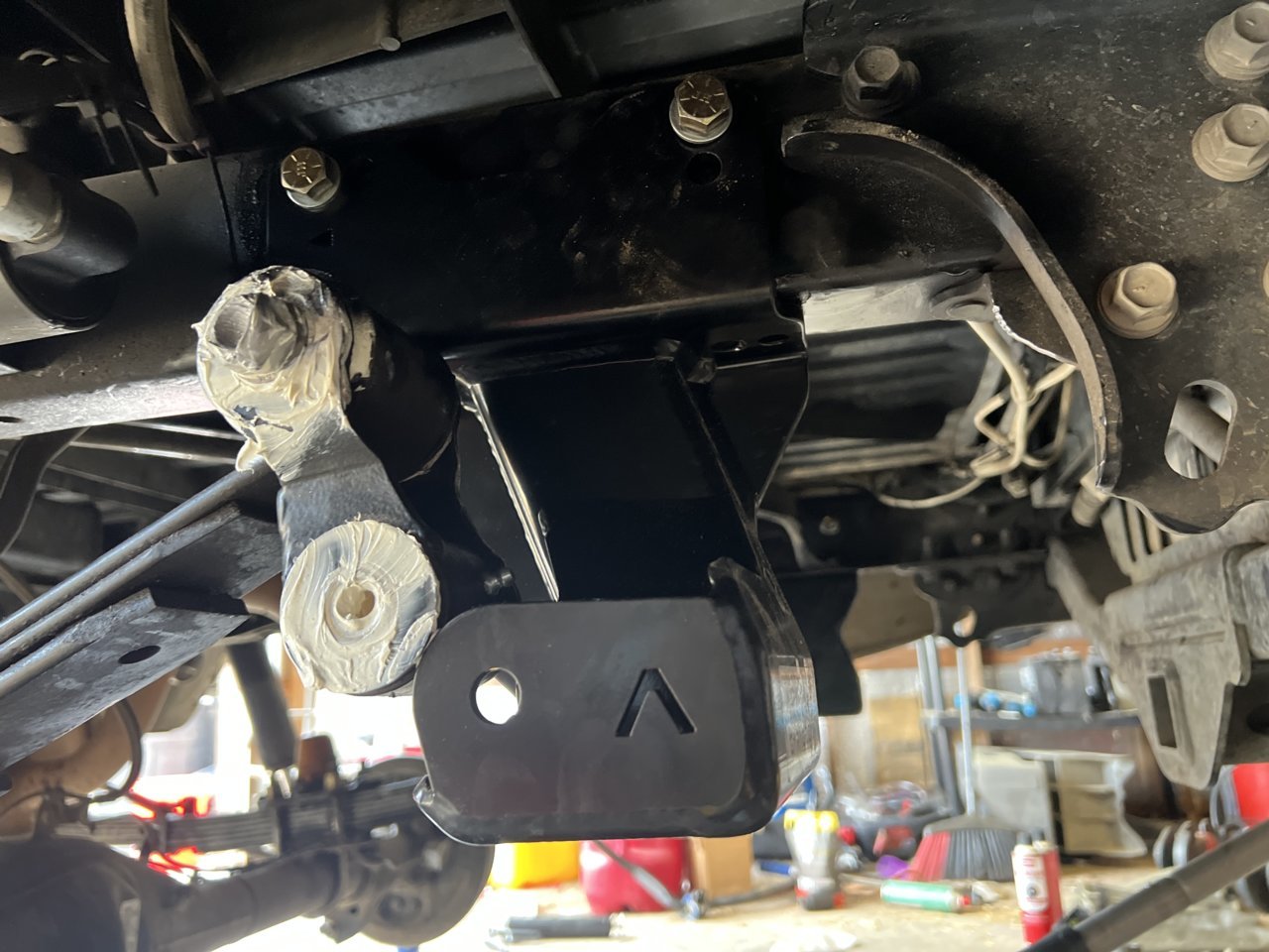

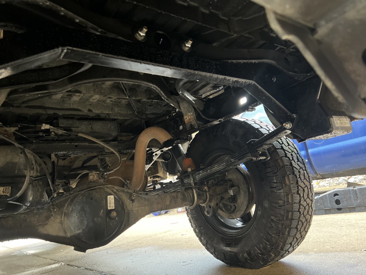

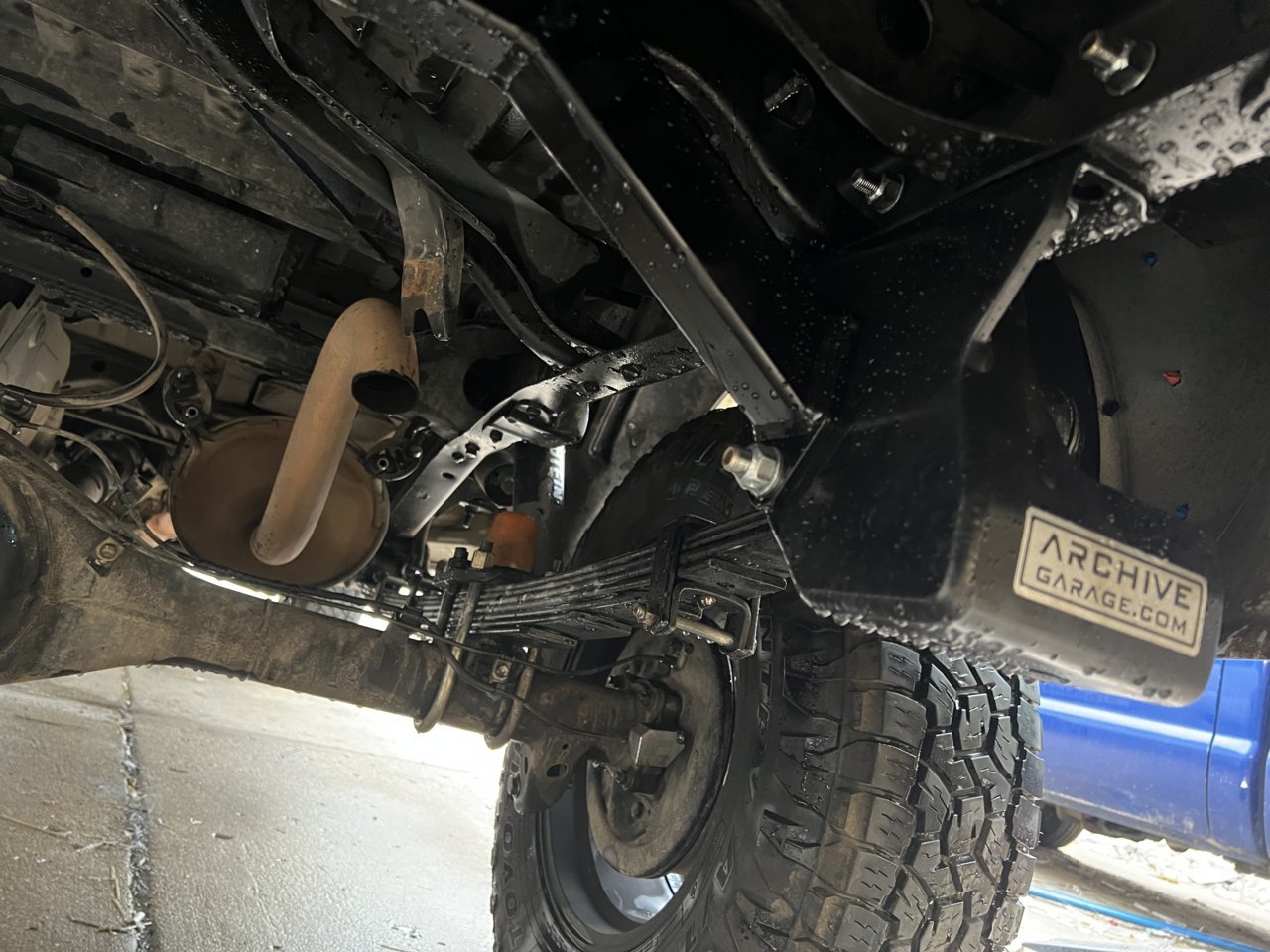

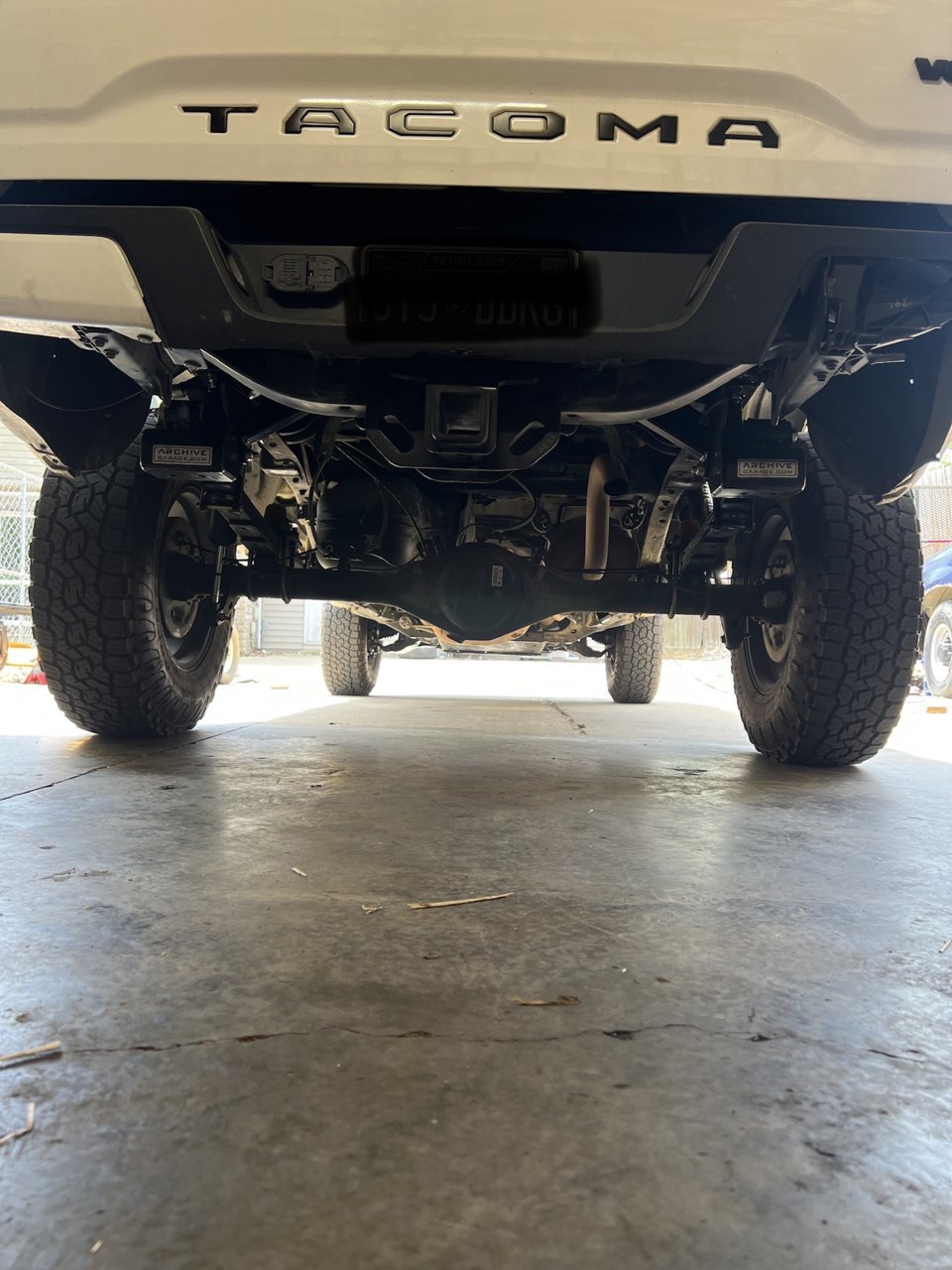

    70511077177__BBA4D591-41E7-4CB9-95F6-922B5E68C9C1.jpg 70509771234__1F31F19C-6CE3-4CA9-9AFF-D52E7425647E.jpg 70511080635__06B9148F-2C17-4959-B652-743DA07CA82E.jpg IMG_4019.jpg IMG_4017.jpg Well it literally took me all day and I wanted to turn around a few times during the day but I couldn’t. Definitely the most time consuming install I’ve ever done but I took my time and tried to be as neat and thorough as possible. Bottom rivets were a pain in the ass even with serveral drill bits and sanding pads for angle grinder. Even bought ball joint press and I don’t guess i used ot correctly bc only one came out whole and had to grind and cut the rest out. I’m 6”2 and 42 years old so being bent over grinding and drilling and trying to miss electrical and brake lines really wore me out! Anyway happy with the outcome but I wouldn’t install his again on my own without a hydraulic lift to use and stand. About to take it for a test drive and gather some thoughts!

    First impressions is that it oddly way softer in the back but more freaking stable… how the hell does that happen?

    The stiffness is the actual feel of you RXT'S. The hangers and crossbar stiffen the chassis so it doesn't flex. The chassis was flexing before with your leafs which made it ride a little more harsh....like a truck. Now that the chasse is now stiffened, you can actually feel the flex in your leafs

    Well I definitely like it! Seems like the rear 8100s and Rxts are now matching the ride of the front 8112s without sway bar.. I took the sway bar off Wednesday and I don’t think I’ll ever put it back on. It rides so much better and handles just a good imo

    Feels like the rear really plants and digs in with hammer hangers and crossbar

    I have Rago hangars. Slightly better in corners on the road, wheel travel might be a bit better, and it got rid of some gnarly axle hop in sand/snow.

    I needed an air hammer. My little craftsman has been a beast for me throughout the years and even getting cvs to release but it didn’t want any of this job. That’s where my time was mainly lost bc I was stubborn and kept trying it. I had plenty of good drill bits until I started getting frustrated with the time and i burned through them putting more force than needed rather than allowing drill to work. I’m happy I upgraded to the hangers but man I was pissed earlier today in the middle of the struggle I had to walk away a couple times so I didn’t make a mistake lol. Truck definitely seems to be much more planted and take bigger bumps and dips in the road easier. Exhausted I’ll report more tomorrow or early this week once I’ve had some time in it. Plus I’ve gotta get my mind right now to install this steering rack when it arrives

    Well you're right and wrong. A newcomer's hangers have the shackle pivot point way back, which with short springs like RXT or Dakars, even Deavers, results in an increased spring rate, making it feel stiff. Newbs
    Hammer Hangers are the only hangers with 2 positions: stock position and rearward so you can adjust to your setup. HH make the rear feel softer because HH are rigid and let the springs do their job.
    You really need to replace your hangers, stocks are trash, it's like bolting your leaf spring to another spring, which is why it is so twitchy.
    You can't fix the poor ride caused by stock hangers with even the best shocks, you have to improve the foundation of your suspension by replacing the stock hangers.
    Get the Hammer Hangers with 5.5 years of experience and improvements, you won't regret it
