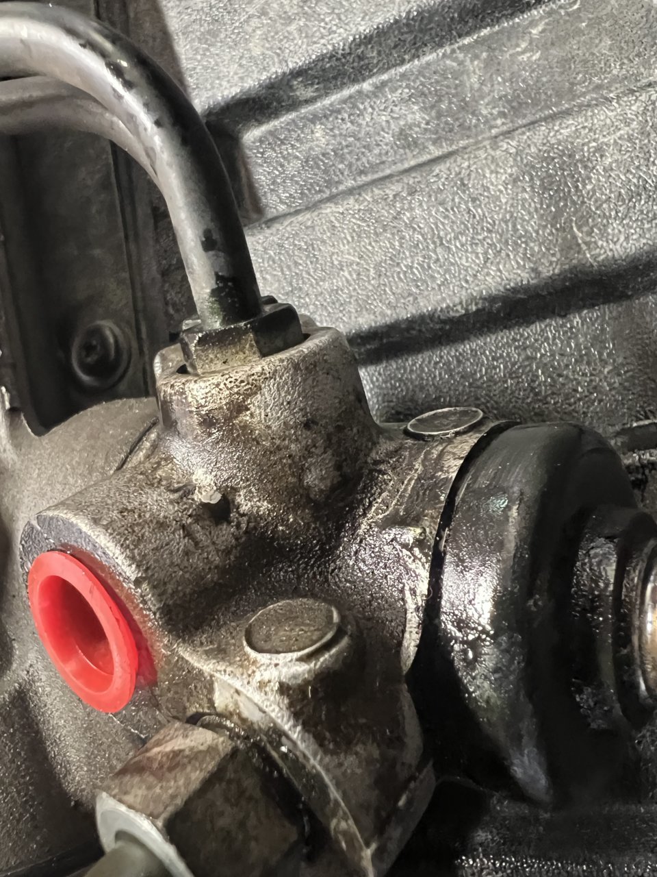

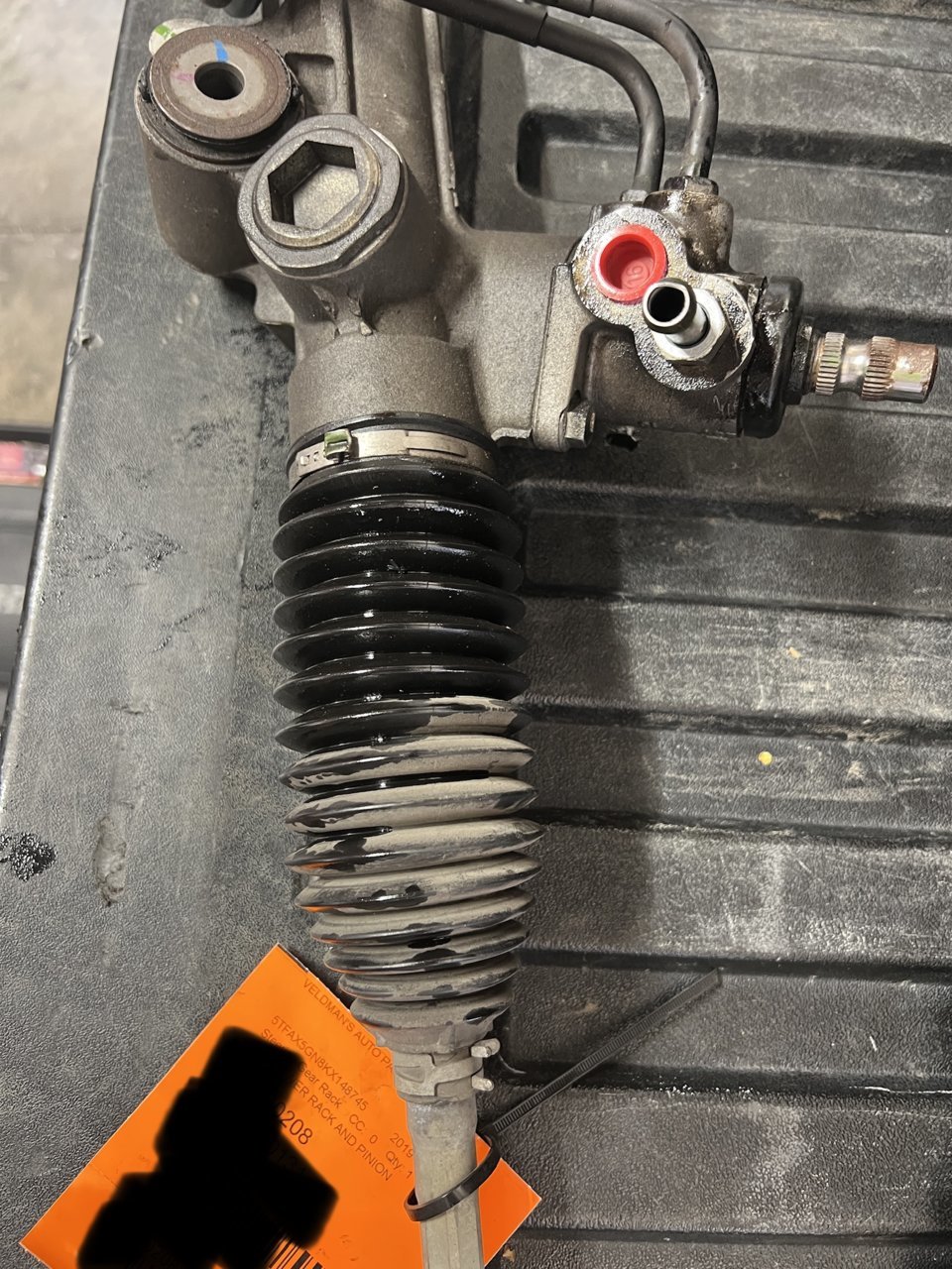

    IMG_4044.jpg Just amazing the noise hasn’t came back yet! Btw this is how the rack came delivered so I’ve set up a return on it already IMG_4046.jpg IMG_4045.jpg

    Yeah... that's definitely not a new rack. But if you decide to replace it later on, Tundra swap dat bish.

    No but to clarify I did know it was a salvaged rack from a 2019 Tacoma that supposedly only had 15k miles on it when totaled! If the videos on tundra racks didn’t make it look like such a pain in the ass I’d definitely go that route!
