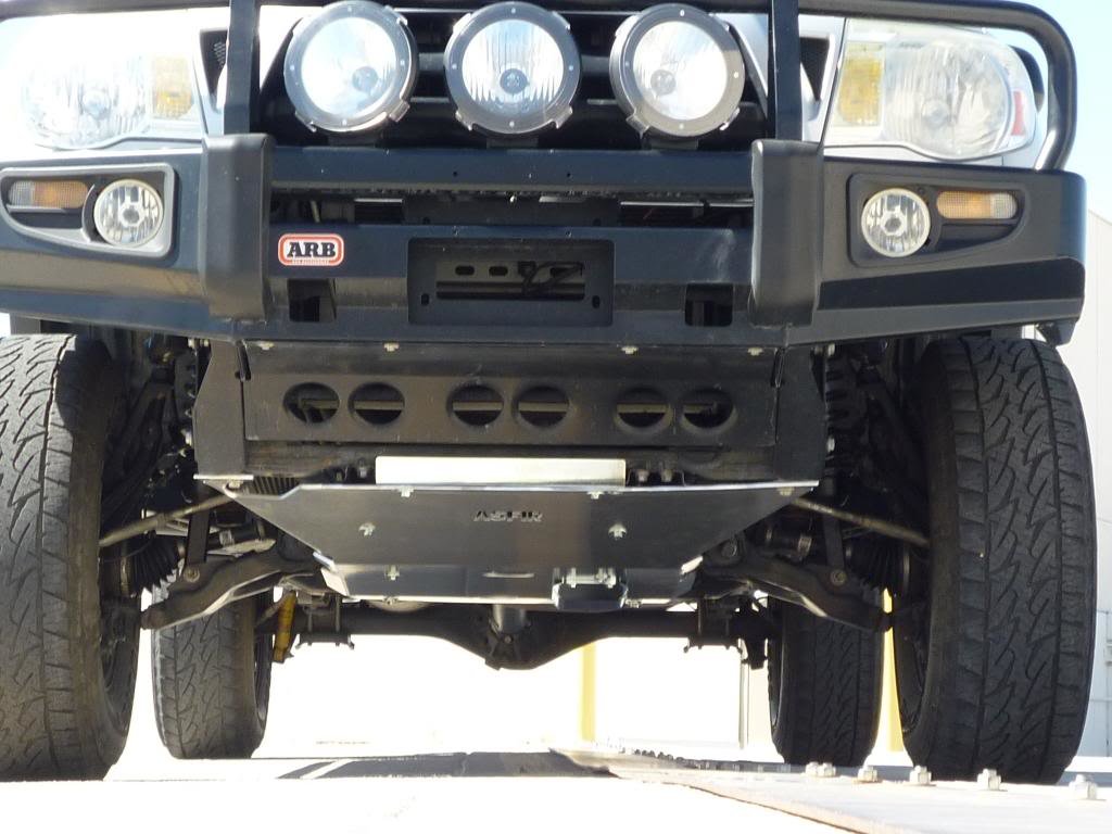

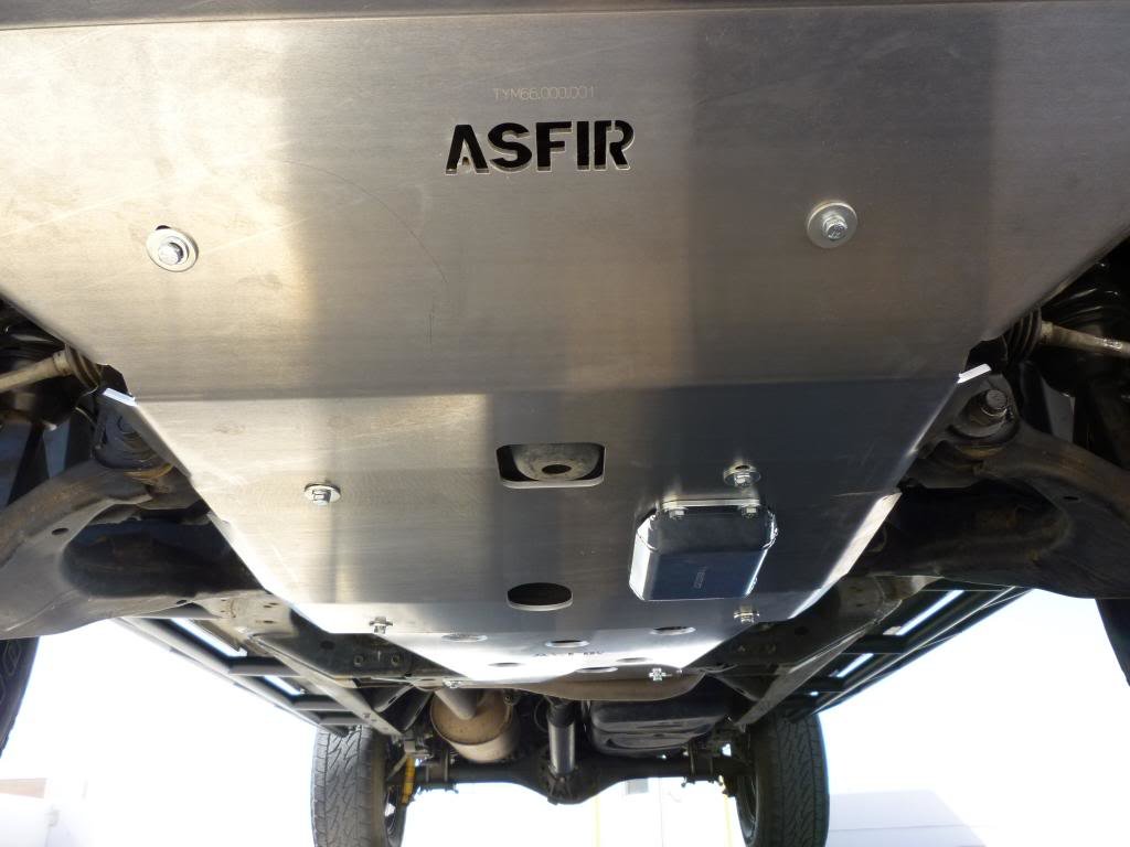

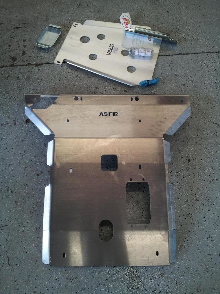

    Just added the IFS and transmission ASFIR skids to my truck. The major weight savings of aluminum, combined with not having to worry about painting and repainting steel skids, won out for me in the end.
    FYI there was some discussion on Expedition Portal (http://www.expeditionportal.com/forum/threads/57318-ASFIR-Skid-on-05-Tacoma) about the smaller plate that hangs down on the IFS skid. Sierra Expeditions told me that it's not actually for servicing the front diff, but that it allows the whole skid to be sucked up higher to the underside of the truck. The way it mounts with non-captured bolts indicates to me that it's not meant to be removed independently of the rest of the skid.
    I will definitely post more feedback once I've had had a chance to bang on these a little bit. My only concern at this point is the hardware, since the bolt heads aren't recessed at all. Depending on how the bolts holds up, I may change them all over to carriage bolts or something lower profile.

    the ASFIR skids scare the hell outta me, granted they are up a bit, but I dont mind a bit more hang down( 1/2"- 1") to have proper protection.

    As I understand it, one of the many advantages of aluminum skids is that you can take them off and just bang the dents out. No paint or coating , less weight, bolt right onto the frame are some of the other advantages of the ASFIR's. I think they are made in Israel.

    wow that ASFIR looks a little flimsy to me, and the exposed bolts definitely look like they'd get hung up/sheared off. At least that's my $.02 from those pics above

    I just changed my oil this weekend, and while I was at it, I checked out my ASFIR skids. I've gashed the rear one pretty good, but no structural damage or bends, and all of the bolt heads are still fine. The rear skid will have to come off next time I change my tranny and transfer case fluid, so I may try out some different hardware then.
