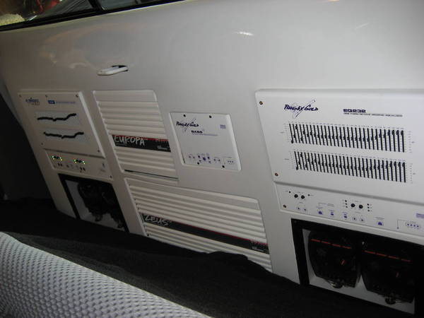

    Stock location had the original battery still with 0 gauge wire. Heres most of what i was running. In a DBC 2007 prerunner sr5 longbed

    afe Pro-Dry S dropin, Readylift leveling kit, TRD skid plate, Alpine CDA-9887, 6K D2S HID
    nice old school PG/Hi Fonics

    Goodyear Duratracs 265/70R17's, Bed mat & extra d-rings, Weathertech floor liners, Husky Liner for rear seat area, Biceman Illuminated 4x4 Switch, Pioneer 800 PRS, Hybrid Audio L6 and L1V2, JL 13TW5 in a Mr. Marv box, JL HD900/5
    Like others said, really unnecessary unless you play your system with your car off, or you just running some amps with ungodly high current draw, like say the old Phoenix Gold ZPA amps. As long as you make sure you ground your battery to chassis and amp to chassis with the same gauge wire as the power wire you use, you should be fine.
    That being said, you could do the big 3 upgrade. There's a million debates and opinions on whether this does anything however. But when I installed my system, I had some nifty battery clamps, a bunch of 1/0g wire, and some fancy PG compression terminals just sitting in a drawer, so I did this to mine. Batt (-) to chassis, Batt (-) directly to alternator housing (basically engine block), and Batt (+) to alternator.
    Was it necessary to do this? Prob not, and prob def not in 1/0 g. But I had the stuff, so why not. Did it help the stereo? Again, probably not. I'm running the same JL HD 900/5 amp Italyn Stylion is, which doesn't have much current draw and has get to get hot even under my seat.
    BUT my truck does seem to run better now. Seems much smoother, if that makes any sense at all. I thought it might be just me, but my buddy also noticed it when he rode in it. So that makes it worth it to me at any rate.

    Thats because that Hifonics Europa amp is rated at 30 watts per channel, 4 channel, and the zuess is 600 watts rms into 2 ohms. Thats a total of 720 watts. You aren't pulling enough current to really tax your electrical system. Actually, the batteries and caps are probably overkill for your system. You will have problems if your current draw does increase by almost double with any regularity and starts to drain from all those batteries.
    Nice looking install none the less. :D
    I don't have the book next to me, but I am positive it says in on of the two MECP study guides that the power draw of the audio system and the rest of the electronics in a vehicle can be 120% of the alternators rated output, as its unlikely anyone ever will use full power and use all of what the alternator can provide anyway. So while the system is capable of pulling that much, under normal use it wont, therefore it doesn't actually exceed the alternators capability.
