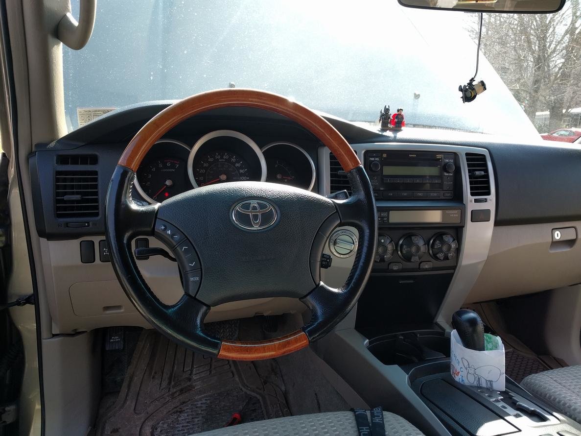

    Easiest thing to do would be to get Camry or Lexus steering wheel with wood and install with little to no changes being made.

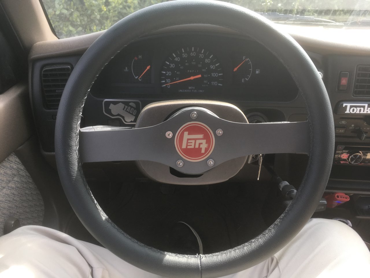

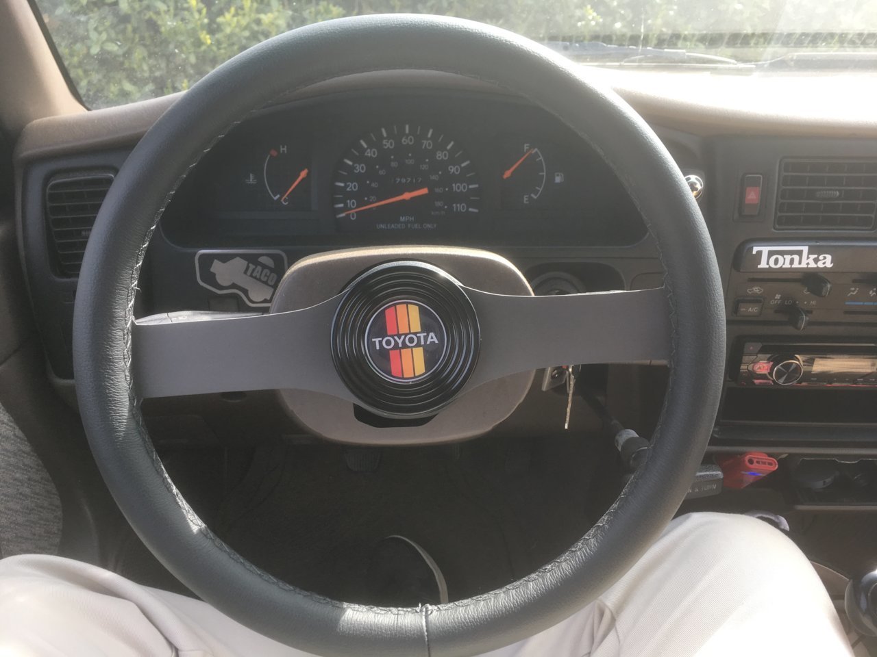

    If losing the airbag (I pulled my 95, but would have left a later 97-on- the first generation of airbags had ... issues ..., but the second-changed went went to dual airbags-> lower powered & much safer) ...
    Find a wheel you like.
    Get an adapter kit that suits your wheel type, using 91-94 models for the spline size.
    There are 3 hole bolt patterns in the typical wheels, plus 9, 11, & more bolts, each with their own hubs.
    1 is 5 lug & most commonly Grant or APC.
    2 Are 6 hole- one with holes at the top & bottom center & the other centered left & right (Momo, Nardi, Sparco etc)
    This is install (highly simplified):
    Take dash apart
    Remove the airbag
    Remove the clockspring & wiring (connectors)
    Install adapter, spacer, & wheel
    Figure out how to run a horn
    Put dash back together
    I’m running a customized 2-spoke Grant 16” wheel:
    Wulf, chrslefty and Steves104x4 like this.

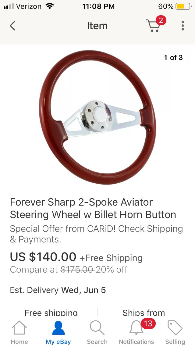

    So, interested in an airbagged wheel?
    For non-bagged-
    There is a 6-hole one on Ebay that would look good, similar to stock size too:
    15” diameter-
