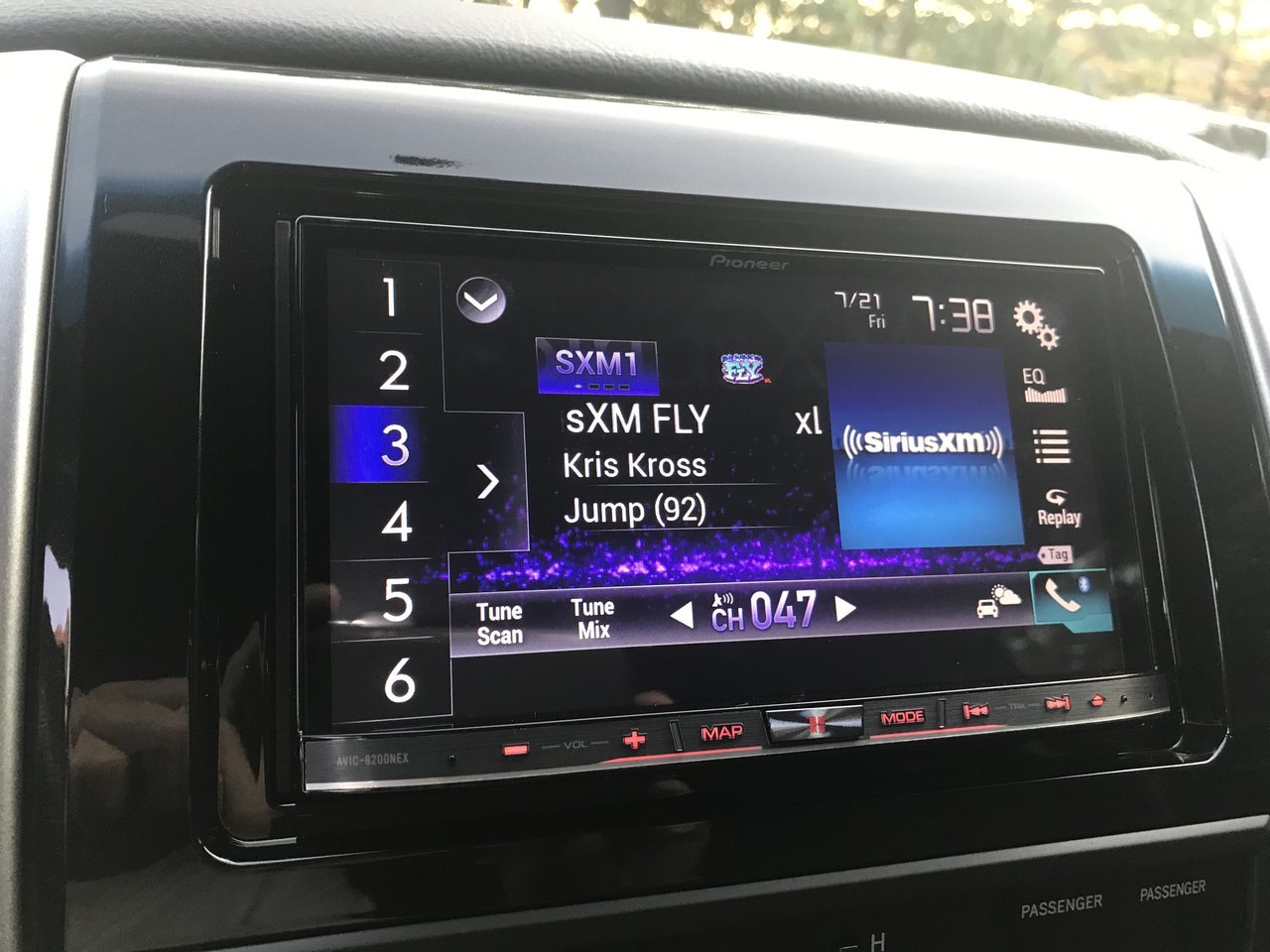

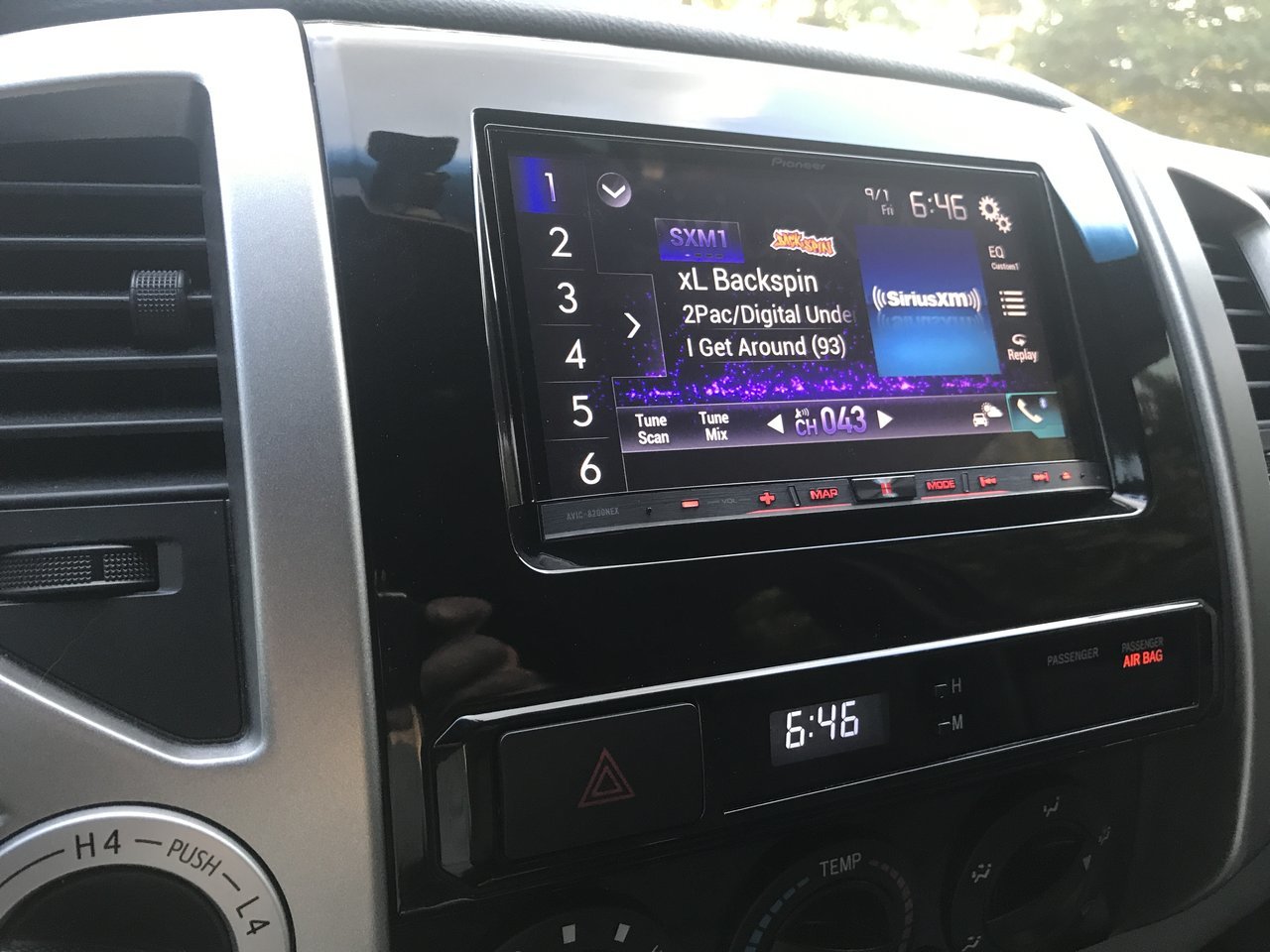

    Yes. No cutting/splicing of any factory wiring. The head unit actually calls for a splice into the speed sensor, and E-brake wires. I did neither, and the unit works with no issues.
    The E-brake is for the DVD enable (which I never use anyway), but there is a software bypass for it anyway. The speed sensor wire is for the Nav. It came up with a warning on initial start up, saying it didn't see the speed sensor, but that hasn't come up since, and all of my functionality works. When I was looking up info for install, I remember a guy saying the unit uses the speed sensor for the times when it loses sat reception, so it can still calculate arrival times.
    On a side note, if you go with this setup, I mounted my Nav antenna on top of the head unit (beneath the dash), and have had no reception issues.
