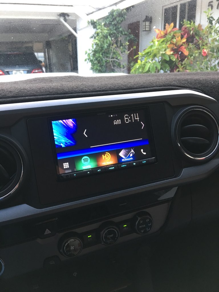

    I put a Pioneer 8200NEX in my base model SR!
    https://www.tacomaworld.com/threads...-build-bs-thread.427983/page-14#post-14080101

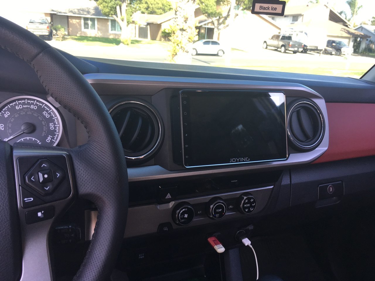

    I installed an Android Headunit. Ill do a write up soon if anyone is interested.

    I have been going back and forth on installing an android HU. But haven't never seen anyone who installed one on a 3rd gen. I have heard mixed reviews from people who have installed on 2nd gens. How is this working for you? What are you likes/dislikes? How was the install? Thanks for the pics.
