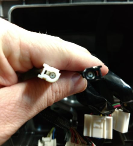

    Replacing the factory stereo with a Pioneer AVH-2440NEX and I purchased a Sirius XM tuner. The tuner came with its own antenna, but I would like to use the existing one on the truck since it is already present on top of truck. Anyone know if there is an adapter to jumper the vehicle side connector to the sirius/xm tuner? Thinking I may have to solder......Also, does anyone happen to know which is the satellite antenna, black or white?

    Did u have sat in factory?? The end of the wire from the sharkfin is in the driver kick panel. Need an adaptor like this.
    http://www.tss-radio.com/products/lexus-gs-shark-fin-antenna-adapter
    Not sure which one is coming from the fin on your roof. Mine didn't have sat on OEM deck. Replaced with Kenwood, ran said cable to it from kick panel, and I was in business.
