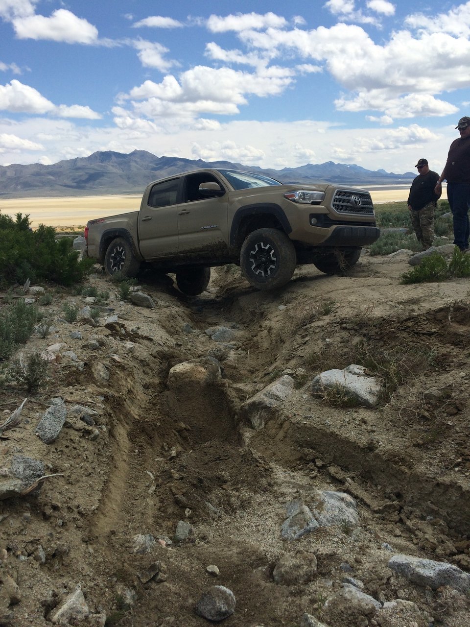

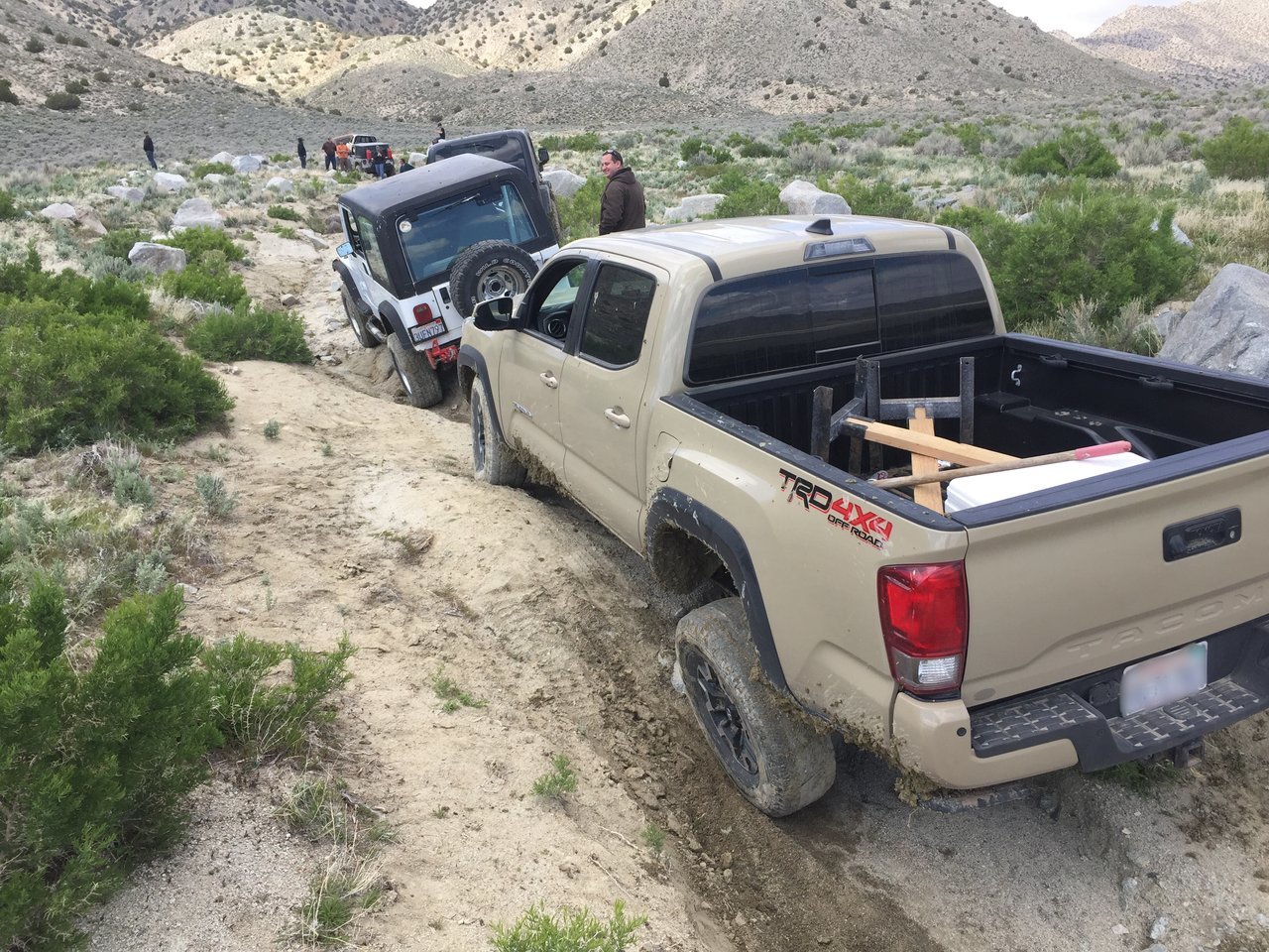

    I’m set on putting those parts on.
    Haha no malls where I’m at.
    No I currently have LT265/75/R16 duratracs on the stick off road rims.
    Ok cool I’ll have to look into getting the needle bearing.

    Where you located Tony? Get some new tires, those look like racing slicks out there :)
