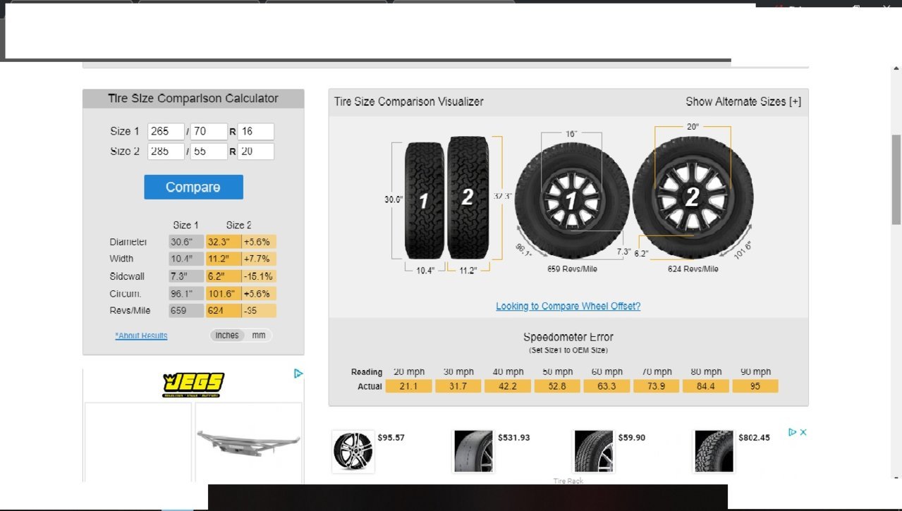

    not a tire expert but i would say 285/55/20 wouldnt be doable... why 20"? im assuming that you arent going offroad with this? the 285's compared to your stock 265's are essentially 2 inches taller and 1 inch wider. you are going from a 30.6 inch tire to a 32.3 inch tire.

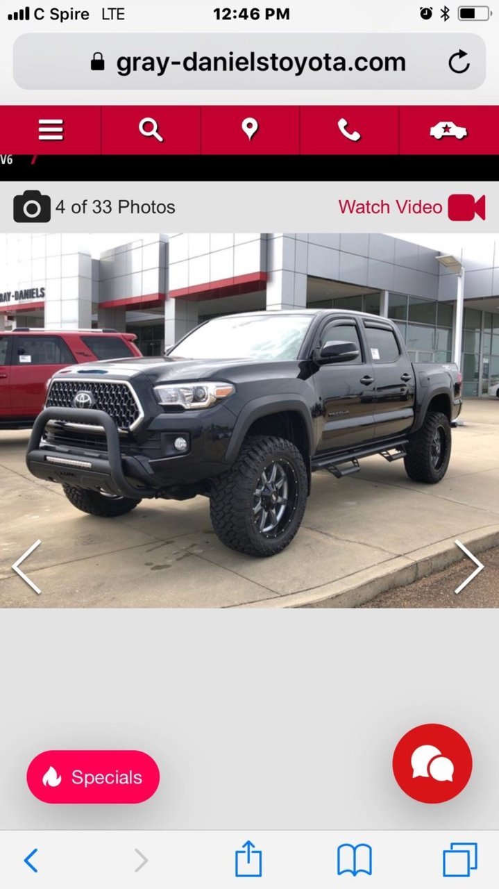

    I like the look. They had one with everything I wanted at the dealership and it was listed on their website for $38,000. When I got there, they wanted $50,000 because of the upgrades. Couldn't pull the trigger on that price. I will not be doing much off roading. Here is a pic of the 2018 on 20's

    Pretty sure that truck has a lift on it also. And if you like 20" wheels, go for it, it's your truck. I wouldn't go offroad with 20" wheels though, you'll damage them too easily.

    That truck has a lift of some sort.
