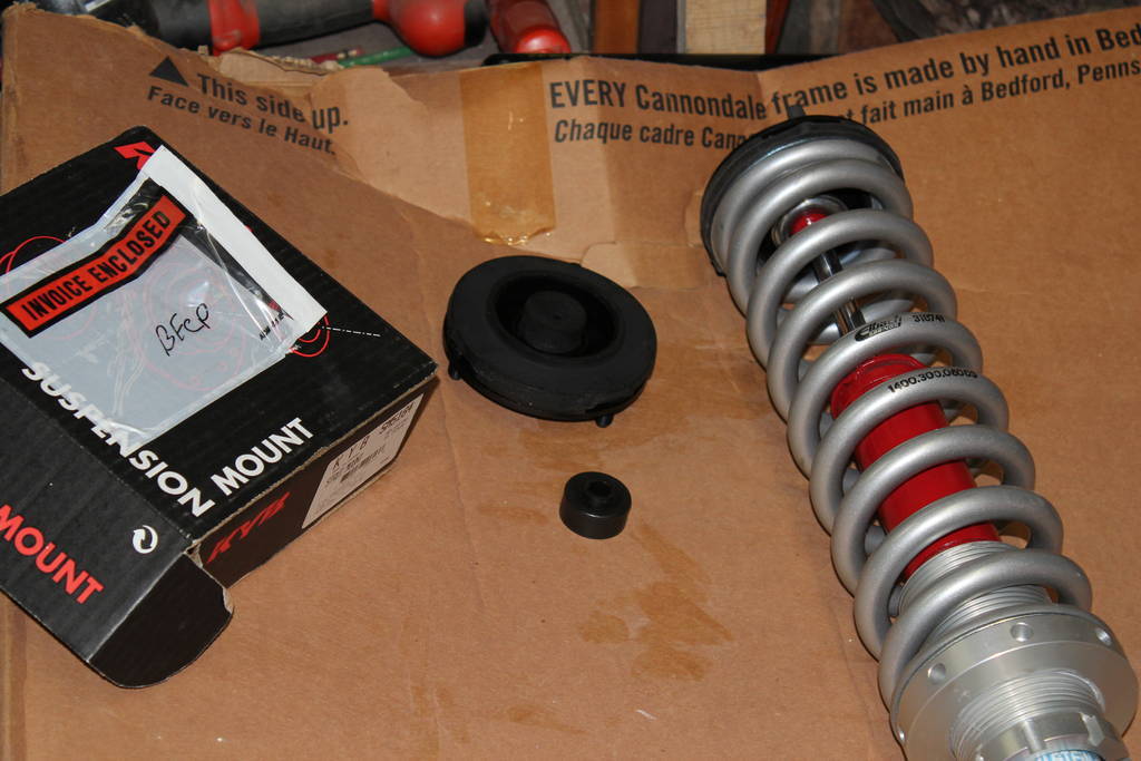

    I picked up a pair of KYB mounts last year for my 1st gen. about $47 each which included all the rubber parts.
