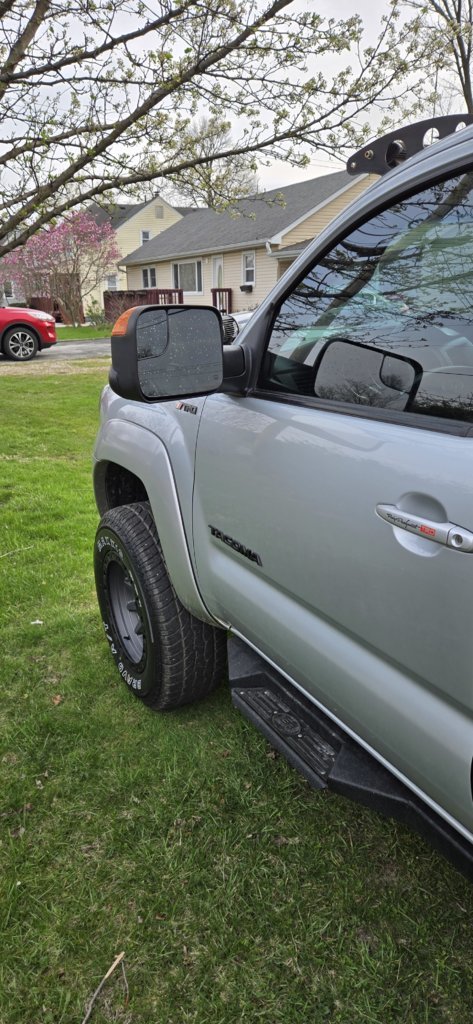

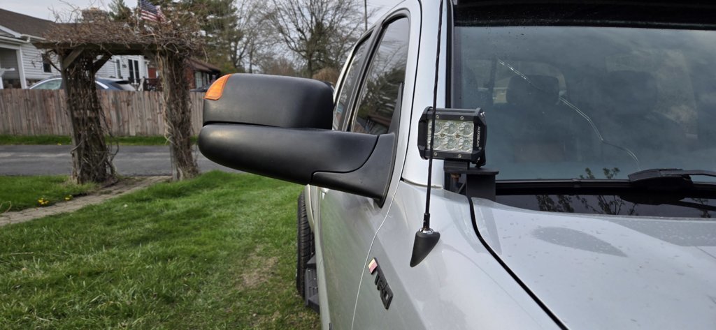

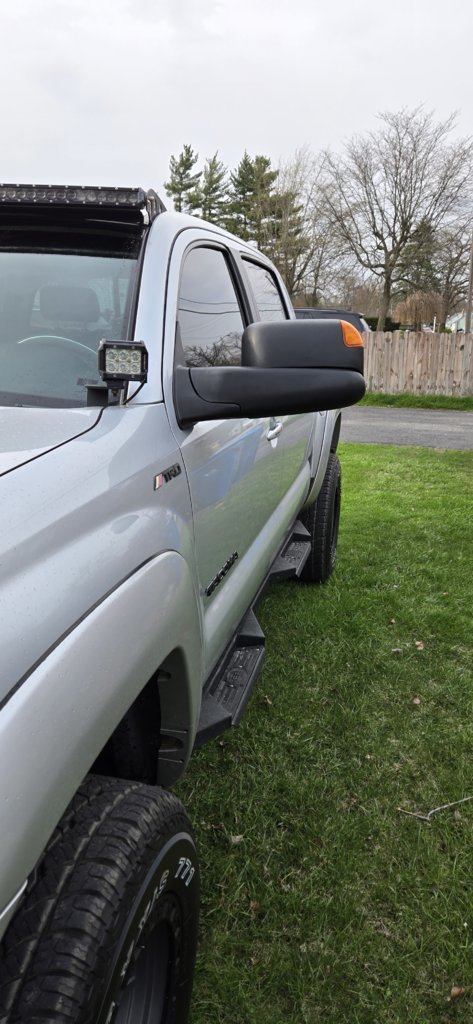

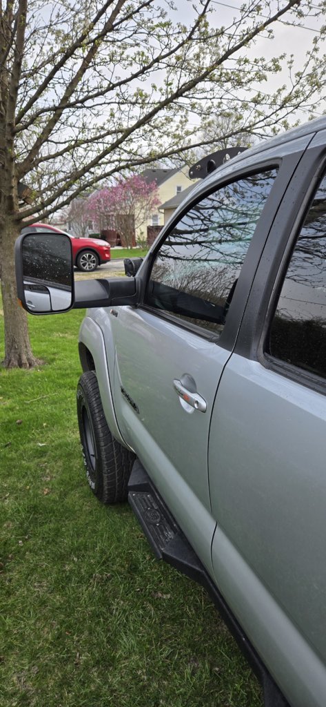

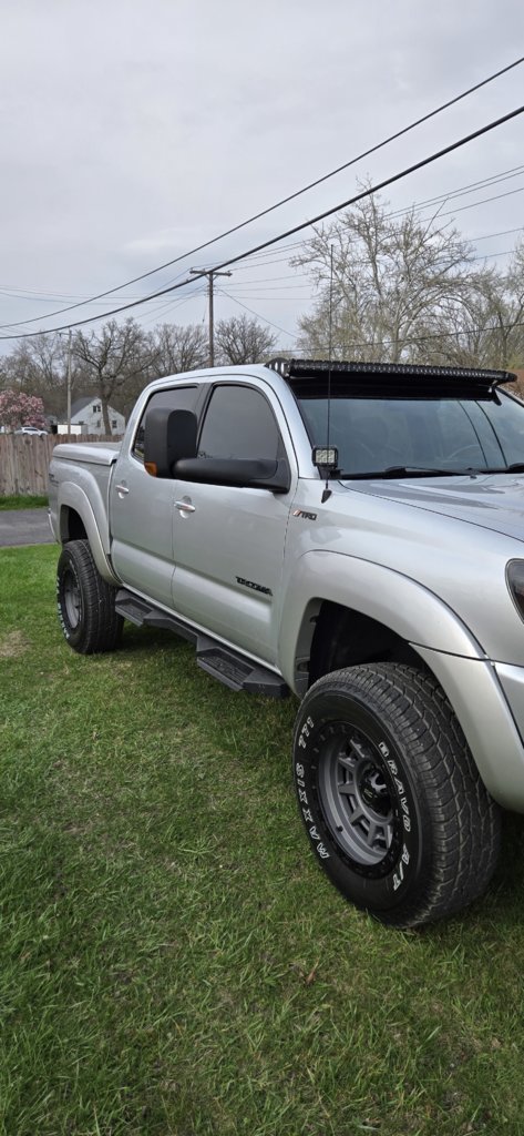

    I just put these mirrors on for towing my camper. I definitely like the fact that they flip out for towing then tuck back in when not needed. The original mirrors were only power adjustable, the new ones are heated and they have integrated turn signal. It was plug and play for the power mirror. I'm assuming the two seperate wires are for the heated part of the mirror and for the turn signals. I believe it pulls the common from the main plug harness. My question is has anyone else installed something similar and if so where did they tap their power from?

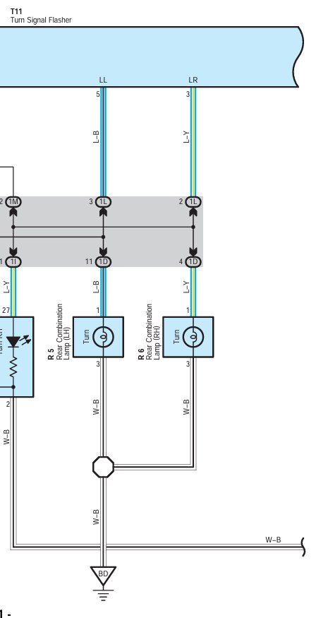

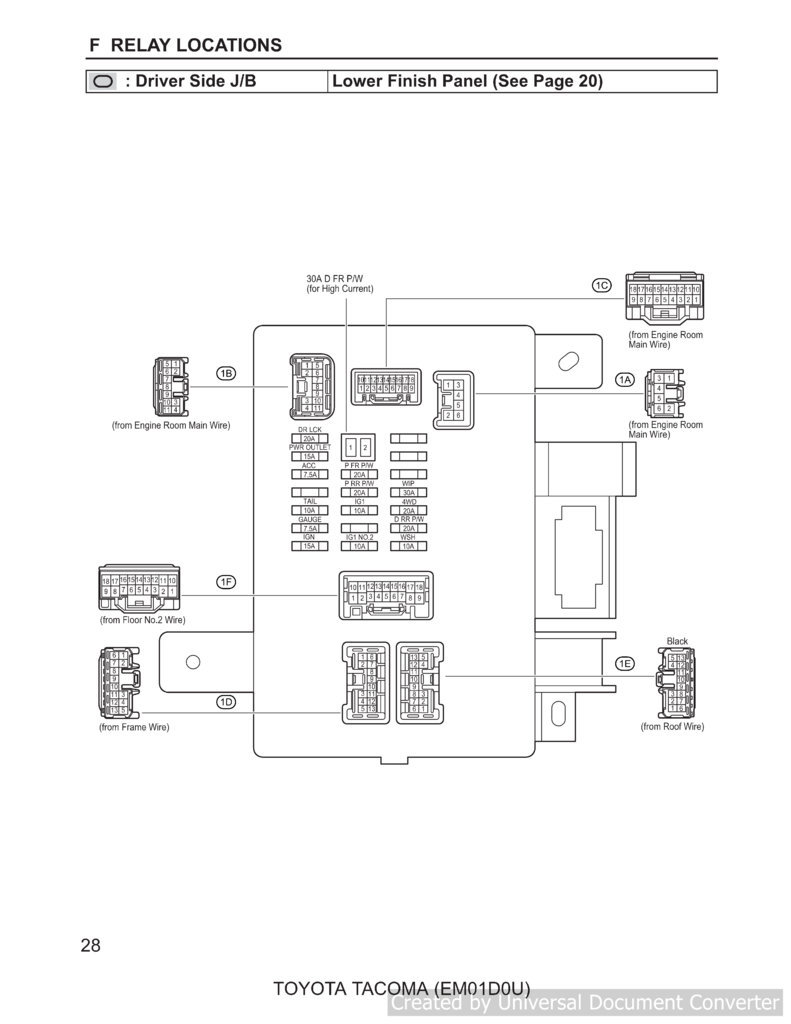

    There isn't any wiring in the doors for the turn signals on 07, the side mirror turn signal option wasn't available until 2012.
    Connector 1D Pin 4 (Blue/Yellow) (Right) and Pin 11 (Blue/Black) (Left) on the Drivers Side Junction Box probably the best spot to grab the turn signals.
    You would need to run your own switch and power for the heaters as that was never an option on 2nd gens.

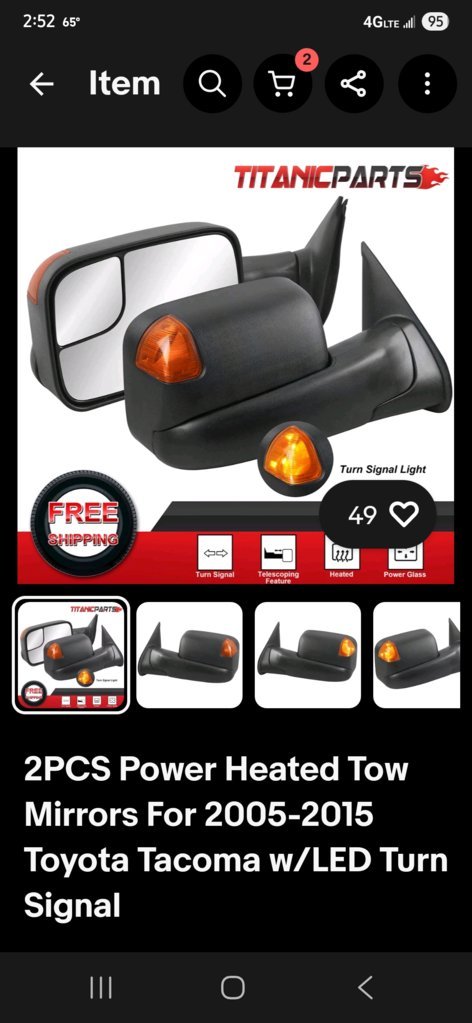

    Not sure if the brand I got these from eBay

    When I click the link it shows these won't fit the Tacoma???
    But then again it's going directly to what will fit my 2007 Tacoma.
