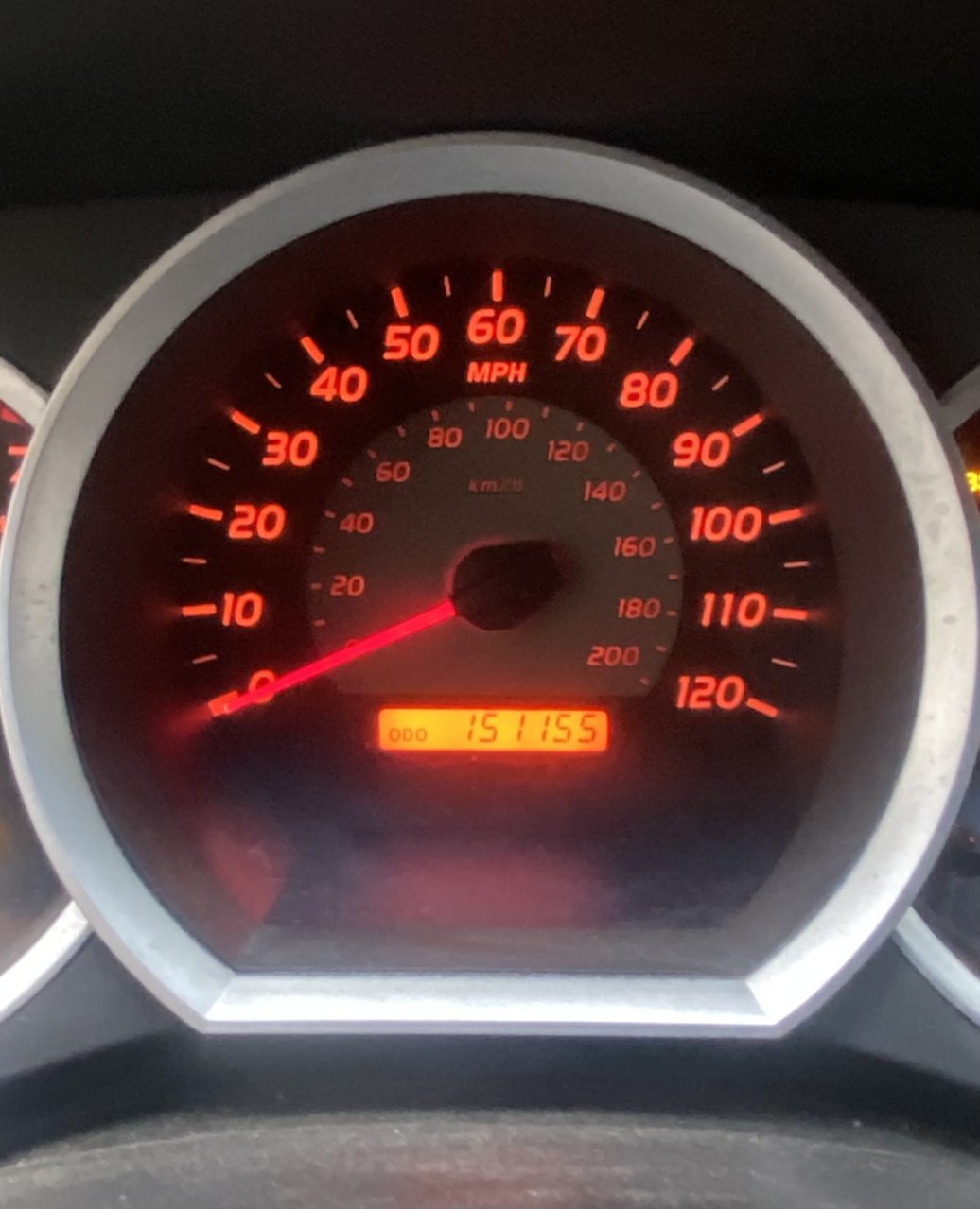

    This is just a quick post to review an aftermarket TPMS solution for anyone looking to get rid of the light on their dash without breaking the bank.
    I had the TPMS light on for 5 years in my 06 and decided I wanted it to go away when replacing my tires this year. Reading through threads on here there was a ton of different stories of “this sensor works” or this one didn’t” or “this one required too much hassle.”
    So here is a simple no nonsense solution for the masses.
    I bought through https://www.tpmsdirect.com/
    I used the drop down menus and searched for my year/make/model/type of wheel (steel vs alloy).
    Purchase price for 5 sensors (the 06 has one in the spare) was $99 before taxes and shipping.
    These come pre programmed for the vehicle so the shop just had to install and relearn the sensors (entering the number on the TPMS sensor into the computer at the shop a simple process, but you have to have the expensive computer).
    Now I have no light on and a functioning TPMS system.
    So if you’re looking for no nonsense TPMS sensors these ones will work.
